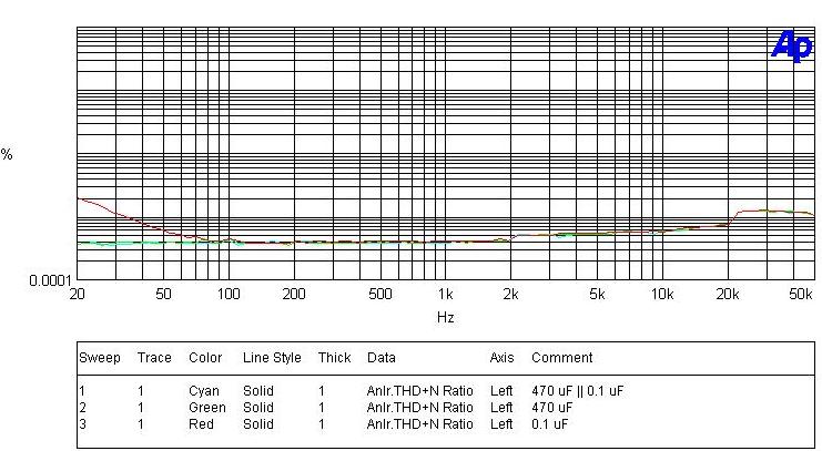

C4 of which schematic/amp?
C4 is a bypass across the electrolytic.
At medium to high frequencies the plastic film cap will have similar or lower impedance than the electrolytic. The plastic film passes a substantial part of the fedback HF & upper frequency audio signal. This means the film cap has the opportunity to shine by letting us hear it's undistorted output from the amp.
The electrolytic takes over for lower mid, bass and sub-bass signals.

Perfect, as the 0.1uF is a Vishay MKT 1822 400V and the E-Cap is a Nichicon YXA 63V 100uF
THD of caps
Here is a plot for comparing THD of a 470 uF e-cap with and without a 0.1 film cap in parallel. The THD of the film alone is also shown. The curves associated with the 470 uF e-cap do represent the residual distortion of my AP. It meas that no additional distortion can be measured for the e-cap.
Well, do we really need to parallel a film cap with the e-cap in NFB path. Yes, we can since it does nothing wrong objectively. It may make subjective differences. I don't know for sure. However, it does make some people feeling better who believe e-cap must be bypass by a film cap for better high-freq characteristic. This is true in certain applications, but not universal. Simply copy and paste does not engineering.
Even though picture quality is poor, there is a slight difference.
the film doesnt seem to handle lower frequencies too well, yet the electrolitic does a good job at "dampening" that. These 2 caps seem to compliment each other, where one makes up for the shortcoming of the other one.

The e-cap alone and in parallel with a film do not show any measurement difference. From the measured result, I can't see a reason to add a film cap.

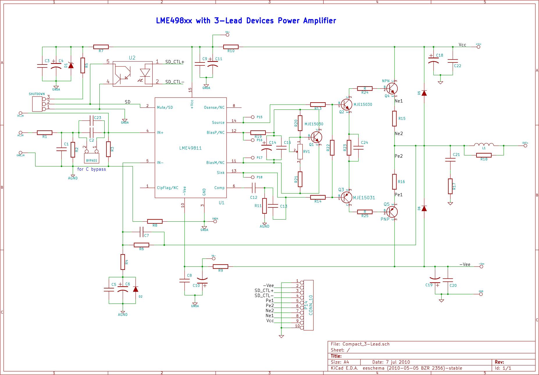

New board layout
I am working on a new layout for 3-lead power devices. KiCad is employed for the new board. Here is the schematic. Compared to the previous version, the following items are added.
Any comment is welcome.
- input DC blocking film cap
- 7.5 mm and 10 mm film cap footprints
- multiple footprints for NFB e-cap supporting ELAN SILMIC II
- 3.5 mm and 5 mm footprints for decoupling e-caps
- output coil and Zobel network
- separate rails for LME
