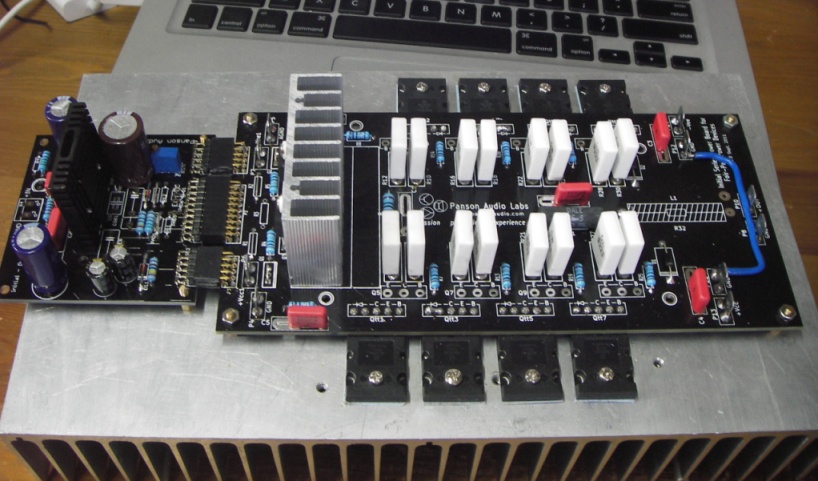

I will most likely do the followings.
I have not decided for one or two pair output devices. The Compact board is aimed for output <= 60 W into 8 Ohms. This is expected for delivering large current into heavy loads.
- Output coil and Zobel network
- Vbe multiplier with TT diodes
- Accommodate 3-lead TO-264 and TT power devices
- Driver shares the main heat sink
I would suggest that a one pair output stage for 60W into 8ohms is not a high current style amplifier.........I have not decided for one or two pair output devices. The Compact board is aimed for output <= 60 W into 8 Ohms. This is expected for delivering large current into heavy loads.
A two pair would qualify as high current.
The builders choose which they require.

Is there a disadvantage of using 2 pairs?
I am still using the compactamp I built in early 2010 and am quite happy with it. If a board would be designed by Panson I would happily be a "beta tester" for the new PCB's
Thank you for willing to be a beta tester. There is technical disadvantage for 2 pairs. For a low power design, two pairs may not be necessary.

Hi Harry,
The driver is definitely needed for 49811 even in this Compact board. I prefer the LME regulator on another board.
Panson

Hi Harry,
I prefer ThermalTrak since it is more flexible for bias arrangement. STD got the diode connected to its base terminal which limits the flexibility.
For 49810/30, if driver is not wanted, we can simply short the corresponding B-E pads and not populate the driver emitter resistor.
To my experience with the LME498xx so far, I don't see any obstacle to get decent performance with external driver.

Keep us informed!This is my "Hi-End" LME. The power board (Triple, four pairs power devices) is a new layout. I will post its performance data.
Thank you guys.
I post the result of my "Hi-End" LME in http://www.diyaudio.com/forums/chip-amps/199132-my-hi-end-current-lme498xx-amplifier.html
