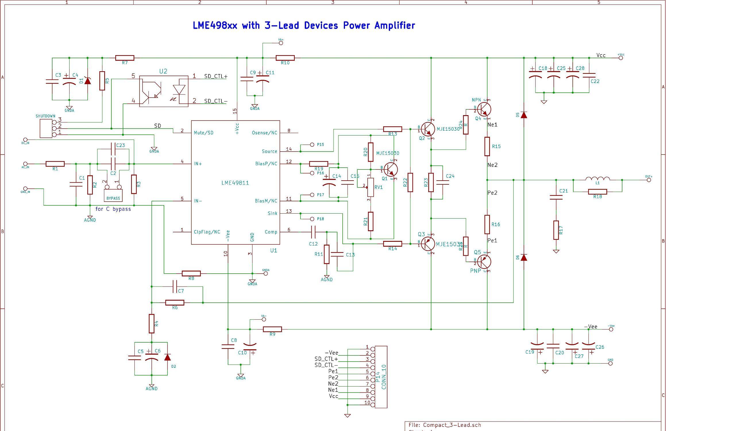

At the moment I'm planning my first amp and so I have a few questions:
* Why is C13 connected to sink? Nationals AN-1850 shows the compensation cap connected to BiasM.
* I'm planning to use a LME49811 with a double pair of Toshiba 2SA1943/2SC5200 (mostly because they are cheaply available at digikey) and and your MJE1530/1531 pre driver configuration. My intended output-power is 80W/8R0 does this configuration perform well or would you suggest different components?
* Would you like to share the component values of your circuit? Otherwise I'd take the values from AN-1850 and try to calculate the rest on my own. I do have the basics for this, but for sure I'm not the best at this calculations.
* one maybe totally newbie question: what are D6/D7 and L1 for?
thanks for reply,
oliver

Hi Oliver,
You found a schematic typo. C13 should be connected to BiasM for 49810/49830. I am going to correct this low-tech error. Thank you!
D5/D6 are so-called catching diodes to protect output BJTs in the present of back EMF from the speaker load. They will conduce when that happens.
L1, output coil is used to avoid stability issue in the present of capacitive load.
Two-pair 2SA1943/2SC5200 is very sufficient for 80W into 8 Ohms. These output devices are used in Hi-End equipment like the Luxman M-800A. Good choice! I have some test shown here http://www.diyaudio.com/forums/solid-state/170618-comparing-power-bjts-sanken-semi.html
Please visit my web site and go to Compact 498xx page. You can find a component list there.

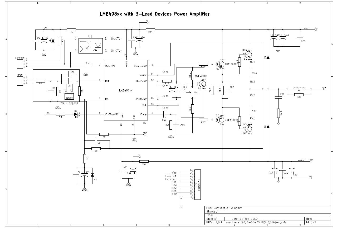

Need your inputs for a new board
I am looking for suggestions for designing a new Compact 498xx ThermalTrak board. The followings are being considered.
DC servo
Two-pair output device
Output coil and Zobel network

DC servo - not needed
Two-pairs output - YES
Output coil and Zobel network - YES
CFP output - NO, better TRIPLE(for LME49810 drivers and output, for LME49811 predrivers, drivers and output
Better Vbe multiplier, not just ThermalTrak diodes
output BJTs mounted on an alu L bracket on one side, ease to fix to heathsink

Hi panson,
nice to read you again,
during the last weeks I often visited your HP - there I could read your announcement .....amp comming soon...
I'm very interested in properly designed LME pcb's.
Here in the forum I read a lot about LME-amp design.
If you need not more than about 100W/8Ohm, then I prefer a circuit like audioman55 described in our forum:
>>LME49811(class A output) with one pair Sanken STD03N/P
For more power have a look on the circuit from the member opc named "The Wire Amp"
>>LME49830 with single pair of lateral mosfet's ACD101NDD/ACD103PDD (identical with ALF16P20W/ALF16N20W)
This circuit will give you more than 200W/8Ohm.
......two pair output not needed
......output coil and Zobel ok
......DC-servo would be nice,but not needed
......very importand is to have an extra power supply for LME with regulation on board - use a tracking preregulator design with LM317/337,it is cheap,simple and works fine.
......nested feedback loops not needed - keep it simple
regards Harry
