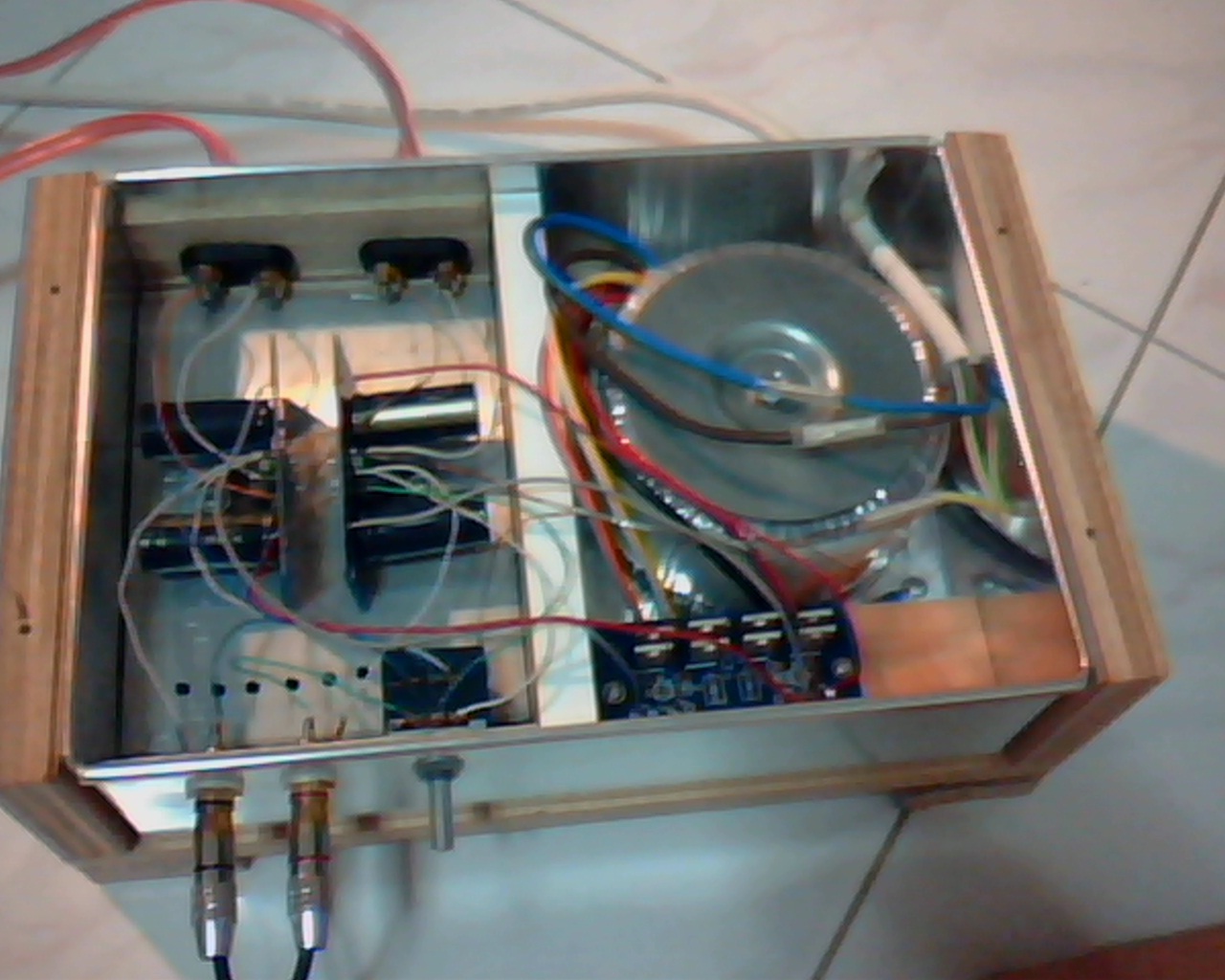

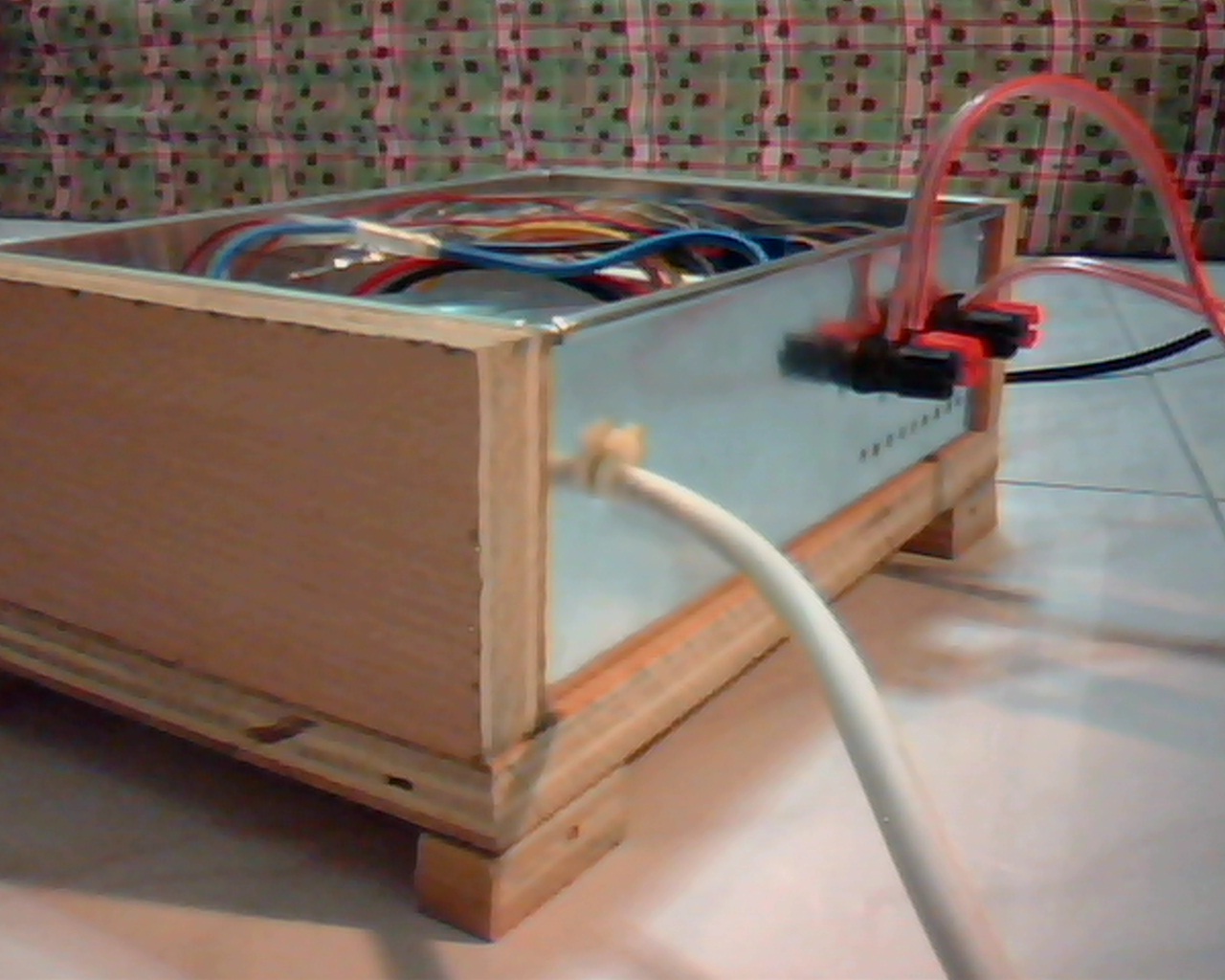

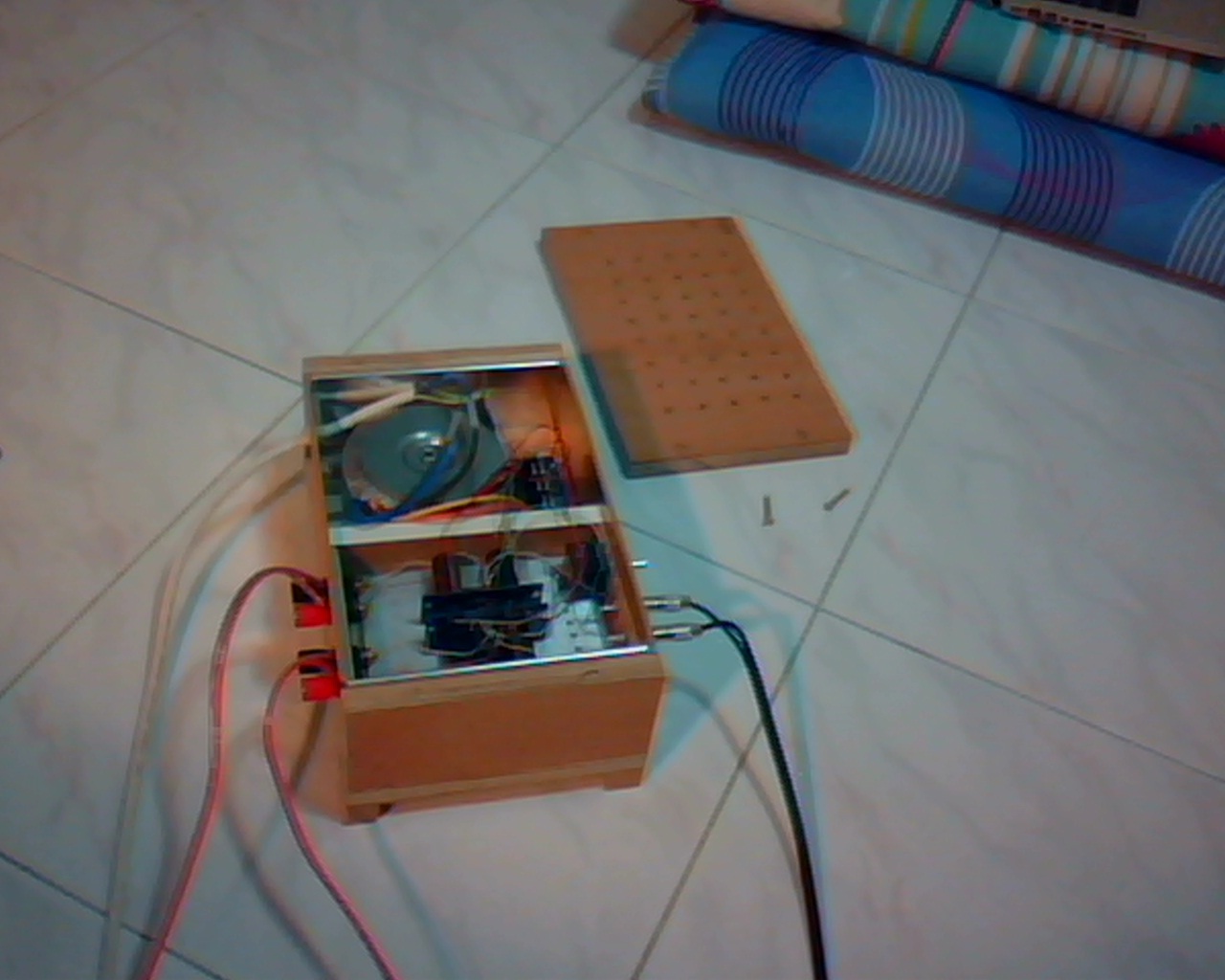

Hi all,
I finished my GC. I attached some pictures of the first DIY GC. My bother helped me much in doing the case.
We also looked around for a pair of bookself speakers and finally decided to choose JBL2080 to start our hi-fi listening. Actually, there are some other brand name old pairs that the seller introduced: MS, B&W, Altec Lansing, Audit HRM-2, Phillips. All are old but in very good condition. Very like to listen to Audit but as budget reason and we both agreed that should begin with some "beginning level" first. C'est voila, JBL2080 was picked.
Together with GC, it immediately became our buddy everytime we are at home. Listen to music is naturally and totally relax. The bass of JBL2080 is very comfortable, we love it. And high is clear, crisp, And GC (thanks to premium kit from Peter) and JBL2080 is like a mom with two daughters wandering on the beach when the sun is going down. Beautiful sounding. My brother comments that listen to music is now not tired and we can do it hours and hours, days and days. No wonder someone out there pay much effort for better and better sound.
We are enjoying our music and time.
Thank you very much, Peter!

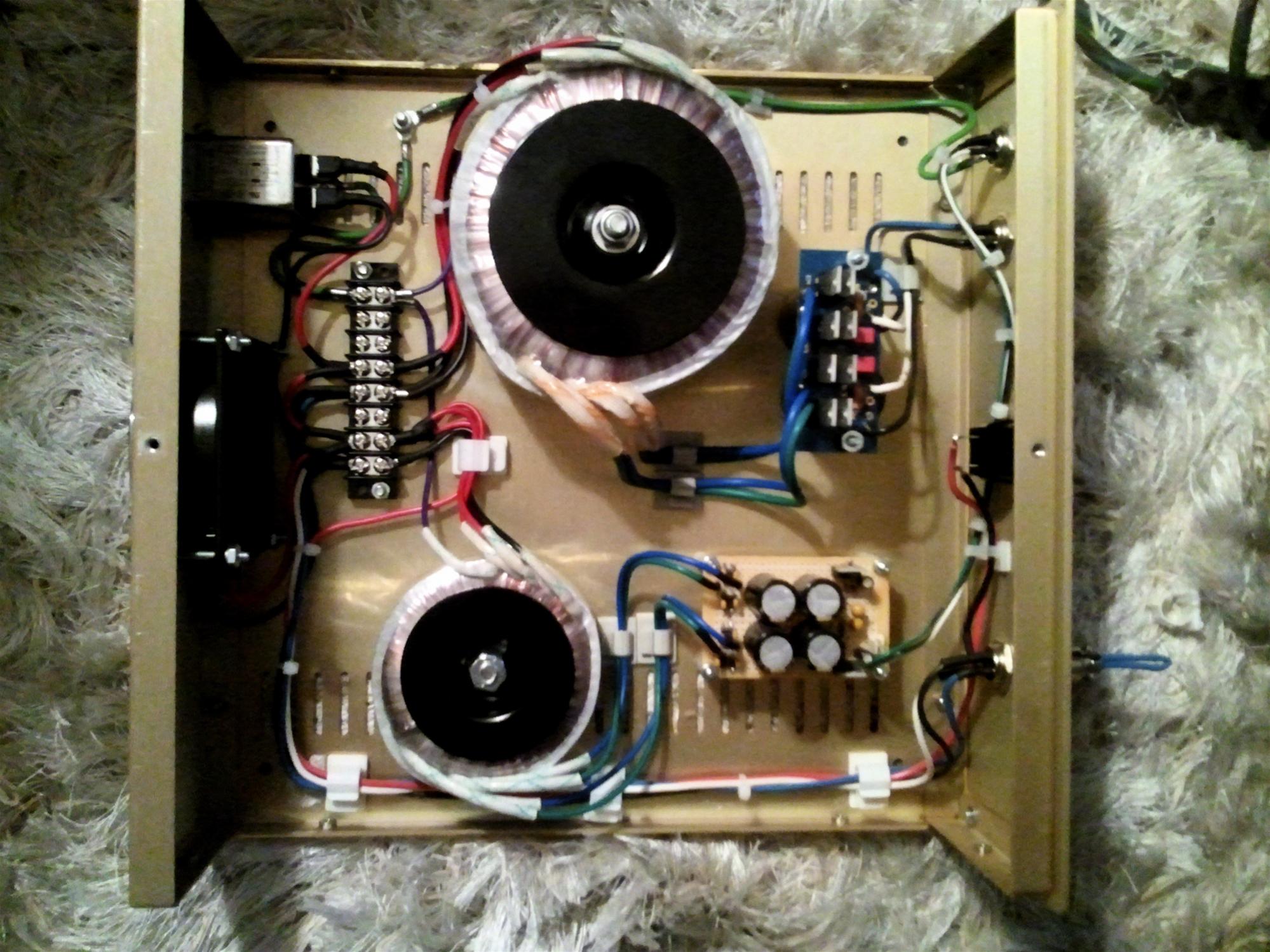

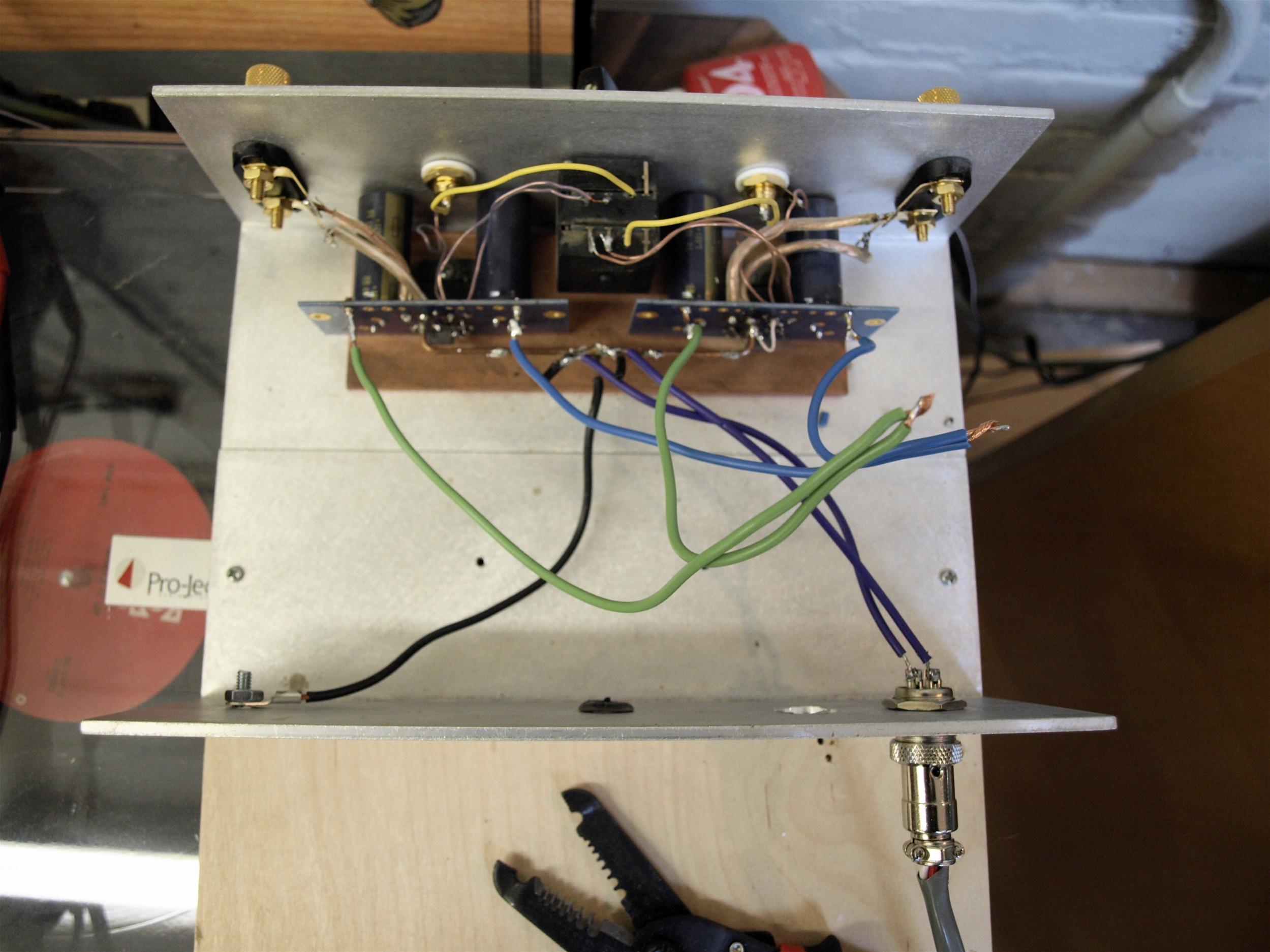

Well lets see if I can Get some help with this one.
I'm finally getting around to putting my amp in a nice case. I built up a separate psu with a new transformer from Antek and the extra power supply board. It's all neatly installed in a box along with a +/-15 supply for the phono pre [see attached pic]. I have a four conductor connector handling just the GC supply which is +/- 35vdc at the output of the psu. There is a 3 ft cord connected to the GC temporary enclosure. I also have +/- 35vdc at the connector coming in. So everything appears to be right on so far. Now when I hook up the amp boards I pop fuses. Out of the 100 times I've traced the wires from the connector to the board I've found nothing wrong or different than the way the last supply was hooked up.
If I detach the purple wires [see pic]that carry the PG- wires to the star ground I can hook up the +/- vcd without a problem.
If I have the PG- wires attached and try to touch either of the +/- vdc wires from the amp boards to the appropriate pin on the connector it will spark:eek:
Anybody got any suggestions?
