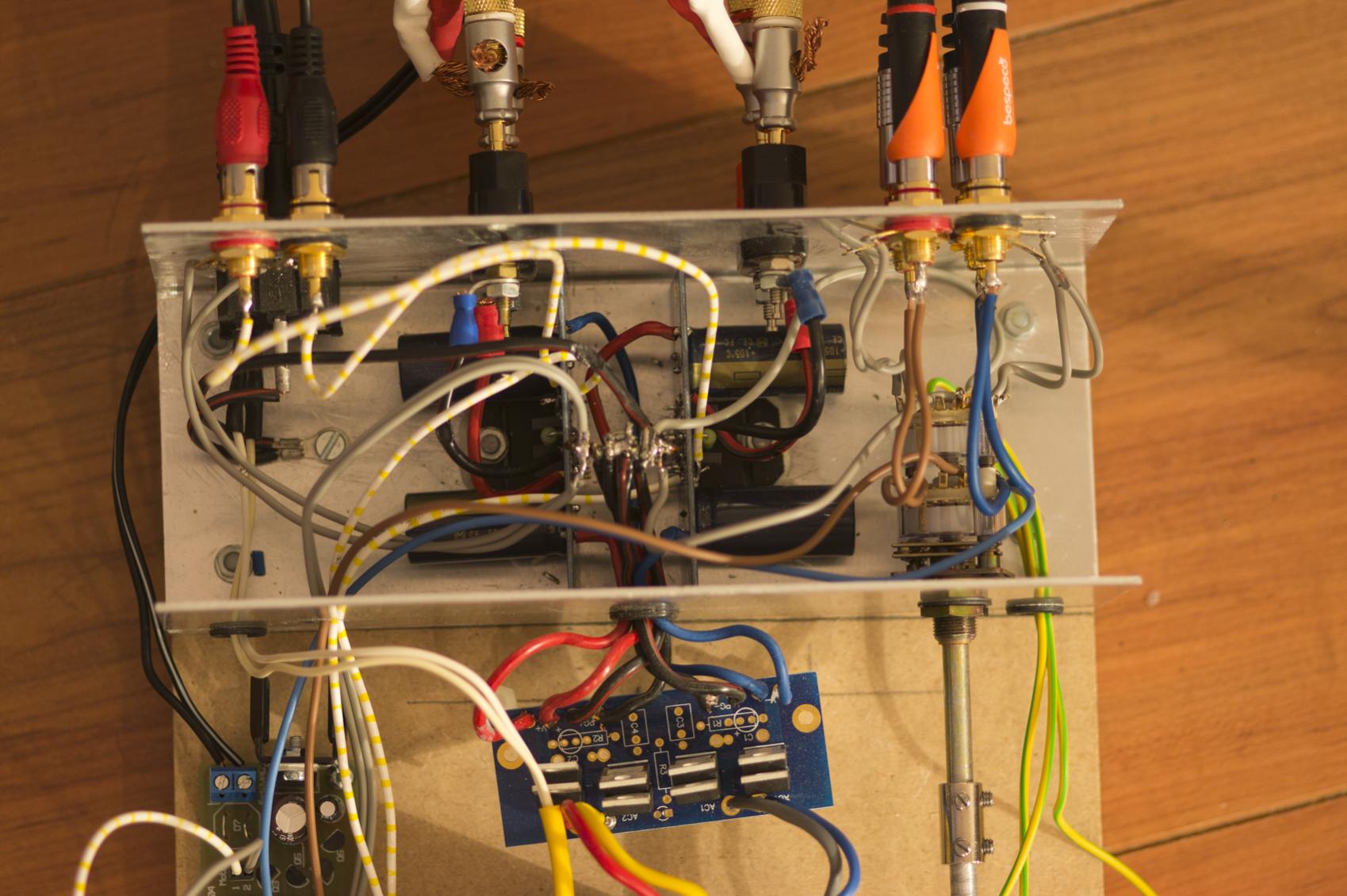

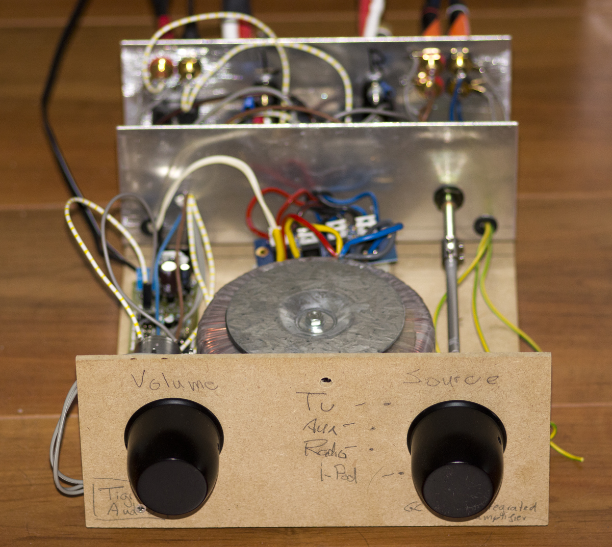

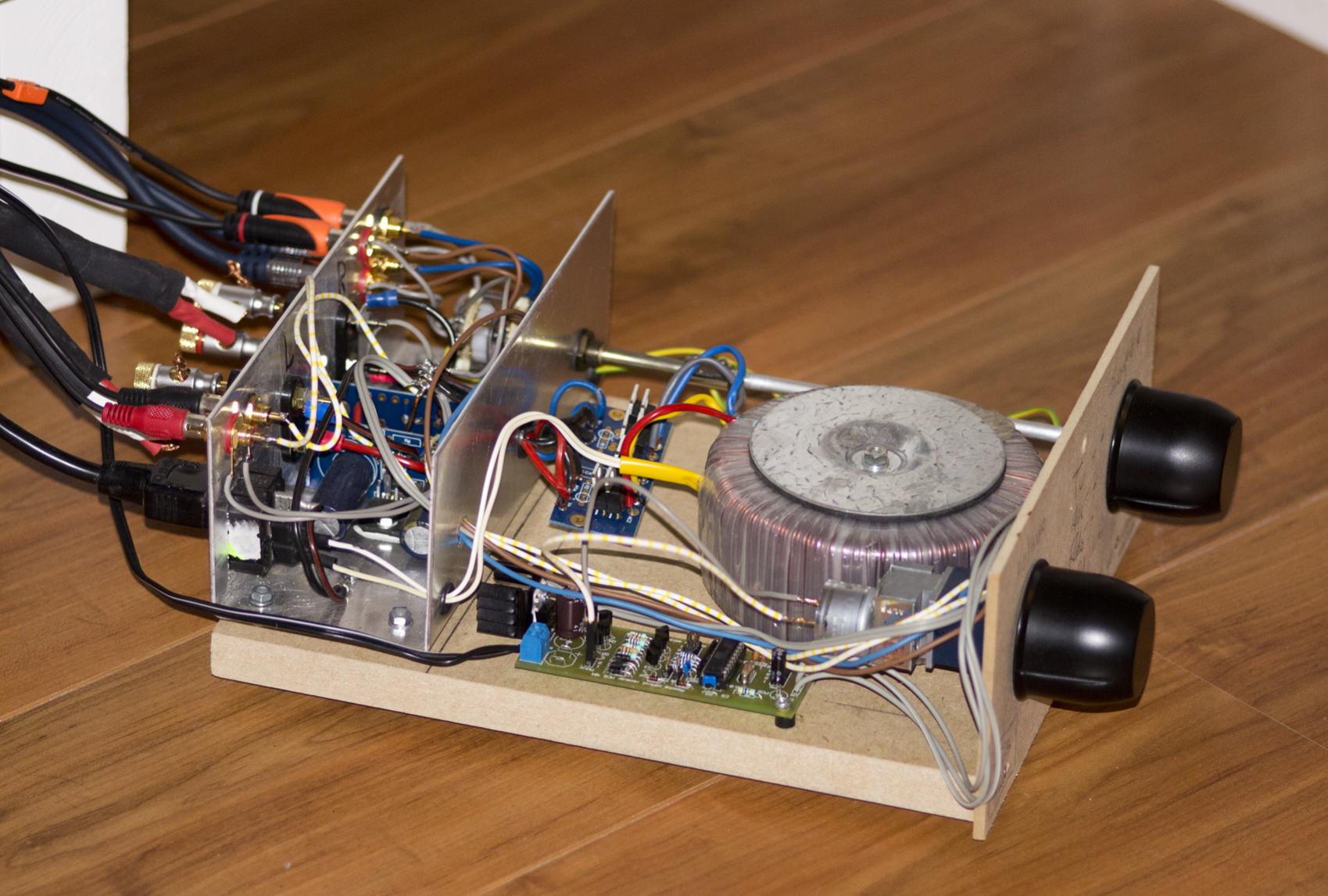

Hi All
With the remote controlled volume pot in place I would say my first gainclone and first diy project is finished in its beta form. Not the cleanest build I've seen on this forum, but it is working, and already sounding great!
What needs to be added to this beta version:
* led lights to show which source is connected
* led light to show amp is on
* a remote controlled mute relay
The first two might be skipped till the final version, the third I would like to start on now, but to be honest, I have no clue how to do that, even after reading the manual for the remote controlled volume board. The board has the possibility to control a mute relay, but how to build that... No clue. Advice would be highly appreciated.
The final version is going to have some changes compared to the beta:
* volume pot closer to amp boards (could not get that done this time without seriously changing internal lay-out, that's why we make test versions, right?)
* internal power supply for remote board
* cardas patented binding posts
* cardas cinch in- and outputs
* higher quality and mostly non shielded cables.
* two extra inputs
* decent case
Am I forgetting something?
Last item on my list is a DAC. To be honest, I would just use it to connect my television optical out to the amp (and in the proces, my xbox / media streamer). Is it worth for that purpose to go for Peter's high quality DAC or would something like a maybe slightly modified hong kong DAC be sufficient?
Thanks for earlier input and inspiration for this great new hobby!
Erik

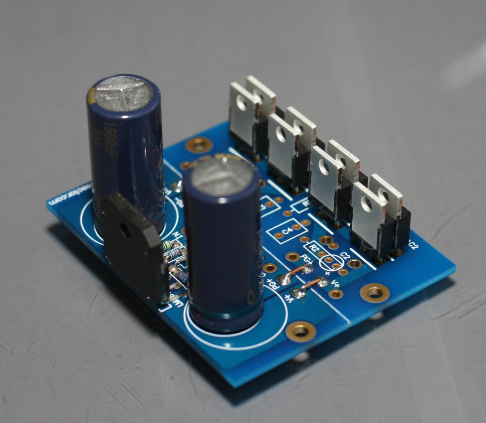

can i use center tapped transformer with the LM3875 PSU board? i know it requires dual secondary, but i have 1 center tapped transformer lying around, and if it can be used, why not?

I don't always measure chips and usually Premium kits get lower offset chips than Classic. If someone needs low offset grade, it needs to specified when ordering and even then, it still depends on what I have available.
With a CT transformer, you can only use 4 diodes for symmetrical supply.
As to separate supplies for each channel, it was discussed here: http://www.diyaudio.com/forums/audi...-kit-building-instructions-4.html#post1517735

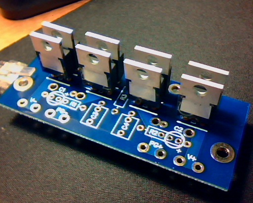

Hi Peter,
I finished a PS board and 2 mainboards last weekend.
However, when I tried a test-run on PS board, I got a "bang" and all blew up. Here is what happened.
I soldered the PS board with 8 MUR860 following your instruction without 2 caps. I used a RED led with 10k series resistor (should be 62k as you suggested but I tried 10k with this LED with DC PS maximum 30V fine then I think it would be the same with rectifier board).
I used brand-new toroid transformer 300VA 2x25V. Carefully measured the 2 outputs of secondary, I got 27.5V.
Connected the sec. outputs to the PS and turned the power up. BANG. Even the house main breaker shut down. That BANG also broke the fuse of the extension power cord.
Then I checked the toroid, seems OK.
Check the LED, still OK as it can light up.
Check all MUR860 on board, they were broken through, I think because I measured the resistance value between two legs in forward bias and reverse bias, the values are not as usual (usually 1 direction with OL value and the other with some Ohm). further, I think the rectifier board got problem or at least on MUR860 was bad before being soldered (!) as there was no voltage to the LED (because the LED is still ok after BANG).
I haven't tested the PS board with power again after that. I don't have variac as well.
By the way, when I asked my brother who is in electronic, he told me that would be a problem because I did not solder wires from toroid to the PS board. I just let those wires went through the holes with purpose of testing. Obviously they were not very well connected.
What is the actual problem to me? Please help.
I still have another set of 8 MUR860 and a PS board. But I need to clarify the problem before continuing.
Thanks in advance
HT
The only problem I can think of is that the diodes were installed the other way.
If it's PS from LM3875 kit, the diodes should be installed according to picture here: http://www.diyaudio.com/forums/atta...ainclone-kit-building-instructions-diodes.jpg with white stripe marking metal tab orientation. With LM4780 the diodes install the opposite way, but again, white stripes still indicate the correct position.
Not soldering the wires from transformer secondaries shouldn't be a problem, also mixing them wouldn't be a problem either as both rail circuits are completely separate on this PS board.
The LED should not affect anything either, with proper resistor (62K is what I use) it's either lights up when installed correctly, or not when placed wrong way.

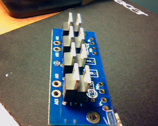

I just managed to have PS' pics from my webcam. It's PS from LM3875 premium kit.
I tested all diodes on board just now using Fluke 179. All are in good condition. Have no idea. May be the PS board is till in good condition.
How do I test the rectifier board without power?
Hi DeepBlue.
As PD says, are all the diodes soldered the way you show in your picture.
Solder the Trafo wires to the board. Don't just stick them in as you did. That could be the problem. Tripping your mains , means you had a short circuit. A 300VA trafo would not overload your system.
AS Andrew suggested, the light bulb tester is the safest way.
Can you shows us a picture of a transformer connected to the board (no power applied though) and the link to transformer wiring diagram.
It is indeed not critical, because if everything is assembled carefully without any mistakes, the circuit will work right from a start. The bulb is only needed when you leave chance to errors and need prevention mechanism.
The bulb is certainly critical when developing new circuits, as you never know what may happen.
John Curl uses one too: http://www.diyaudio.com/forums/powe...-surge-problem-toroid-help-2.html#post2242788
I didn't use bulb-method.
I just remembered that I bought an AC-AC adapter (230V-100mA to 9V-200mA). This was my mistake to buy it instead of AC-DC 🙄 but now it become useful 🙂. I used this AC-AC adapter to test the PS.
To my surprise, the PSI works. The adapter output is 11.13VAC and PG+-V+ is 9.88VDC and PG--V- is 9.63VDC.
