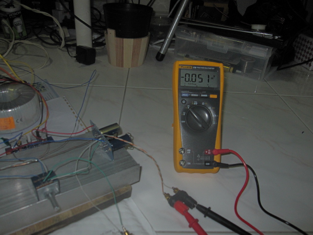

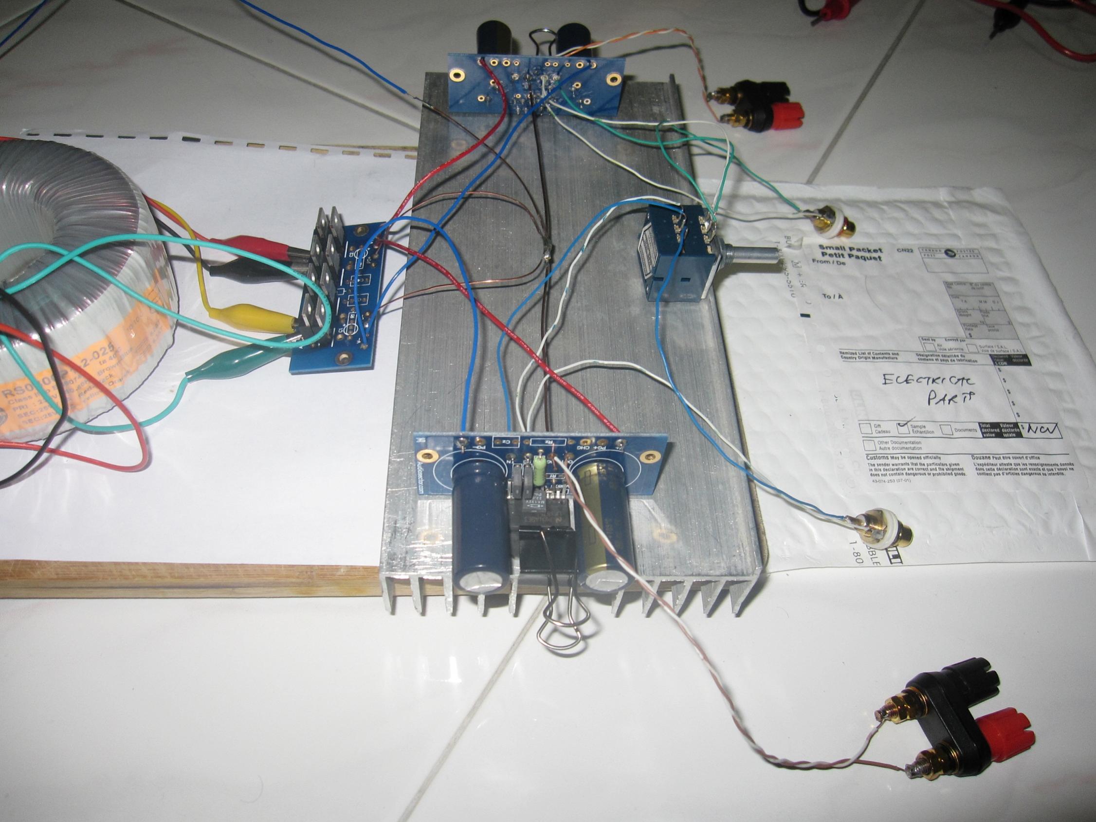

Hi Peter,
After a week could not touch the board, I can continue my project this weekend.
1. The rectifier passed the test. Without the cap, the output between V and PG for both rails is 36.2VDC. You said it should be approximately +-20Vdc without cap, and 30+ with cap.
Is it too high on my board? I used toroid 230v-25v x 2.
Then I finished soldering parts as in the first picture.
2. I connect the PS to two amp boards and used star ground. For testing, I soldered the star ground to the ground line of home electric net. An ALPS 50k is used for volume.
Now is the result of dry test with no load:

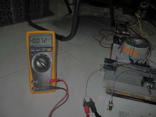

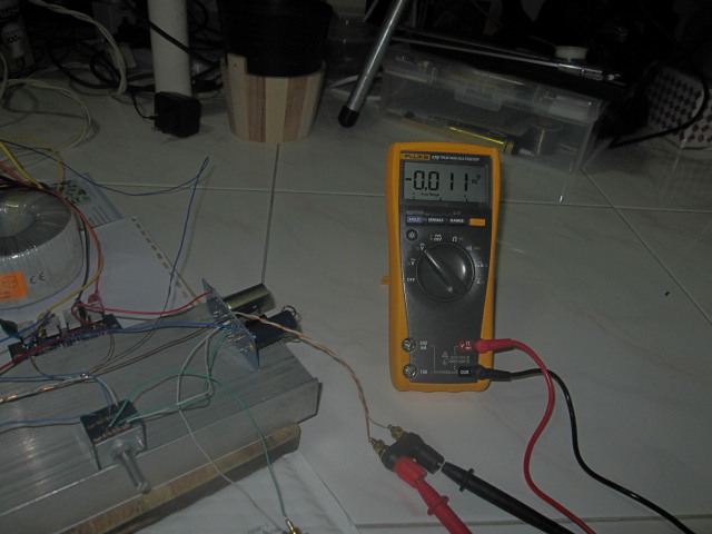

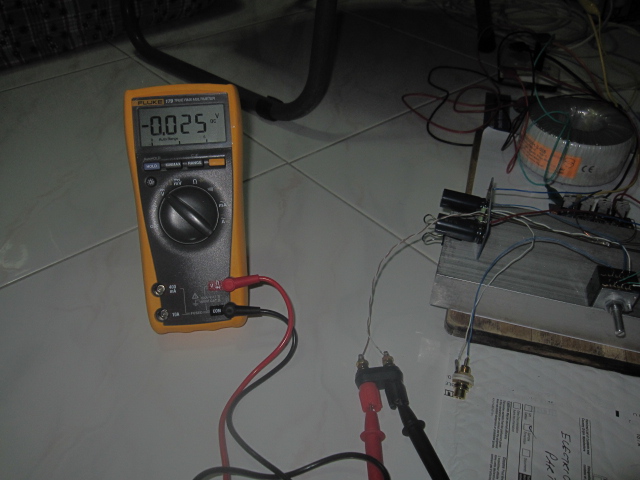

- In the first time turn on, volume is completely down, left channel offset was -25mV and right channel offset was about +32mV! I turned the volume up, left channel went up to -70mV and right channel went to -27mV. Is it abnormal?
- Turn the amp off and no speaker connect, I could see the offset jumped to 4.36V.
- I let the amp run with no input and no output for more than 3 hours, the left channel offset values is the same as the first test (-25mV with min volume and -70mV with max volume). However, the right channel, something strange (i think) happened: with the volume set completely down, the offset value was changing gradually from +32mV to -14mV and the offset when volume was set maximum was also adjusted accordingly and the last value I could measure was -53mV or so.
I don't understand this. Could you please advise?
By the way, one of the 1500uF cap has a little distortion on its cover when I first checked parts from the delivered package. I thought it is OK anyway and continue as you can see. However, the above phenomenon is accidently occuring to the board with that cap on.
Is it true that the distorted cap (just a little) does not work properly?
For your reference, the 2nd, 3rd, 4th and 5th pics were captured the offset values (volume set minimum and maximum respectively) of right and left channel during test.
3. I left the amp run with no input and output load for more than 3 hours. Is it equivalent to running the amp with in/out load in the same amount of time?
Many Thanks.

My voltage suggestions were for 22V transformer, what you are getting with your 25V unit is perfectly fine. Please also note that voltage variation will depend on output from the wall and it may be off 10% off from nominal rating and on regulation margin of transformer (the voltages are listed at full load, which you won't see with that amp)
This is perfectly normal and that's what I was trying to point out in post here: http://www.diyaudio.com/forums/audi...kit-building-instructions-69.html#post2459586
The offset will depend on a particular chip and is subject to shunt resistance (22k) at amp's input. Adding pot in parallel with that resistance will affect combined shunt resistance value and that's why you see those changes when pot turning. When you add coupling cap between pot and the amp, the shunt resistance value is not affected by pot rotation, but since it's always 22k the offset will be also highest, that's why I said that adding coupling cap may actually increase your offset (-70mV vs -25mV for left channel, with a right channel there is no so much difference as offset balances nicely through 0 point).
This is also true for amp with no pot and low output impedance source connected. You will always see a drop in DC offset when connecting source, you won't see that effect with coupling cap in place. BTW, I measured offsets on 47Labs Gaincard and they were approx 80mV.
4.36V at shut down is normal with no load, when speakers are connected, it doesn't happen.
The cap has nothing to do with that, and slight blemish does not affect anything here.
I can't comment on point 3; it could be the same or it might be not, but it's best to burn in the amp with signal and the load.
