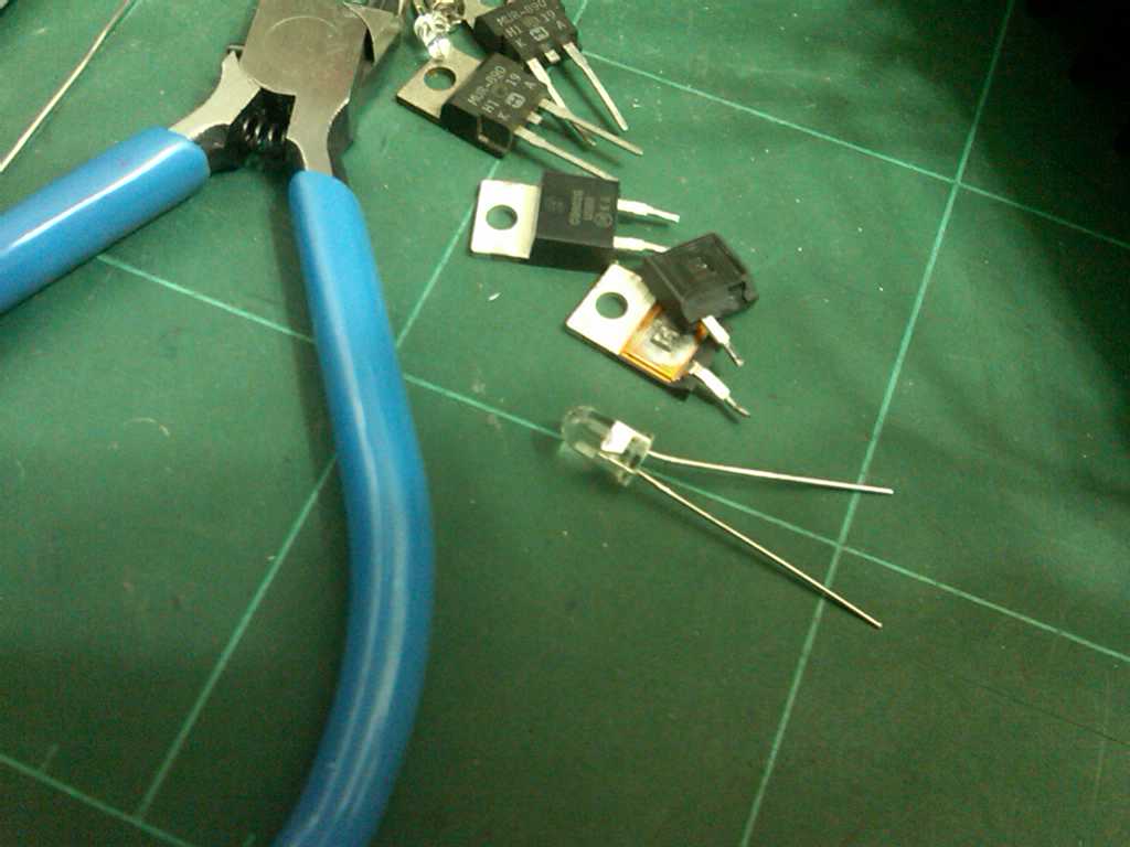

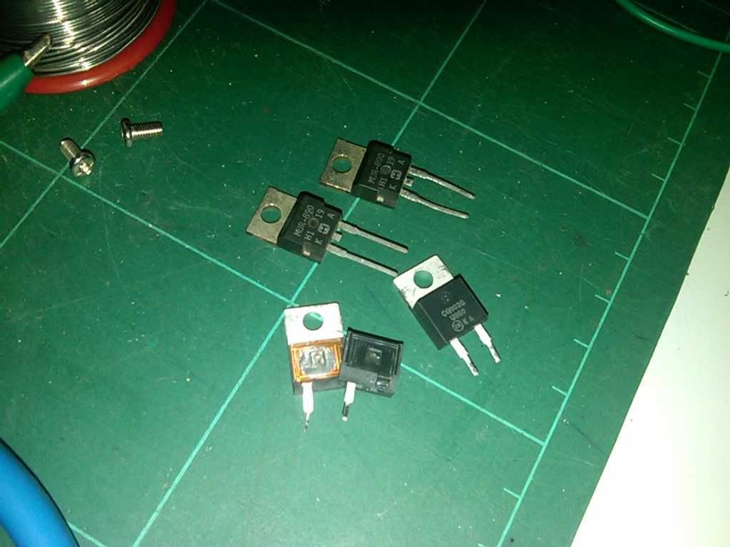

I have accidentally burned two mur860 in one channel. Can these to replace with MUR890? I am building Peter's LM gainclones (monoblock). Also, the LED light in the other monoblock seems to be turning off very slowly. It took a minute for it to turn off. The rail is at 27v. transformer is 2 x 25vdc. DC offset is at 80mv. what is wrong?
In picture 011.jpg, the bottom two mur860 are the ones which burned and the ones above are the mur890. The LED is shown in 013.jpg. I used a 62k resistor at R3.
LED turns off slow because you have capacitance that keeps it glowing until the capacitor is completely discharged. If you are using a regular LM3886 or LM3875 you do not need better than MUR860. How in the heck did you destroy one of those diodes?!
IF you have MUR890 laying around it will do the same job as the MUR860
Yes...but lights goes off in 1 minute???
Sigh..it was a stupid mistake...the v+ and the pg+ from the psu was suppose to connect to the v+ and pg+ of the main board....and i connect the pg+ of the psu to the 'chg' of the main board...and the v+ of the psu to the pg+ of the main board. Heard the transformer buzzz but I thought it was humm and then 'pop'..spark flew and i have two destroyed diode. i am using the LM3875. Can I sub the two mur860 with the mur890? I have the 890 but not the 860.
