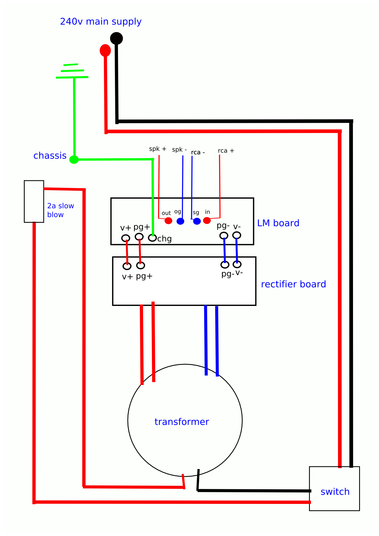

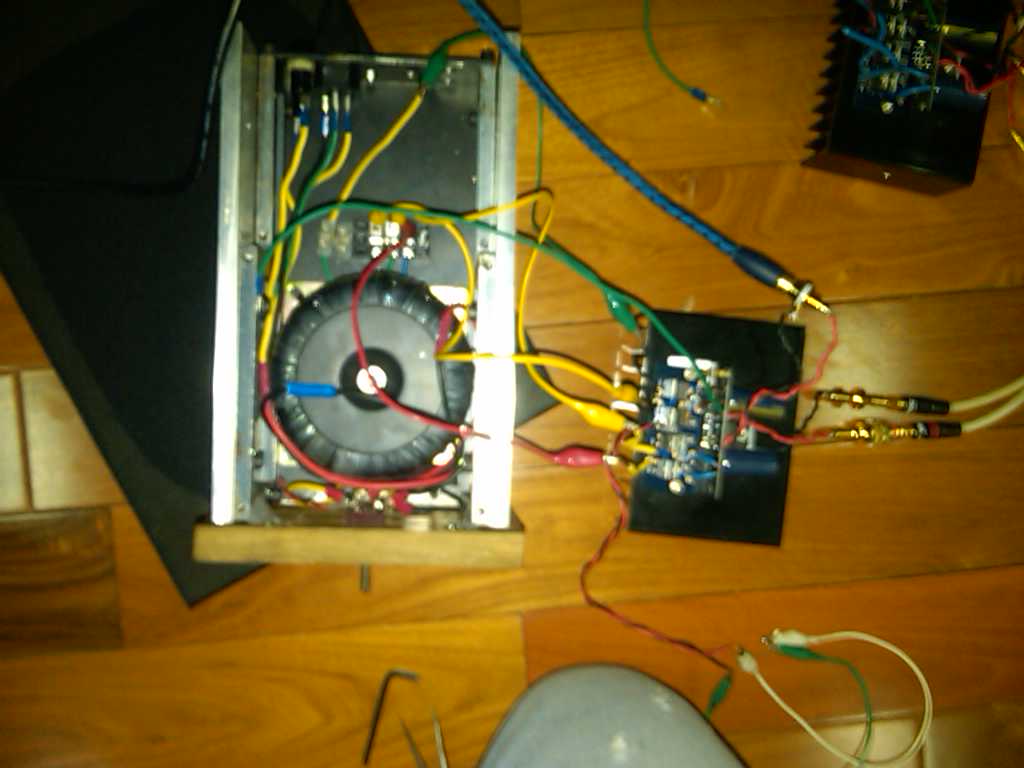

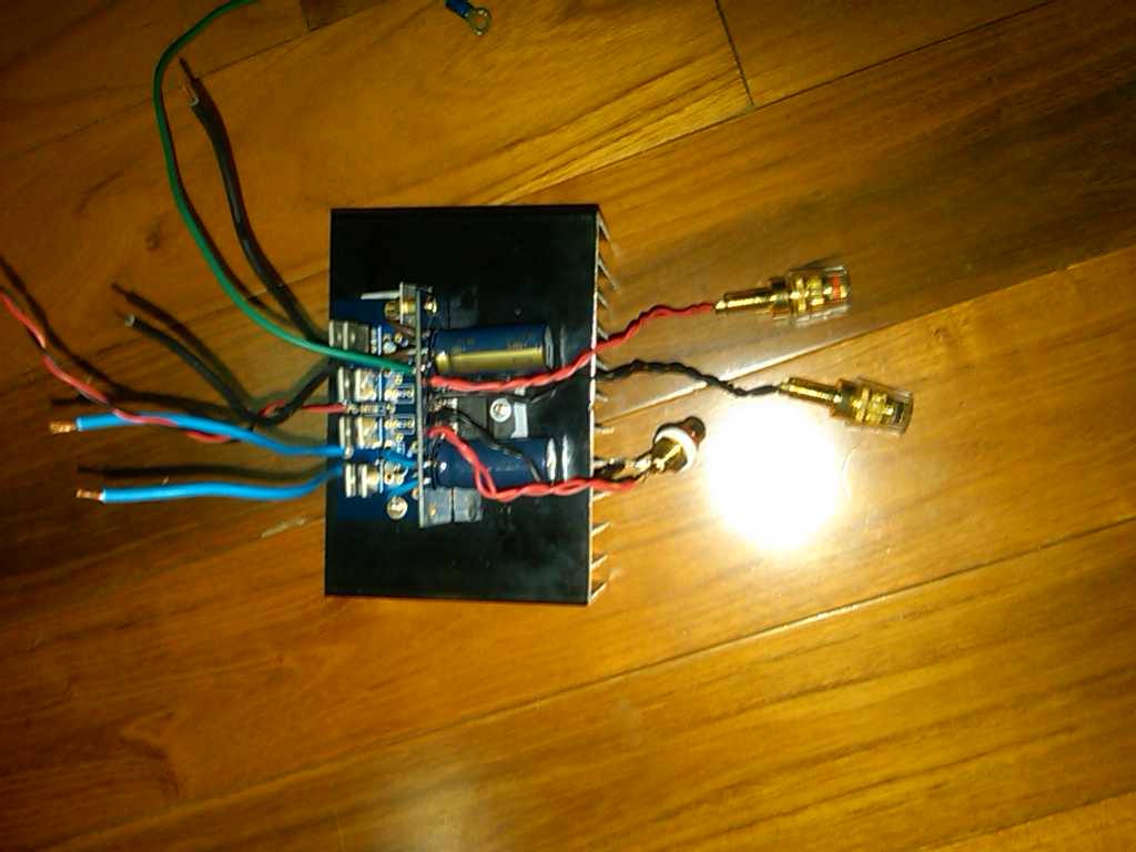

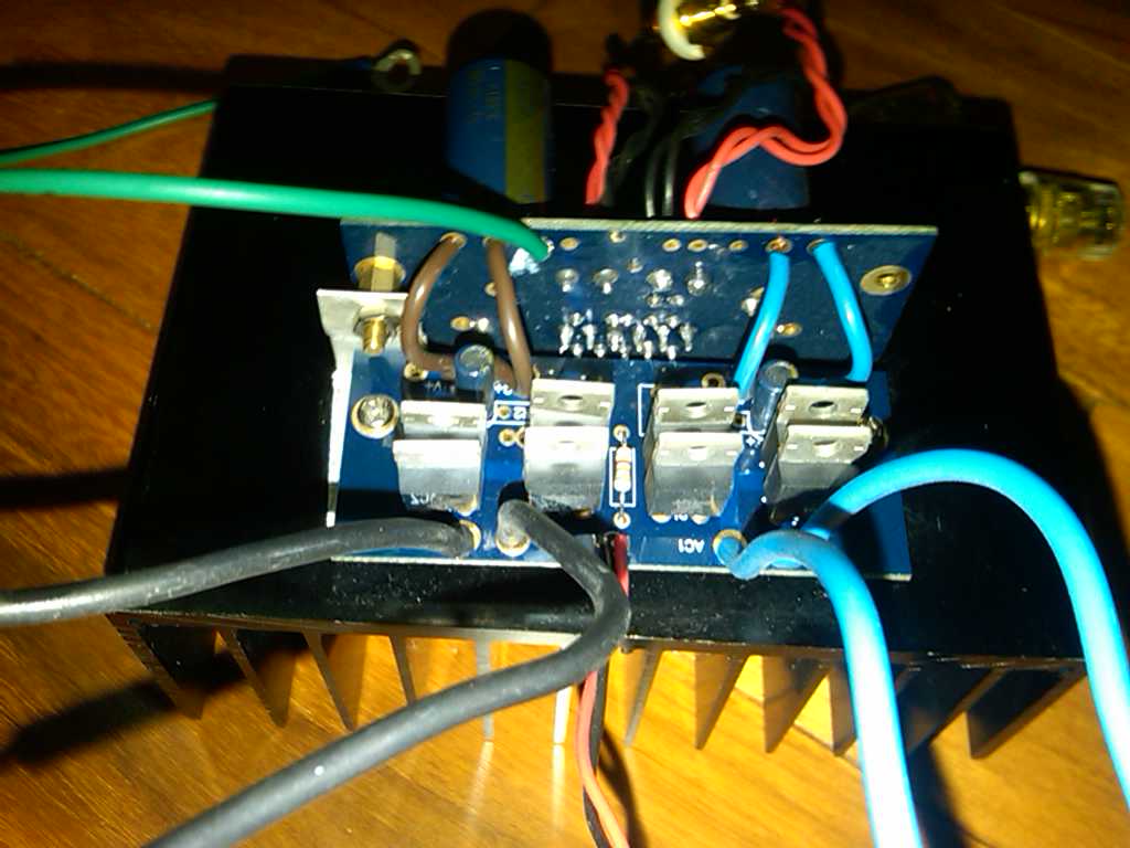

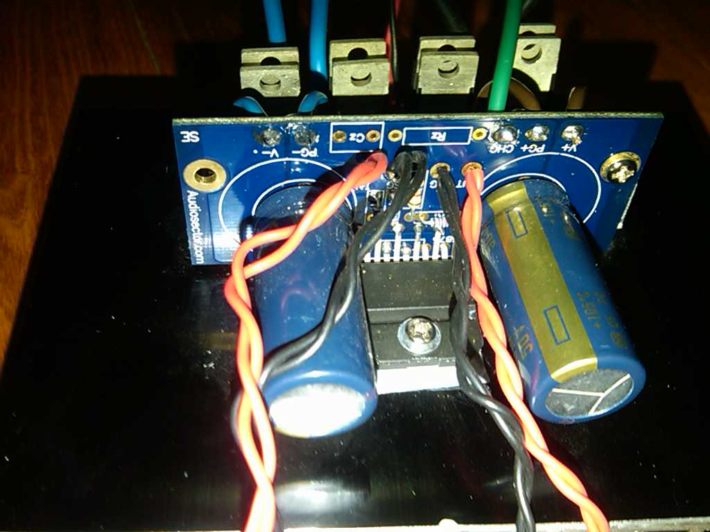

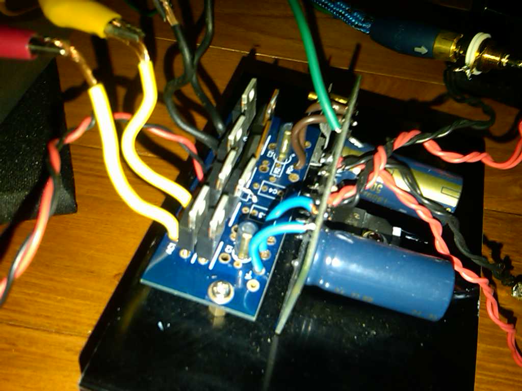

connected the cg
hg to the chassis...resoldered joints....still buzz when connect to preamp. sound from radio is very faint.
