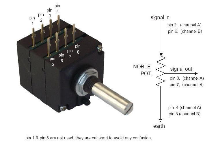

I've been using Noble pots for years; while they are not perfect, for the price they offer great value. Available from percyaudio and partsconnexion.
Most suitable value is either 25k or 50k (log taper, stereo). Picture below shows the connections, pin 1 & 5 are not being used in normal application (those are for loudness option)

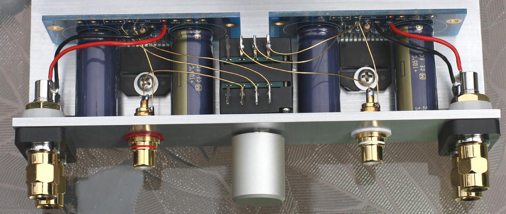

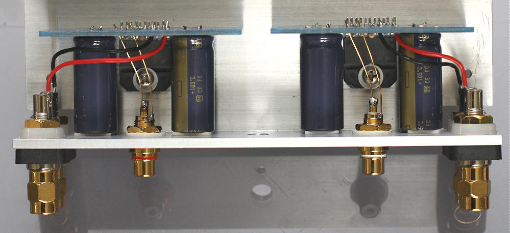

And here how it's implemented in the amp.
I use SG (signal ground) on amp board as star ground for input signal. The ground wire from RCA and from ground pin on the pot (pin4) connect to SG. Signal wire from RCA goes to pin 2 on the pot, from pin 3 it goes to IN on amp board.
Those are the connections for one of the channels, the other channel is done exactly same way. Please note that so far the grounds are kept separately.

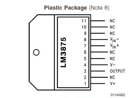

Talking about interferences, there are certain instances, I guess mostly due to location and local house wiring, where the amp is sensitive to switching appliances and house lights, and may also pickup quite heavily radio frequencies. In my experince, this is some 5% of users that need to deal with that problem and the cure is quite simple, by installing small polystyrene capacitor (300pF or so) between inverting and non inverting amp inputs (pin 7 and 8 in attached diagram).

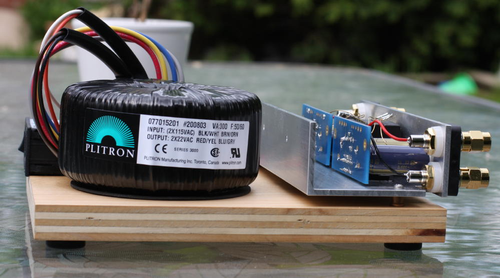

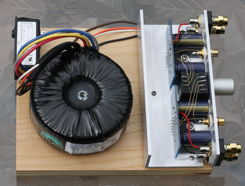

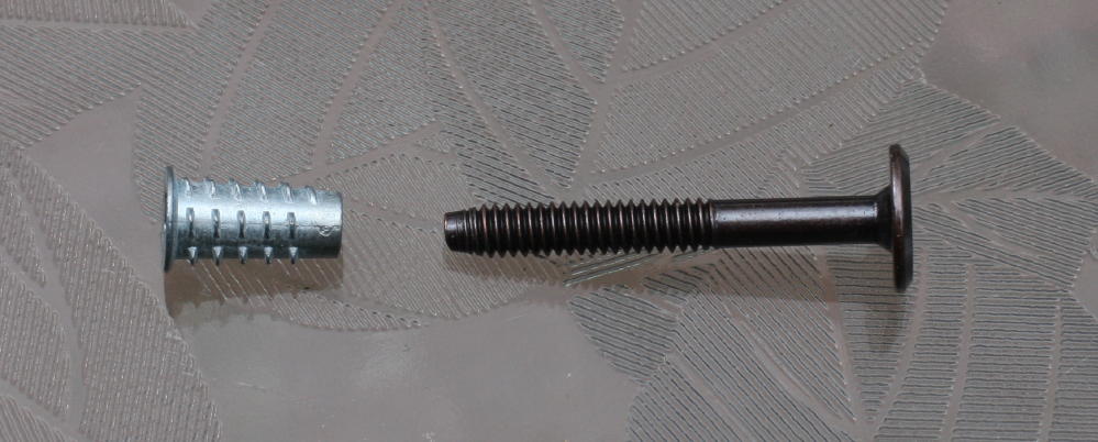

Lets start with a transformer. I use Plitron 300VA, 2 x 22V AC in all my amps, both stereo and dual mono. It is is approx $100 for a single unit. Getting similar Avel transformer from Partsexpress will cost you $50/pc.
If I order custom transformers, I prefer secondary at the core with wire diameter 1.8mm (for 300VA unit). I tested some amorphous core custom transformers and they sounded marginally better than standard core.
If your transformer comes with a standard mounting hardware, that's what you use.
Plitrons are epoxy filled and hardware is not included. I increase the hole to 3/8" size and install ancor nut with a matching screw, available from Home Depot. The screw hole size, in a bottom of a chassis, is 1/4".
