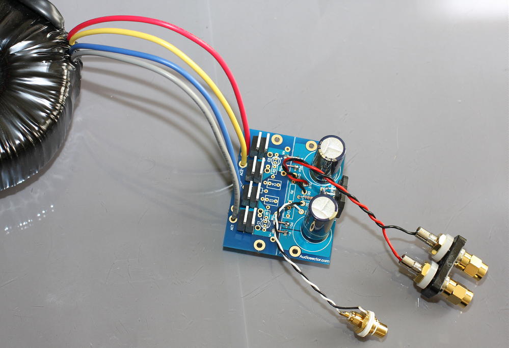

Peter Daniel said:This concludes the assembly and we have two separate amp channels with separate bridge rectifiers. All is needed now is to connect 2 transformers (one per channel) as per schematic posted here: http://www.diyaudio.com/forums/attachment.php?s=&postid=1508798&stamp=1210694958 , connect the input (SG for ground, IN for signal input) and output ( OUT to positive binding post, OG to negative) and we have a working dual mono amplifier.
And this is how one complete amp channel looks when wiring is done. The transformer primaries are not connected yet, and I will explain it at later stages.

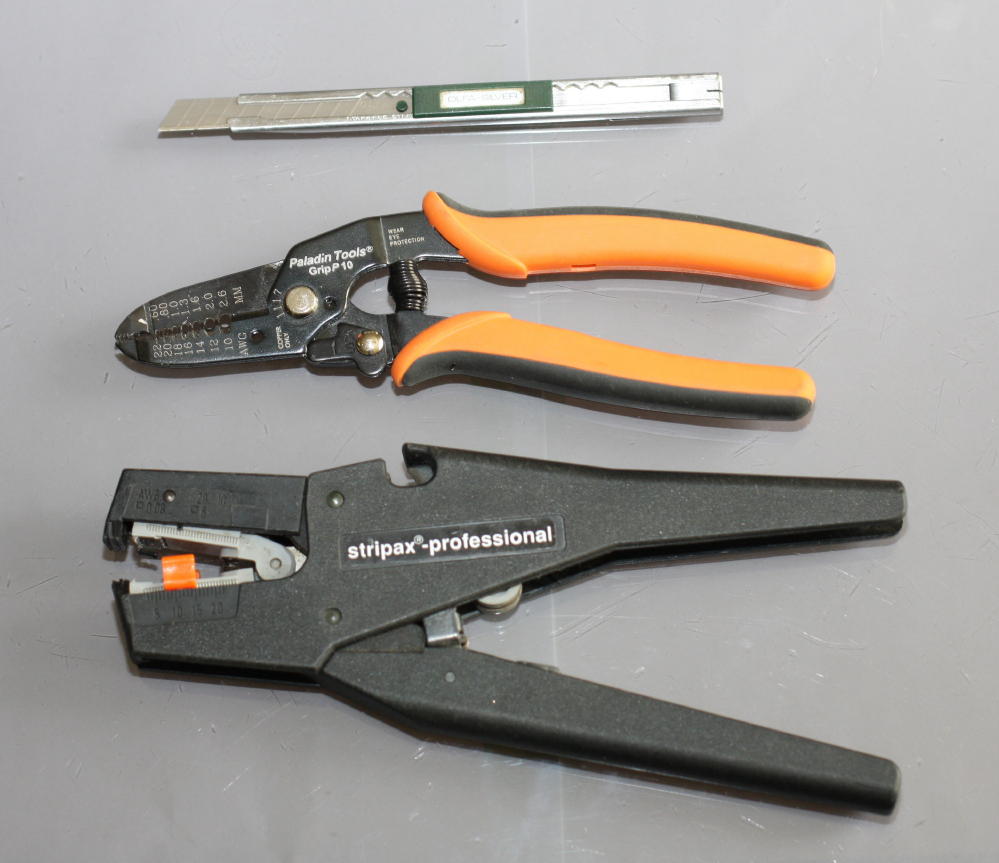

I usually use 26ga solid core wire for input signal and I never found a need for shielded cable. I normally don't even twist them, but it's a good idea anyway.
For speaker connections I use 19ga stranded wire.

By stereo version I mean the use of a single transformer powering both channels. You could still use two separate rectifiers boards, but depending on wiring it may produce hum in some systems, so I always stick with a single rectifier board when using one transformer.

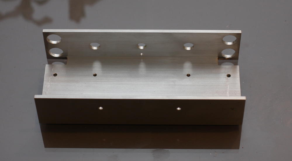

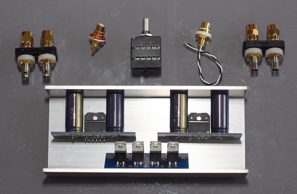

For demonstration purpose, I will install all the boards inside 3 x 1.5" U-channel, 1.25" aluminum extrusion. For normal listening, this is enough to dissipate heat from the chips, and when things get hot, you can always attach it to larger aluminum panel.
I will show a version with a potentiometer, and without, so stay tuned.

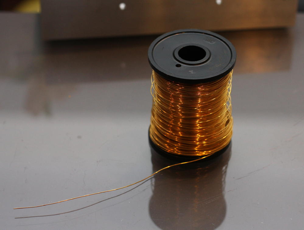

As I mentioned previously, I never found the need for shielded wire and what I'm normally using is 26ga gold plated solid core copper. I only put teflon sleeving where the wire might come in contact with other wires, or chassis parts.I got it from a friend and he didn't disclose his source (most likely in UK)
Other alternatives can ba CAT 5 wire or Cardas uninsulated silver wire and Vampire Cast Copper Wire (available from Percy).

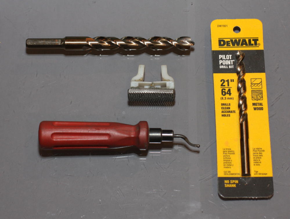

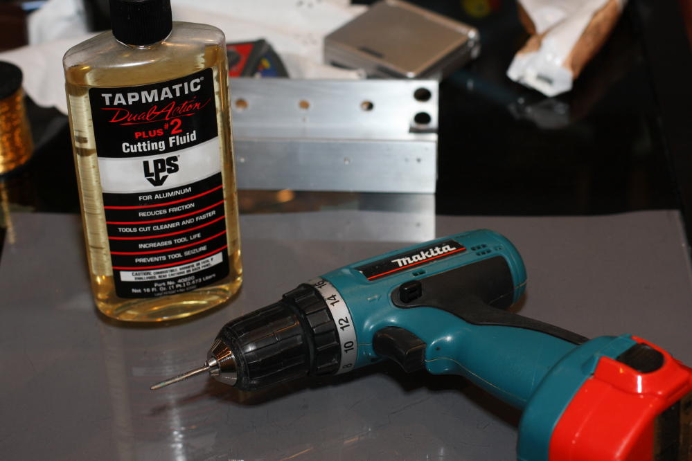

I use 6-32 screws to mount the chips, which requires 7/64 tap drill. For tapping, I always use a cordless drill gun and presently, Tapmatic fluid. For more info on tapping see those posts: http://www.diyaudio.com/forums/showthread.php?postid=69413#post69413
Probably from here . 😉
Could be, thanks for the link.
The spool I pictured is 0.50MM GOLD PLATED COPPER WIRE SOFT 500GR, Ref: GP0500S-500
http://www.wires.co.uk/acatalog/cu_gp.html

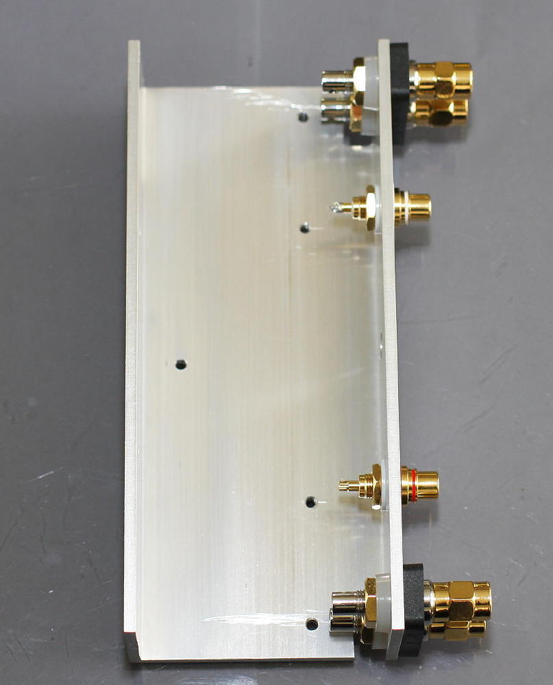

I mount RCAs and binding posts first, and what you see is Cardas hardware. I use the cheapest RCAs: http://www.cardas.com/content.php?a...Female RCAs+(closeup)&content_id=6&part_id=32
and to me they sound better than more expensive types.
As to binding posts, I prefer low mass ACBP S: http://www.cardas.com/content.php?a...ding Posts+(closeup)&content_id=11&part_id=83
When spade connectors are to be used, Patented Binding Posts are my first choice (CPBP CRS): http://www.cardas.com/content.php?a...ding Posts+(closeup)&content_id=10&part_id=53
Please note that isolation washers are used to separate connectors from a chassis. With RCAs, I don't use the ground tab; the wires are soldered directly to metal body.

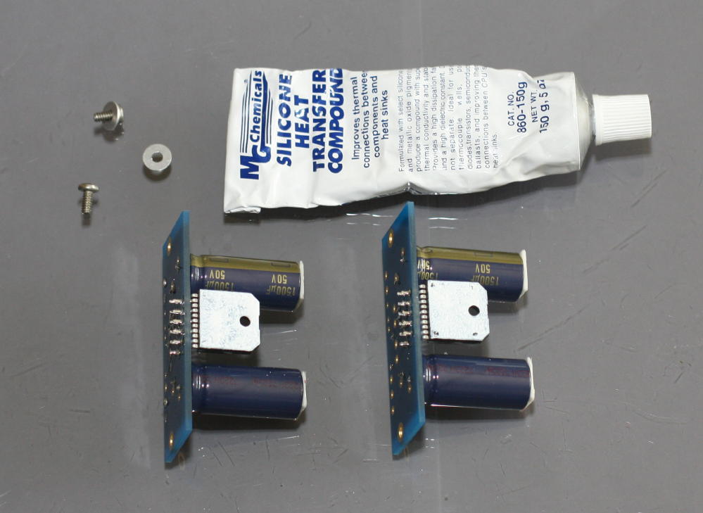

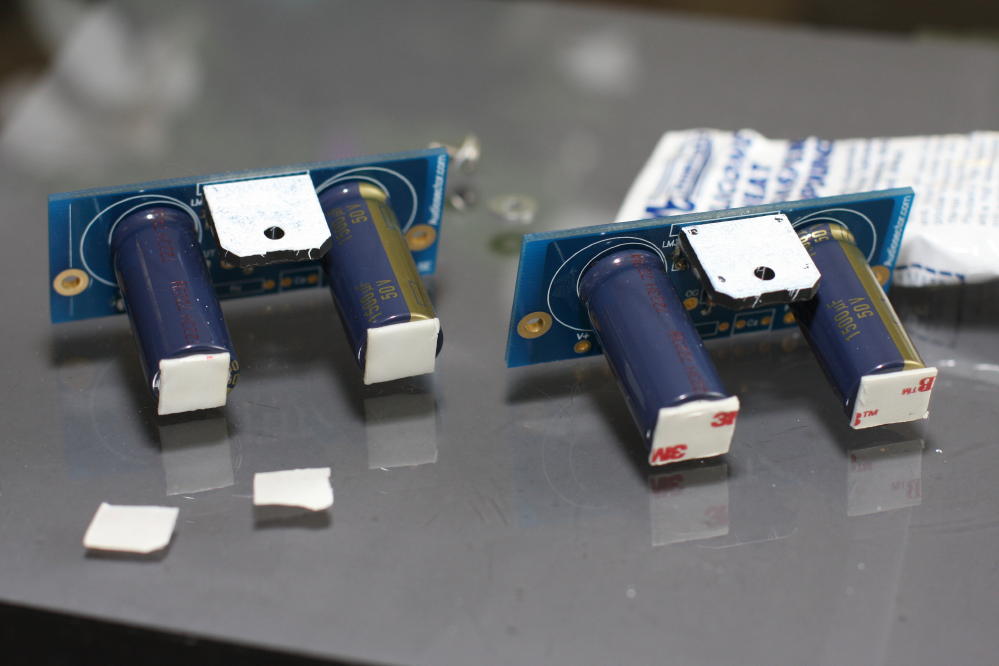

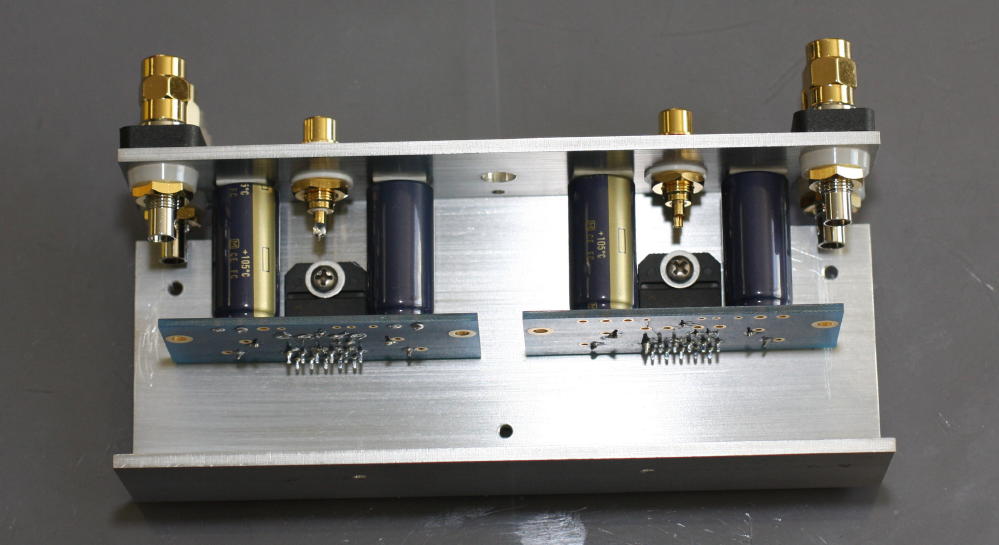

It's time to install amp boards now.
There are two types of LM3875 chips: isolated package (LM3875TF) and non isolated package (LM3875T). With the second one, isolation pad is required when mounting on grounded metal surface.
I use only isolated chips. Although pad is not required, one needs to apply heat transfer compound to improve heat dissipation from a chip to metal surface.
Don't use too much of that paste, only enough to fill the gaps. Also, the heatsink surface needs to be smooth and all burrs sanded out. I apply paste only to the chip, thighten pretty strongly; after half an hour realease the screw and this time tighten only moderately strong. Thick aluminum washer is used to improve contact.
