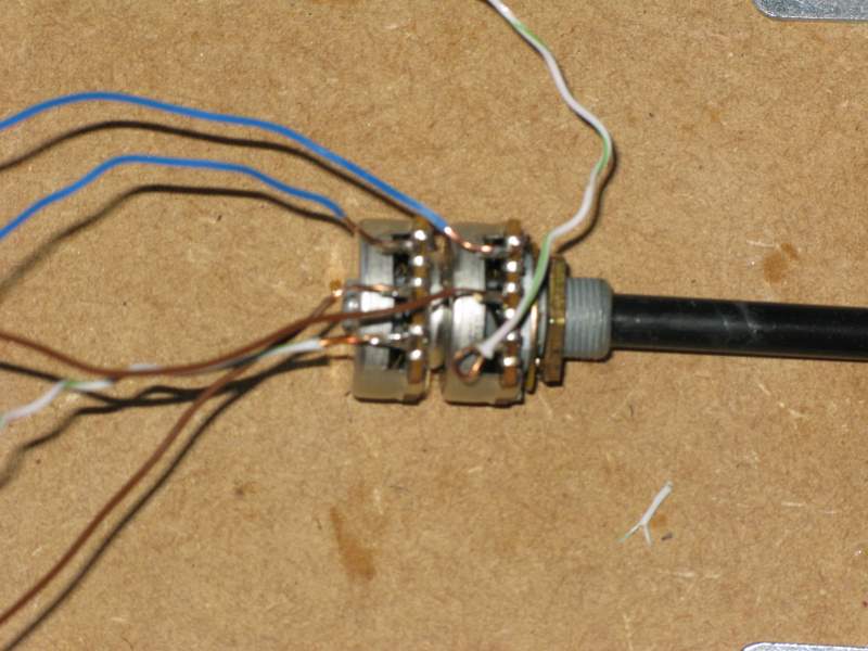

westers - you seem to have both channels connected to one pot - each channel should be using a set of three connections. There seem to be wires from the front pot to the rear pot. Please look at the early posts in this thread for how they need to be connected.
Also what is that white cable disappearing under the board?

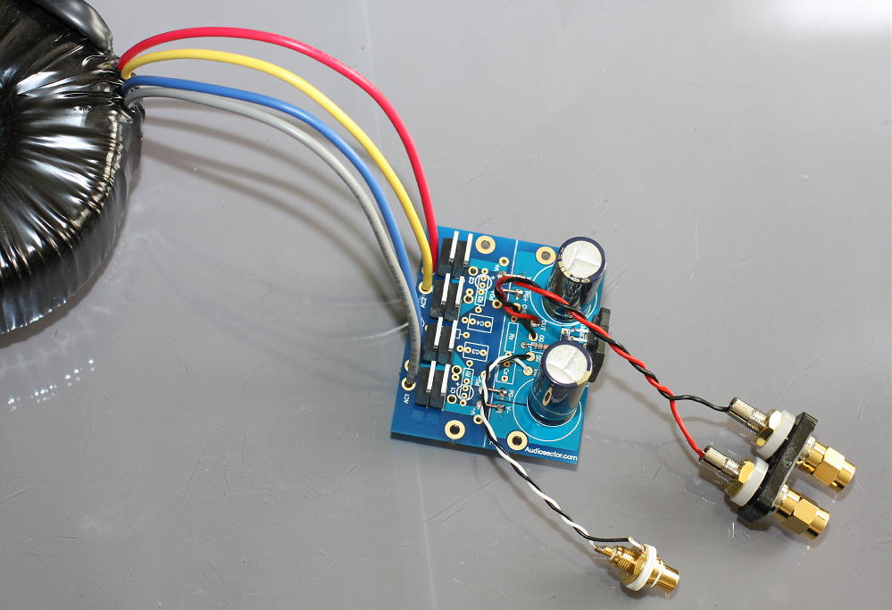

Ignore the last photo as it's a bit misleading on the amp/pot side of things - that was just to show the rectifier connections to the amp PCB's.
Here's a blurry view of the pot - dual gang - the white wire is the input from each RCA, the blue wires are the earth connections, and the brown wires are the outputs from the pot to the amp board.
Each of those wires connects as per my description in post #435 above.

Transformer was connected as per your instructions - one rectifier board with two bridges, one secondary going to one pair of AC connectors, the other secondary going to the second pair of AC connectors.
When I measured the voltage it was 24V for each bridge output, but that was 10V down on what each secondary was rated at (35V). However there was no load whatsoever.

Single rectifier board or two, you always need two secondaries. one secondary gives you V+ and the other is V-.
Connect a single rectifier board to a single amp board as in Peter's picture attached. V+ to V+, PG+ to PG+, PG- to PG- and V- to V-.
