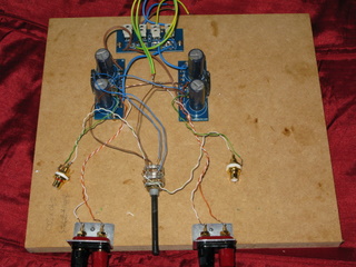

Everything is on a block of MDF, with the spaker terminals mounted on some metal brackets, but the actual terminals are insulated from the brackets by plastic insulators. See here for the actual terminals.

westers,
Is the reason you do not post photos that you cannot take any or that you are having problems with the size of the jpegs, if the latter is the case then this can be sorted.
If you have any but cannot post them then please email me with the images and I will do something with them.
Sorry to harp on about this but it would help you a lot!
Alan

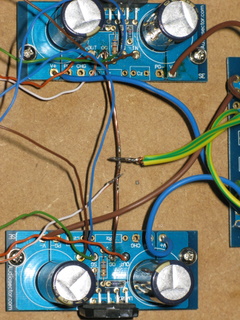

Here's one - a general shot of the layout.
And another - Thin green wire is the earth from the RCA to SG, thin blue wire is the earth from the pot to SG (same on both circuit boards).
Thin brown wire is the output from the pot to the IN on the PCB.
The other thin wire (which is a browny/orange) is the red speaker terminal going to the OUT pcb.
The white wire (with a slight thin brown stripe) is the black speaker terminal connected to the star ground.
Star ground is the copper wire connected to OG.

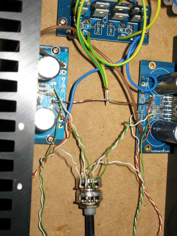

westers - I cannot see enough wires going into the psu board from the transformer - and one of them looks like an earth.
I normally connect the PG+ and PG- from the psu direct to the same on the amp boards - but I do not think that would stop it working.
Also not sure about the pot - it looks OK - but a close-up please.
