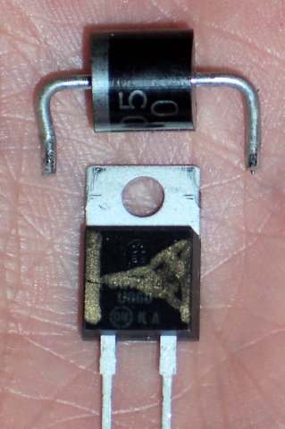

MUR860's? Oh heck! Well, have a look at this picture.
Re: RE: Post # 302
That's ironic, in a way. Today, I was de-soldering MUR860's to replace them with quiet, 1 piece, commercial block rectifier.

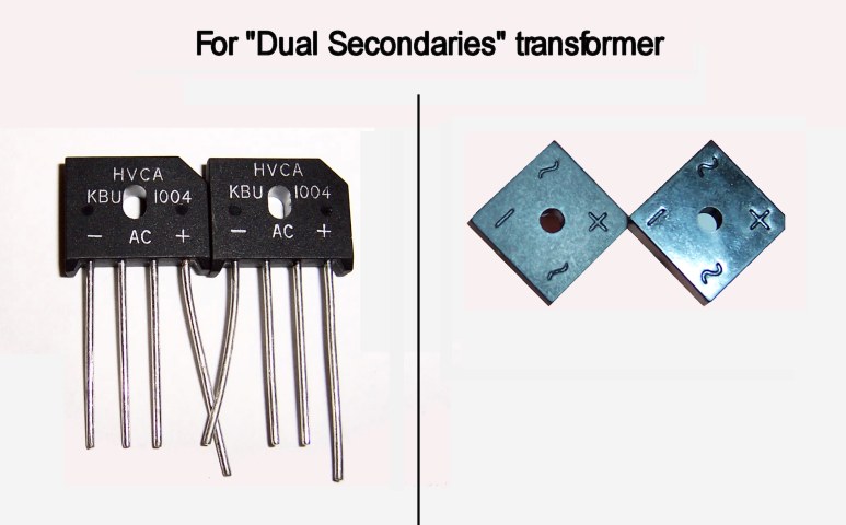

Do you have a "Dual Secondaries" transformer?
This has four wires output instead of the simple 3 of the center tap.
I've worked for something simple, because the usual hookup method (eight seperate diodes) for a Dual Secondaries is confounding to the eye.
Not anymore. 😀
Not anymore. 😀
