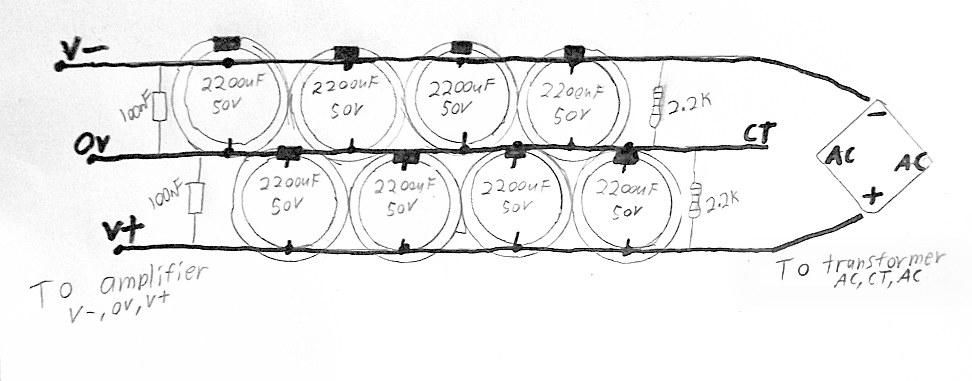

I'll bet you'd like to see this schematic (click attached photo).
This, I made on plain phenolic perfboard (no copper pads in the way). The three wires, in mine, are 16ga or 18ga. They run straight, which is why the caps are in the zigzag layout. I used flux for easy soldering. I made this power supply for my chipamp projects.
My favorite chipamp projects are LM1875, both textbook and "hi-ref" style, as well as TDA7294 in bridged or "hi-ref" styles. And, this power supply schematic has been working quite well for my use of it.
The bridge rectifier shown at the right side of the schematic is an ordinary plastic model that has all of the connections labeled--stamped or printed onto the plastic shell. Models that I have used for this start with names, such as the square KBPC10. . . and the "fork shaped" KBU10. . . both indicating a 10 amper model.
This file is for the purpose of education in reading a power supply schematic, and doesn't represent advice or direction of any sort.
sneih said:wow... nice one...
what purpose use 2,2k ?
It is an optional component named "bleeder resistor" or "drainer resistor." By several minutes of unplugging a power supply, a bleeder/drainer resistor will have "somewhat" lowered the output voltage by draining away "some" of the stored charge in the power supply's capacitors.
hmm thx, before u post i think that resistor can short with + n - rail... hehe
how stupid i am !!

sneih said:hmm thx, before u post i think that resistor can short with + n - rail... hehe
how stupid i am !!
I'm glad that you like the power supply schematic. I thought I should leave something for everyone, before I go and do this: http://www.okfreewheel.org next week.
