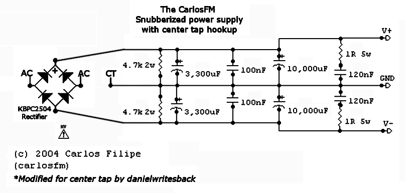

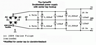

Yes I'm planning to do an unregulated snubberized PSU (ala Carlosfm) but with one rectifier bridge and one transformer per channel without common ground like this
http://myweb.tiscali.co.uk/nuukspot/decdun/gc/gcpsu.2t.2r.gif
I will take care to include the separate switching and the ground leads, including an earth safety ground as suggested.

Like this? (click photo)
P.S. The power ground is the voltage reference point for your speaker. Take care to make it strong so that you have good bass.

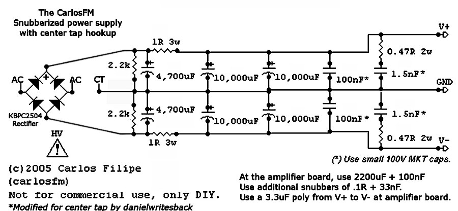

Or maybe like this? (click photo)
P.S. The metal shell of a commercial 1-piece bridge rectifier, is designed to be grounded, therefore it can go inside the same chassis as commercial broadcast equipment, thereby eliminating the noises caused by excess cable lengths. The noises are from rectifiers, not transformers. Here's some more ways to quiet the rectifier. . .
See also: http://www.diyaudio.com/forums/showthread.php?postid=1500500#post1500500
See photo #4 here: http://diyaudioprojects.com/Chip/Synergy-LM3875-Gainclone/index.htm
And, have a look at other amplifier builds to see that the heatsink is often used as a shield/divider between power and amplifier.
