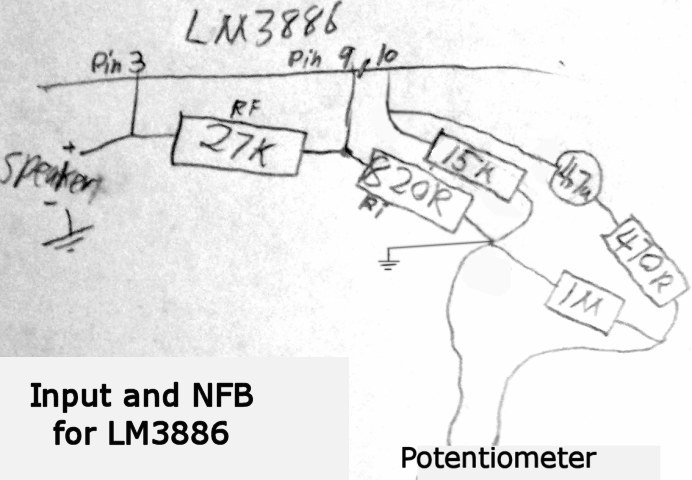

Without source connected, it's a normal reading.
RE: 85mv dc offset into speakers.
I didn't mean to contradict on whether that's suitable for speakers. Its just that my personal preference is "lower than 70mv."
Also, I've noticed that amplifier chips may vary per individual sample. For instance, I've got a pair of matched LM3886's. One does 20mv DC offset and the other does more than 200mv (not acceptable).
Swapping the 22k input impedance resistor for 15k instead,. . . and then both chips were "less than 70mv" on DC offset.
There's a "trick" for DC offset:
(AC coupled, aka fully decoupled)
You can use the optional "Ci" cap at the NFB to prevent amplification of DC.
Reference LM3875.pdf to see the location of Ci.
That forces zero DC offset.
This looks wonderfully easy on the schematic.
However, it may also force a lot of shopping to find a Ci cap for seemly sound. . . eventually costing a tidy sum and a lot of time-consuming frustration. That is why, both Peter and I, wish to avoid Ci. Limricks!! Oh no. 😉
Instead, I'd like to propose this circuit for very low DC offset:
(Shown is LM3886TF)
I've seen noise with 100k pots,
weird muffled sound with 50k pots at some (not all) locations on the dial,
missing bass with 10k pots. . .
and never any trouble from 20k pots.

Notice the padding resistor on the input filter capacitor. That standardized method solves problems from sources attempting to drive capacitive loads, and using standardized methods helps to prevent problems.
Since the point is avoiding problems, a 20k pot is recommended, for general compatibility. Once again, that helps avoid needless shopping. Is it perhaps offensive that a $1 component can do hifi quite well?
