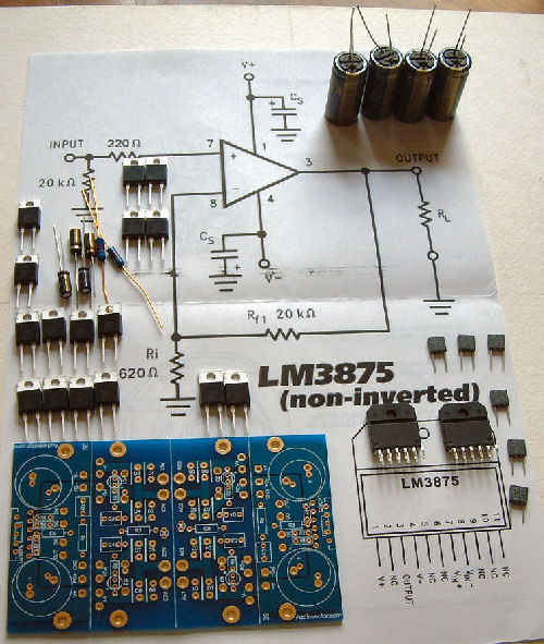

Prevent speaker fires.
You can measure DC voltage output a the RCA jacks of each source (or preamp) used with the amplifier. It should be zero at the smallest scale.
If you don't know. . . or if you plan to plug in more than one source. . . then, the standard practice of a dc block (input filter cap) is indicated in order to prevent a loudspeaker fire.
Let's take the Audiosector board for example.
To install DC blocking:
1). Install a 15k resistor at the spot marked "R2"
2). Install a 4.7uF cap at the spot marked "R1"

I went for a pre amp because I needed a few inputs and I had read conflicting opinions about whether they needed one or not. In fact I had read so many differering accounts of buffered, passive, pot only etc etc that I didn't know whether I was coming or going.
Then I came by Carlos FMs Uno on Decibel dungeon and the line that caught my eye was "will go with any kind of power amp" I guess there are late edwardian steam powered or pedal cranked topologies that it wouldn't suit but lets leave them out of the equation shall we?
It's simple enough to build on stripboard and uses no exotica type components But does have lovely big fat DC blocking capacitors on the outs. Mine worked first time but I should have built 2 of them. I made mistakes in the layout which I wouldn't do the second time. Simple things like just not giving myself enough space in the enclosure and then ending up with a dodgy joint because I couldn't get in with the iron without burning something else, usually me.
Just my own findings and in no way presented as advice!
