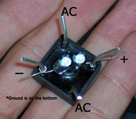

danielwritesbac said:
Howabout this power supply?:
This one is good too, although you might not really need the caps.
Even with my boards, the small caps on rectifier board are optional and it's recommended to assess the sound with and without them.
Even with my boards, the small caps on rectifier board are optional and it's recommended to ***** the sound with and without them.
THANKS MAN!!
Shown is 2 of 4.7uF 50v caps per bridge (just one bridge).
Did I do it up compatible with Audiosector?
I think that its center tap ground connections (all on the bottom) plug in to the CG port on the AudioSector amp boards. Is that right?

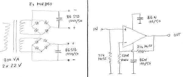

danielwritesbac said:Shown is 2 of 4.7uF 50v caps per bridge (just one bridge).
Yes, that's correct.
The caps were originally BG N 4.7/50 and were intended to add "image density flavour" to standard Panasonic FC 1500/50 supplied with a kit.
After the BG stopped production, and to safe on costs, those caps are no longer supplied with the kits, instead, Panasonic FC 10uF caps are there, mostly to "fill" the space.
Depending on the configuration (how close rectifier board is to amp PCB) and overall signature of a system, it may well be that the amp sounds better without those caps, so try it both ways.
I was later installing small BG N caps only on negative rail as it seemed to give better results.
My present configuration, as used in Patek amp, is attached (please note, that I'm not using input series resistor).

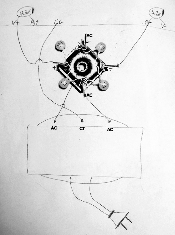

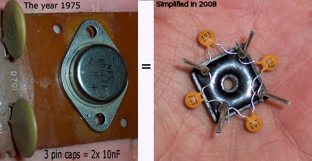

Peter Daniel said:. . . Depending on the configuration (how close rectifier board is to amp PCB) and overall signature of a system, it may well be that the amp sounds better without those caps, so try it both ways.
For that, here's the original "propeller" bridge block implemention from the year 1975, along with its modern alternative. How do you like it?
I think that one could still mount the 4.7uF's at the amplifier board, if desired. The likely connection point is at V+ and V- because of the handy layout. Is that right?
See picture below:
This is easier with the more durable polyester caps, although ceramic is shown.
EDIT: When using this one, CT (center tap ground) goes direct to the AudioSector amplifier board's CG terminal.
See picture:
EDIT: On specifications for this, the AC wires may be up to 7" long; however, the DC wires (from bridge to amp) need to be shorter than 4" length, if possible.
And, for "stereo layout," which is 1 transformer for 2 amp chips, then any wire for the right amp needs to be the same length as its partner, the left amp. Aim for symmetry.
