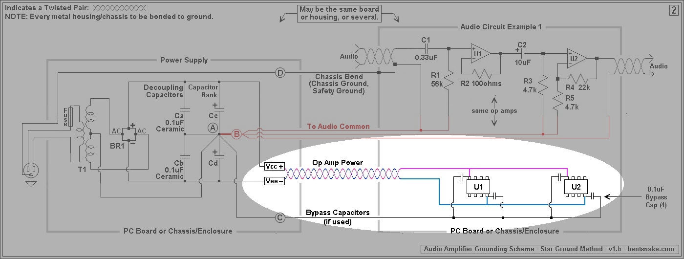

So it's decided that Vee and Vcc are, in fact, a feed-and-return pair, on this there's agreement. As long as you're not too picky about what you call agreement.

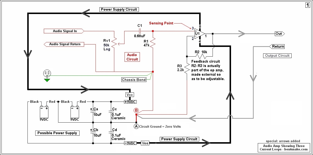

Re-posting the two circuits from post #337, the third circuit here is a further simplification. We find that:
In effect the op amp is a variable voltage divider--a high speed potentiometer.
Line Vcc: current can be anything, voltage cannot change.
Line Vee: current can be anything, voltage cannot change.
"Output Circuit" can be any current at any voltage.
Line "Circuit Ground = Zero Volts" is, by definition, zero volts.
These being the conditions, are Vee and Vcc still a feed-and-return pair?
A nod of respect to rayma, and to jneutron, both of whom did give a passing thought to addressing the question.

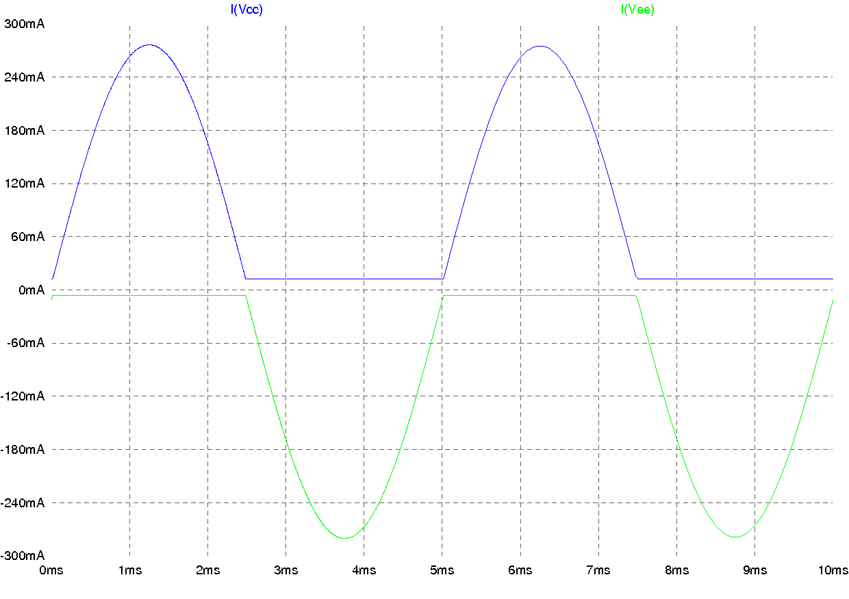

Just in case anyone is confused by Bentsnake's incorrect explanation of the workings of an opamp.
The positive and negative rails are not a flow and return pair. You can see that their currents are nearly never equal.
Same for class AB power amp. The rails are half wave pulses at the OP fundamental with lots of harmonics.
The idealized current flow path is from the conducting rail, out to the load, back to the source and from there back to the main star ground along with the power supply rails.
So, twisting the power ground, load return ground and both supply rails will minimize the radiating area.
