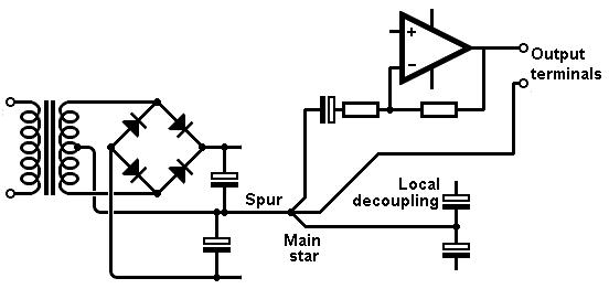

Hmm, then at the risk of showing my ignorance, coudl someone explain why I see this arrangement advised by Doug Self for grounding an amplifier, and not the second version?
EDIT: Looking at it, I suppose it is because the load is so remote that the ground wire leading to the output terminal must be considered an extension of the load impedance.

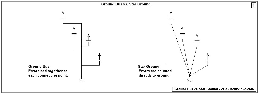

i use this scheme as my guide....my reasoning is that at the junction of the main filter caps, zero voltage is minimum, not affected by current flow in the other wires....
Merlinb, you are okay in my book, i find your writings very helpful and easy to understand.....
I think for a star grounded system, the diagram above is ok.
I use star (nx-Amp, sx-Amp) and T also (e-Amp). Both can give very good results.

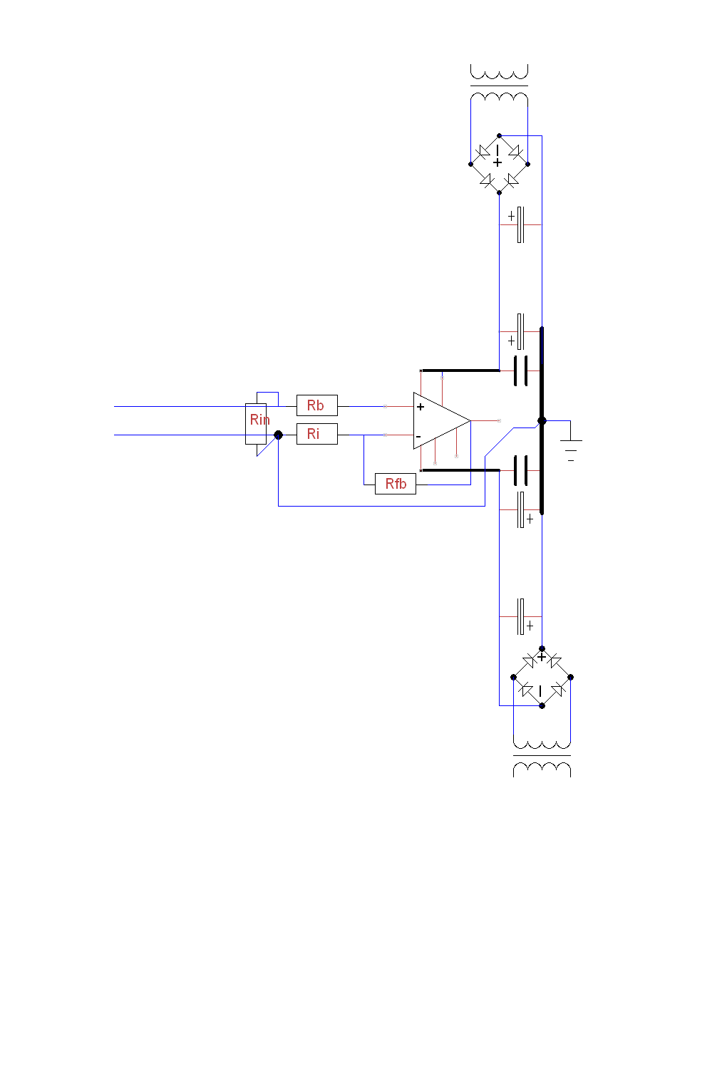

My understanding of which is below:

and the question that needs to be addressed, how much voltage loss in ground conductors is enough to make the circuit deviate from its original function?
the answer to this question pretty tell us how to proceed imho....

The most important thing to consider in the ground connections are
1. the capacitor charging currents - hence the 'spur' shown in D Selfs diagram
2. A star connection off the spur
3. Alternatively, with a 'T' you would connect the speaker return first off the spur, and then the remaining connections - this is how I did it in my e-Amp
You need to stop designing the layout as if it were a solid state amp. The ELEKTOR LM3886 design from 1995 is quite bad because the layout resembled a SS amp. Grounding, decoupling and inputs are just not good.
It take another 5 years before Labs 47 design a highend version of a chipamp and they do it by designing a layout, not by using better parts.
If you study their layout you can see that they have abandoned the methods of previous (SS) designers.
They do not whine about "ground is a ground" or "If two ground return lines tie into the same path at different points there will be a voltage drop between them". They design a layout where this does not happen and so can you.
It take another 5 years before 47 Labs design a highend version of a chipamp and they do it by designing a layout, not by using better parts.

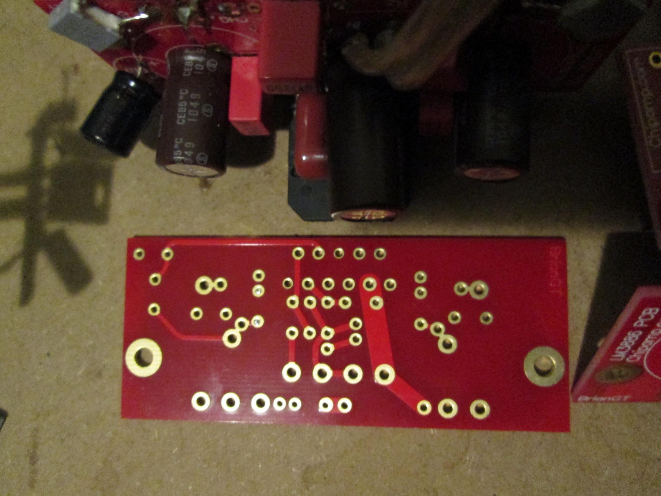

Now, there's one proven PCB design out there and it's totally upped the ante in the field!
I'd love to see some testing and advice on improvement since I bought a big stack of these when they were on sale a couple of years ago :
http://www.diyaudio.com/forums/chip-amps/258372-ive-upped-my-chip-capacitance-up-yours.html
That is also the FetZilla PCB layout.
The rectifiers+smoothing+decoupling are all on the Power Amplifier PCB.
The FetZilla layout causes excess output noise.
They are the noisiest Power Amplifiers I have ever built and I'm convinced it's down to the big loops in the DC power supply routing.
I was never able to cure it.
The amplifiers are effectively redundant.

I'd love to hear solid advice on how to cut 'n' strap to improve the layout. I got a stack of the BrianGT3886 / chipamp.com PCBs a couple years ago, when they were on sale ...
You see, I'm not just a critic, I'm a ... customer! 😉
See the BrianGT3886 / chipamp.com manual:
View attachment chipamp.com BrianGT lm3886-manual.pdf
It is not only loop area that is important but the inductance of the path from chip output to chip input.
