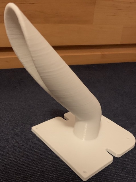

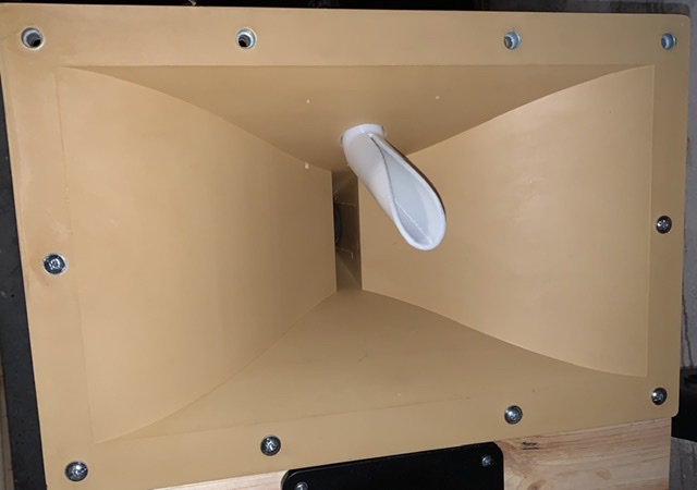

The bent K-tube did print pretty well.

So the bent tube is installed in the horn. The angle looks much better now. I do not expect any great results, so I hope for acceptable. It is a fun project anyway. Measurements will be made tomorrow if work permits.

it will be interesting to see if that mild bend works well or not vs say a bent horn.

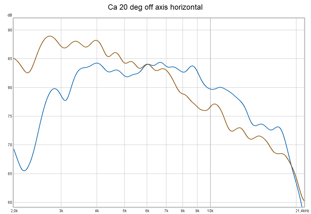

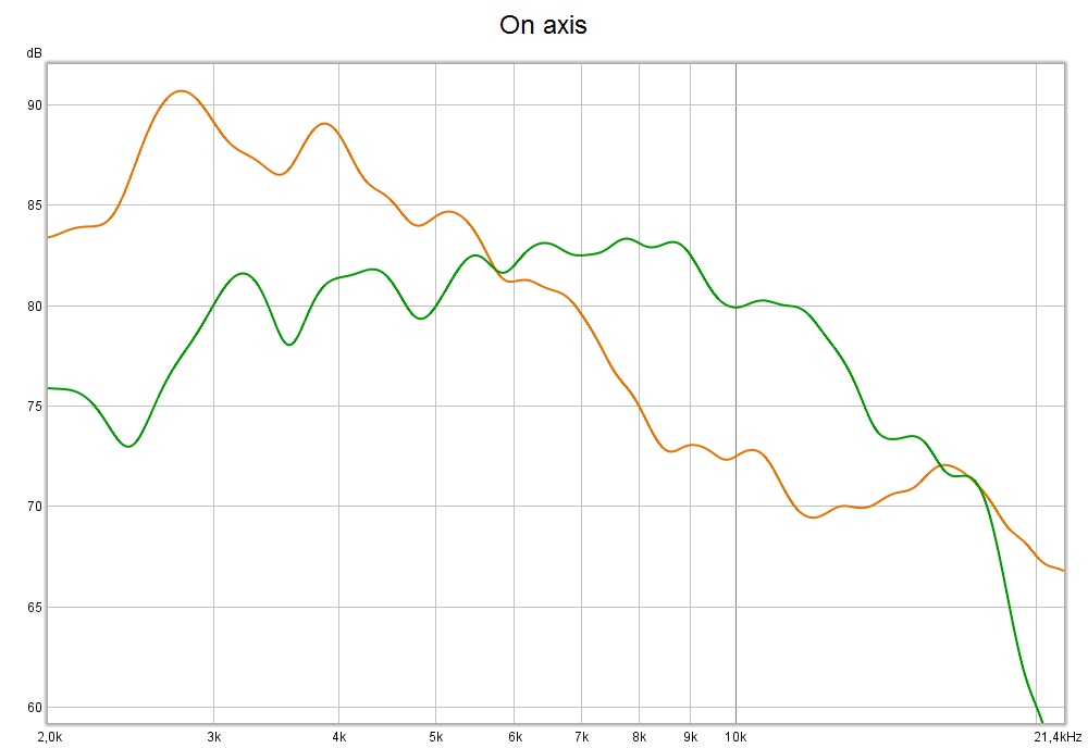

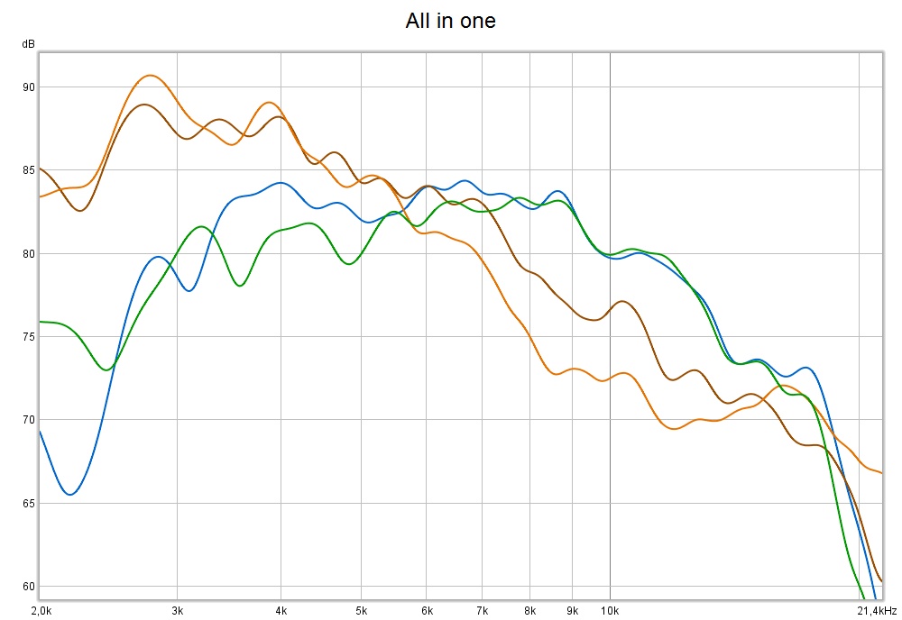

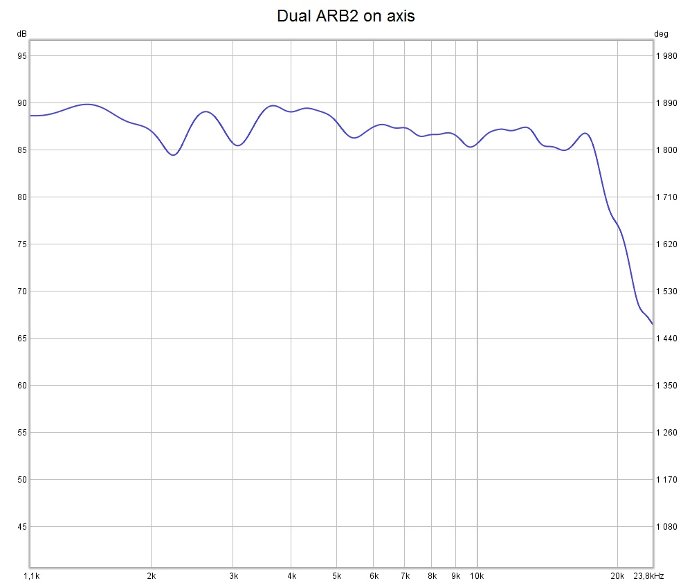

But I have some results with the bent K-Tube. And I think the results are quite interesting.
Again, my measurement techniques are far from perfect, but I tried to catch some trends in there. All plots are gated at ca 2.5 ms and 1/6 oct smoothed. The first one is on axis horizontally and roughly at the point of the K-Tube vertically at around 1 meter distance. The second one is at the same height but ca 20 degrees of axis horizontally. The third one is the two previous combined.
If I read that correctly, it seems to work and the bend does not have too much influence.

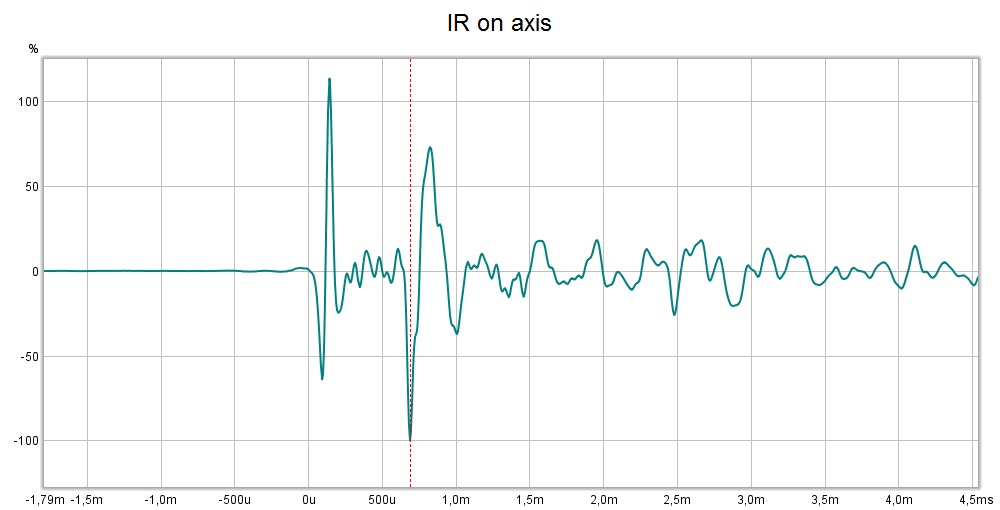

The IR shows that the mids are 0.65 ms delayed behind the HF (and I am not sure if the pulses are the same polarity or not). I will try to compensate the delay with DSP at some point.
As a conclusion, I would say that with a bit of EQ in the top end, this should work well and most probably even better with a smaller diameter tube. And it seems from all the measurements I made that in the HF, the K tube should be listened to almost on axis with the slot pointing up (or down ???).
The last picture is the same drivers on ARB2 horns and physically aligned with passive XO as comparison.

Actually, with this mechanical configuration, the mic is aligned "straight down" the long axis at 1 meter. It seems as the K-Tube has a constant-directivity like falling FR. Subjectively, there is enough HF in the room, so maybe not much boost would be needed. I am now not set up to run music through it and will not be for a while. One thing I need to try out is having a large XPS baffle around the horn flush with the front.

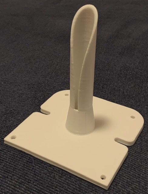

So one of the slimmer tubes is printed. I hope I calculated and measured right🙂
Now when the horn is drilled also from the other side, I will have three configurations to try out - that will be a mono test on my K15 clone - not only measuring, but also listening. Straight, bent and dual tubes with dual compression drivers. The K-Tubes are really interesting devices🙂
