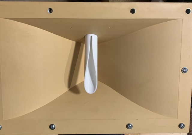

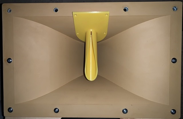

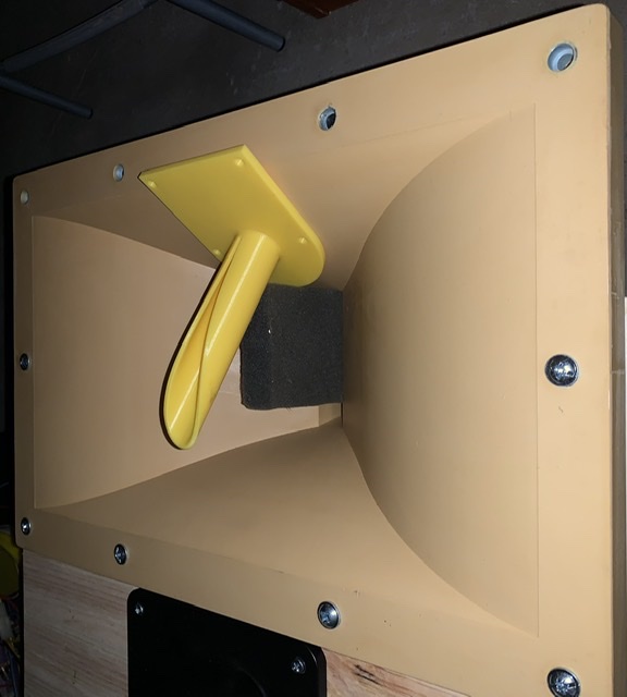

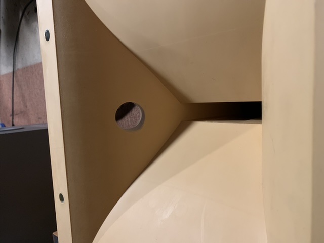

There are not too many options of how to install the K-tube of this size. Of course, the mounting plate will be outside and the foam is just a support for taking pictures. It seems when I place the tube as close to the mouth as possible to fit the HF driver, it should be just about the right length and angle based on previous experience. It will be some fun to drill the hole properly...

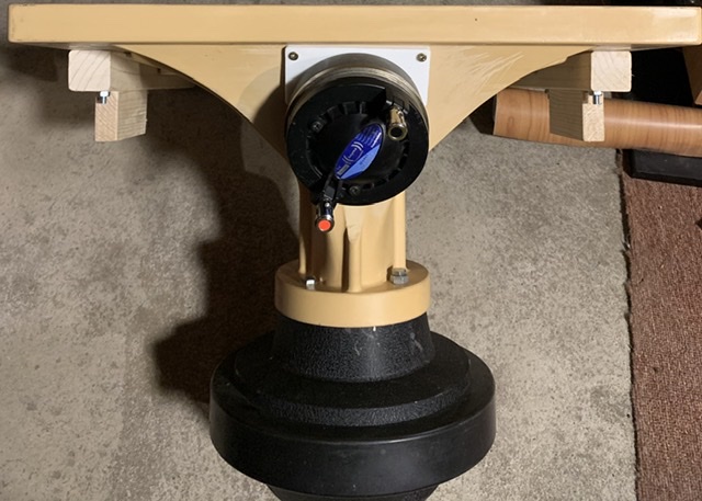

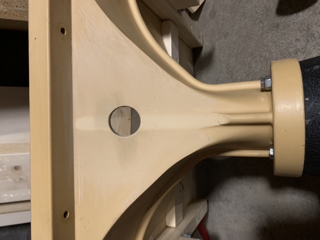

Beyma CP385/Nd, since that is what I have at the moment and it is really good. And JBL2445 for midrange. A hole is drilled and new K-Tube with updated dimensions is being printed🙂 Drilling the hole was quite easy with a 32 mm hole saw. The material is easy to work on.

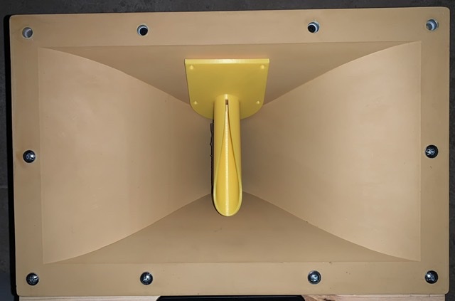

So the K-Tube is printed and installed in the horn. I could not resist and made some measurements on axis. I will not show them yet, they make exactly zero sense to me. I need to do the measurements outside, inside my cluttered workshop it seems not to work. Subjectively, the tube seems to do something and the HF in the far field is extended, when playing both together. The tube inside the horn does not seem to influence the mid driver response much if at all. The tube response is falling at a similar rate as the mid, but higher. That would indicate that the chosen angle is way off...I hope I will have a chance to measure outside tomorrow. Unfortunately, a different angle will be very difficult to do.

Yep, wrong orientation - I did measure some more and that proved the fact. The Faerber Acoustic speaker has it right. Back to the drawing board🙂 The bad news is that there is not much space around the horn to fit in the Beyma. So most probably I will need to get a smaller driver or finally order a pair of VIFA NE19 tweeters. The 2445s are sensitive as hell and even the Beymas need something like 4 dB boost in voltage (they are 8 ohm nominal, 2445s are 16 ohm nominal).
That also means it will most probably not be possible to align the K-Tube in vertical position fully - as it is the case of the Faeber speaker.
I thought about bending it, I think I should be able to do it in 3D and the printer would definitely print it, maybe even in one part. But I am afraid of introducing interference from the bend. How about making a reflector instead? So the bend would be sharp?
The easiest way will be to model both and print. Definitely easier than drilling the horn at a steeper angle🙂 The K-Tube of this size looks quite good above some 4 kHz. Verically it is almost flat within ca 30 - 40 degrees. Horizontally, the dispersion is somewhat wider, acceptable almost to some 60 degrees. These are all estimates based on some measurements and my ears🙂
