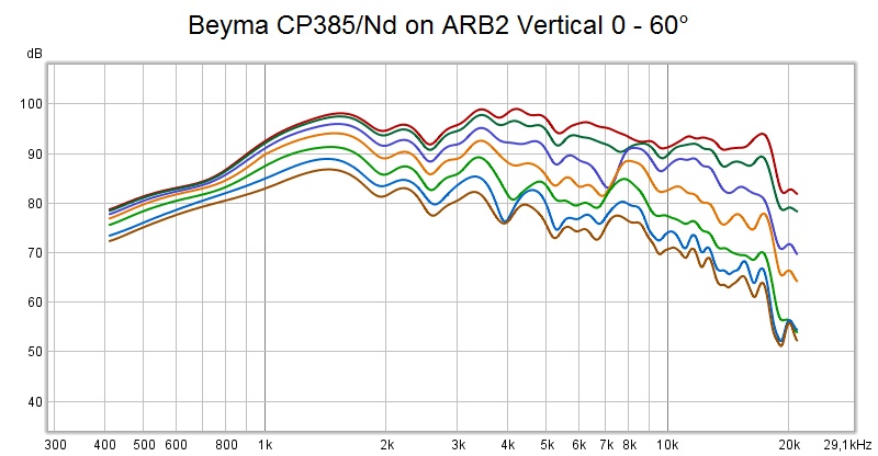

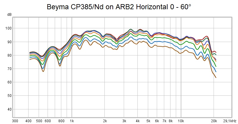

It could be that the reason the large comp sounds bad even when EQ'd is the diffraction slot in your current horn. I haven't personally listened to horns with such 'hard' diffraction features but other people complain of 'frying eggs' noise especially at high output. Have you tried it on a more modern horn design? perhaps biradial?
I think it sounds bad because it needs really large boost for the HF. I have no problem with the sound of a Beyma CP385/Nd on the same horn.

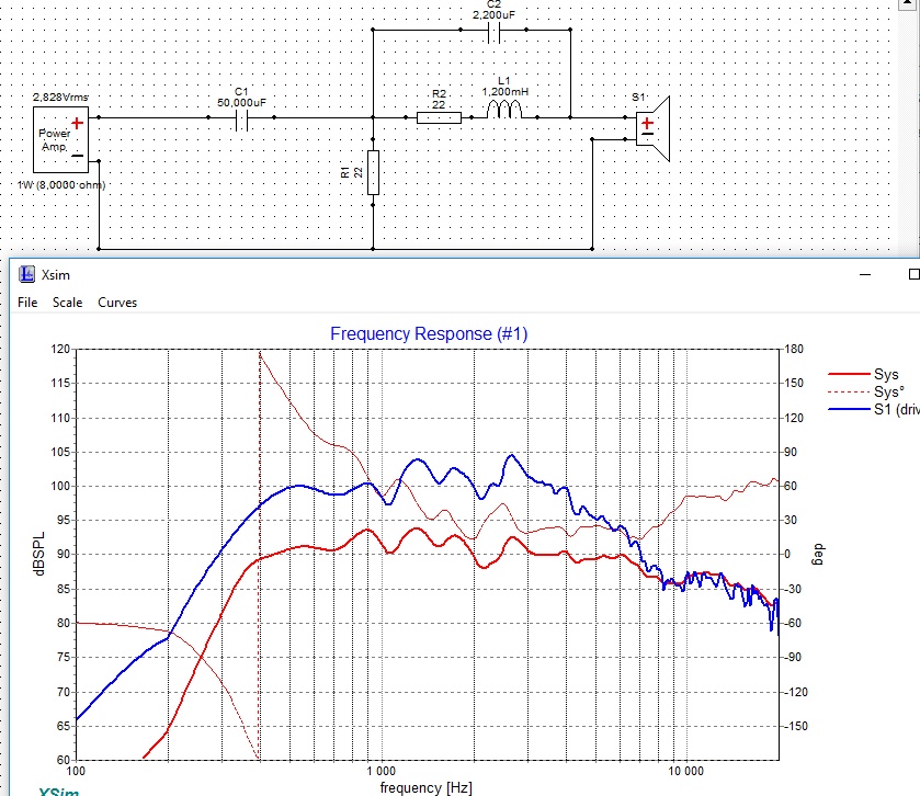

What kind of processing are you using to apply the boost? perhaps you loose too much dynamic range or have clipping or numerical instability. There is nothing intrinsically wrong with large boosts but a lot can go wrong, for example using IIR filters the coefficients need to have a high numerical precision.
This is one of the reasons I use a passive crossover on my comps as I can include most of the EQ in that crossover so don't need large boosts in the digital domain and improve dynamic range.
The boost is via Thomann DSP 4x4, the output had still tons of headroom - but maybe the result would be better with passive attenuation instead. I will definitely need to try that, too.

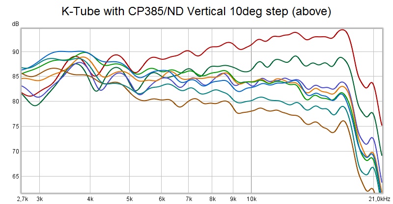

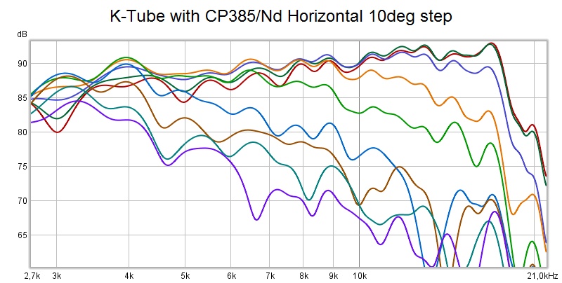

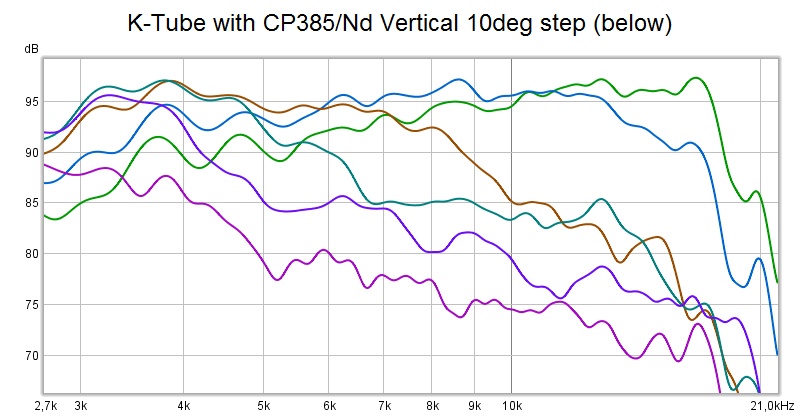

I revisited my K-Tube measurements and I shortened the window to take out the first reflection. Above means the part without the slot. I do not think I can resist sticking the K-Tube into the horn now
The main point as I see it is bringing the output closer in the vertical direction, which would be my goal.

The Thomann DSP is a quite low cost unit I would guess it uses fixed point processing so I would try a basic passive network to equalise and then do the 'fine tuning' in the DSP. Even if its floating point (which avoids the problem of accidentally digital clipping in the processing pipeline) its probably only 32 bit which isn't sufficient precision for high Q IIR filters. If you open it up you will be able to see the DSP chip it uses and the data sheet you should be able to check this. You could also try as a quick fix to split your overall EQ into half boost and half cut and/or trying to use low Q PEQs.
The way you could actually test your DSP is to put in the EQ you want and measure the response using REW, comparing it to what you expect to get. They should exactly match if they don't you have issues!
I'm using a Symetrix Symnet 8x8 DSP, they are sometimes available very cheaply and have a 40 bit floating point data representation (enough for 24bit data), they use multiple xilinx spartan 6 FPGAs for processing the audio data.
I revisited my K-Tube measurements and I shortened the window to take out the first reflection. Above means the part without the slot. I do not think I can resist sticking the K-Tube into the horn nowThe main point as I see it is bringing the output closer in the vertical direction, which would be my goal.
Looks great! the K-tube should also have minimal interaction if put in carefully, I would keep it away from the diffraction slot.
