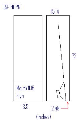

Freddi, here's the sketch.
I've spent a few hours trying different combinations of the mouth/throat/length. This is the best I could come up with considering my goal to cross it with my Unity at 300Hz. If I am not happy with it, I might try a Karlson mouth see if it gets rid of the spikes from 100-300Hz.

thanks JSS - - -are those (15.14, 13.5 & 72) external dimensions? what are the gap distances at the divider to inside top and front? seems like reports of observed TH excursion are lower than simulations - if so - why? - Freddy

Freddy, they're outside dimensions, using 1/2 material. Front and top are 7" internal. Can't wait to get done and fire this up!

thanks Jeff - 4012's overhang is probably 4.8mm (?) so you're using 9-ply 1/2 birch? - cant wait to hear how they play and whether theres any panel flex . Will your Unity have passive xover to the subs?
