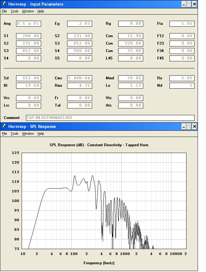

JSS said:Hi Freddi,
I have a Magnum12HO that I am currently building. Yours is a newer version of my driver, I plugged in your specs to my horn and response is actually a little better. All in a 13.5x15x72 inch box.
Jeff

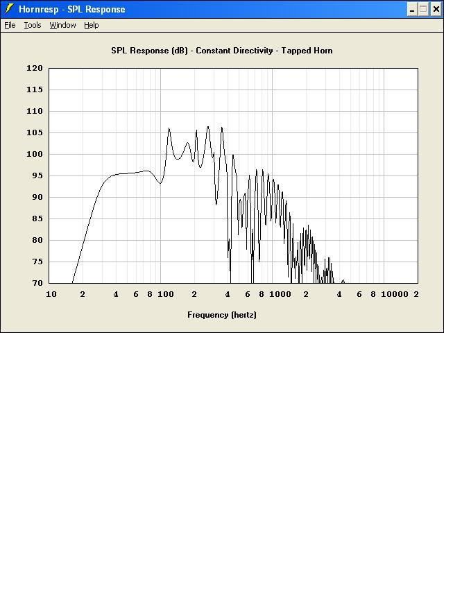

hi Jeff - if you get a bit of time would you post a sketch or send one please? I"m not seeing things very well - also - might you run the sim in 2pi ? - -Best Freddy
Freddi, here's the 2Pi, I scribbled the dimensions on paper, will look for it and post.

than you so much - looks strong even in half-space - - did you make comparisons to 7ft pipe in the same footprint and come up with 6ft as best compromise? wonder what a k (or Fulmer) opening would do to its response other than possibly shorten the path? Best, Freddy

The results look good tho. I've seen a few normal horn designs for this driver, namely BFM's Tuba30 and Tuba36's designs, and it looks like a tapped horn can achieve similar results in smaller box... 🙂 I think the fact that the 4012 is already used in a horn design shows that it is a good driver for this sort of thing... high Fs, good xmax, etc.
wonder if 4012HO's acutal overhang = 4.8mm and the figure has been pumped up to 6.2? are there drop-in drivers for this horn which have more xmax? - where would 4.8mm peak limit at in-room and in practical terms?
btw since this 72"x15"13.5" cabinet is in the same size range as Fitzmaurice's "Table Tube" heres a sim of that in AJ
