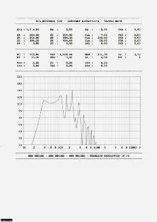

Built my other trapped horn today.now I have STEReO sub
here is the curve from Hornresp.
Its the best I could do with this driver (Perless Resolution 10) in 20 tryouts...?
I wonder if someone with experience of building these type of horn could tell me if it looks OK?
I sounds ok ..the peaks above 100hz is not disturbing and for the moment I have 2 conical pipes with a 6db lp passive filter at 50hz and for a room 60m2, I only use 1W and 10W at the peak.

Here is the "hornresp" curve
it is roughly flat from 30hz-100hz as far as i can make out

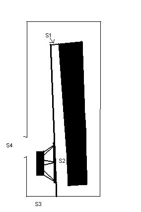

Wow the thread has become so Big ! After reading a few posts of those who have built this sub i am very interested in building this sub.
May i know which S1, S2, S3 ,S4 and the con ? It would really help if someone could point where or draw on the pic below to show where these lengths are in a tapped horn.
1. In the above pic is S3=L34 ?
2. Where is S4 suppose to be ?
3. S2 is the length from the back of the cone to the opening right ?
4. The blue line which is L23 is it suppose to be parallel to something and the how is the angle of the part indicated by pink arrow determined ?
Hi Buzzy,
are there missing labels?
I cannot see L34, is this from Rademakers' link?
Compare your diagram with Rademakers'.
We can see that at the middle of the horn path jast at the end of the dividing mid panel the sizes to each side of this baffle are very different between the two diagrams.
Look at Rade's, on the cone side the gap from baffle end to side panel is less than the baffle end to end panel.
The gap from baffle end to end panel is smaller than gap from baffle end to side panel with the mouth opening. i.e. as the sound wave goes around the corner the cross sectional area gets a little bit bigger to match the expansion of the rest of the route.
In Buzzy's diagram the cross sectional area appears to get smaller as the wave passes around the end of the baffle.
The reflectors should bounce the wave around the corner. They are not intending to maintain cross sectional area. At the very end the two reflectors should meet in the middle and be placed at 45degrees to the end panel (90degrees to each other). But in a horn where the expansion rate is fundamental to the operation of the wave flow this "normal" rule may not apply. The only way to test if constant or expanding cross-sectional area applies or if the reflector rule applies is to build a prototype and listen if the effect is audible.

Hi Buzzy,
hopefully someone will draw a diagram for you.
s1, 2, 3, 4 are the areas that are input into Hornresp at each change in taper/expansion rate.
s1 is at the start of the taper.
s2 is at the cone throat.
s3 is at the mouth where the other side of the cone sends it inverted phase pressure to join up with the delayed pressure wave that travelled along the horn.
s4 is the exit mouth.
Look at the distances in Hornresp.
s1 to s2 is very short. (Rade's diagram= L12)
s2 to s3 is long (R=L23)
s3 to s4 is short (R=L34)
Have I got the description right?
Should we break the taper up to show the discontinuous expansion around the bend/reflector?
