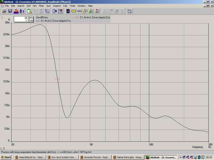

Hi Marcello,
My measurements of excursion are peak to peak values!!!
I will attach here the excursion graph for 4 LABsub halfspace at 85Vrms based on my AkAbak modell...
You will see, this is very near to my measured Xcursions, but mainly below 40Hz there is a big difference! (Akabak shows nearly double Xcursion than in reality around 30 Hz)
Btw. the Tapped script I saw here was not giving me the same results as my own scripts, which is basically the same, but takes into account the folding of the horn segments....
Thanks, Tamas

Hello Tamas,
Indeed your simulation shows realisticer than my predictions.
What is the script you used? Could you also show me the simulated freq. respons corresponding to this excursion plot?
I am curious about your input script of the foldings and if this is the the only difference with my script. I remember from an old post of TD that when keeping bends/parrallel walls small compared to the wavelenght and keeping the same internal horn volume (when is was straight) don`t make a difference in acoustic measurements.
PS; How does it that your predictions shows peak-to-peak excursions?
Marcel
My prediction shows peak Xcursion, not peak to peak! My measurement ( Zip file see earlier post) Shows however Peak to Peak values due to my measurement technique (see Laser geometry)
I attach here the Frequency response zipped together with the script in Wordpad.
Best,
Tamas
PS.
Try to model an 1 segment basshorn and a folded one in AkAbak! you will see the difference.
Furthermore I did integrate all the dimensions into one bigger horn in order to get more precise results instead of model 4 systems of one LABhorn!!!
