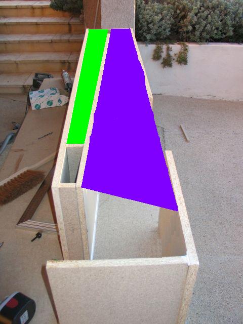

Thanks Oliver, that does look like the stuff in the commercial tapped horns, but I'm hoping to avoid a trip to the city for this. I think I can find some old blankets to rip up that might have batting if I need to.
Thanks again, jbell. That stuff does look like what I have, and I'm not particularly concerned about it soaking up too much, I'm only worried about the apparent size of my throat once it's in there.
I'm probably not going to line all 4 sides of the entire path anyway, it's too much work and doing two opposite sides should be almost as good. I can probably separate this underlay stuff into two 1/4 inch layers too and then only do 2 sides, I'll play with it and see what feels right, fibreglass vs thin layers of wool underlay vs batting (assuming I can find some).

You guys answered while I was typing, so I guess that one vote for fibreglass and one for batting. Thanks GM and littlemike.

Guys,
many thanks for all your answers.
As often the devil seems to be in the details.
Unfortunately, I only do have a short week-end ahead of me, but I will definitely try air-tightening the thing better and augmenting the driver opening... I will probably end up gluing everything together which will make experiments more difficult but at the end of the day, it is just 20€ of wood...
I will keep you posted with my progress, most probably early next week now.

Re: Re : Ceiling tile
But don't you have to account for the lost Vb due to the backer's high density? Not a big deal in a large cab, but some of these THs are tiny in their early expansions. Regardless, seems to me Bob Brines does this in his TL, MLTL designs and it seems to work well.
GM
mwmkravchenko said:It's easier to use the white side of the tile as a backer to glue the fiber glass to the side walls.
GM

Re Re RE Ceiling tile
Hi GM!
I can't say for certain that the space occupied by the fiber glass would account for a loss in the horns apparent throat volume. Looking up the STC rating of the normal 1/2 " fiberglass you get from .5 to .7 the number 1 being totally absorbent. This is frequency dependent as an absorptive layer starts to work at 1/4 wavelength of the thickness of the absorptive panel. If the panel is 1/2" thick it will begin to work around 3.4khz and up. Looking at a normal enclosure that we add fill to then the actual end result is an apparent net gain in the acoustical size of the enclosure. And if applied correctly as I think it is done in the Danley subs it reduces the high frequency peaking that we are all simulating and some are measuring. It may even be acoustically transparent over the passband we want out of a sub.
Hi GM!
Greets!
Assuming we're talking about the same kind of panels, others have told me there's some volume loss, not gain, as would be the case with fiberglass insulation, polyfil, etc. as long as it's not too densely packed of course. I assume the batting DSL uses falls in this category.
Yes, from the various plots it appears there's considerable initial damping, like in a high gain pipe horn.
GM
GM
