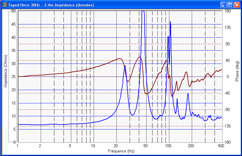

jm_kzo said:
Hi littlemike,
here are the impedance measurements...
Some answers (as much as I can)...
The top of the cabinet was screwed and I used foam joint (you know, for doors and windows) to improve sealing...
I do not really know if my measuring equipment is accurate. It is a Panasonic WM-61A mic and a "Eric Wallin" v2 preamp, but it never got calibrated. Can it be that off ?
I can borrow a digital SPL-Meter at the locakl Home Depot, would it be better ?
No response weighting either, how do you produce this ? Calibration ?
Yes, I am measuring indoors.
I think I will be Ok with the French version of Freqresplot![]()
I have measured with REW and SyncRTA as well, measure more or less match.... unfotnately..
Thanks for your help.
@ jm_kzo
I ran a quick simulation with the values you posted - the frequencies of the impedance peaks you measured correlate well with the predicted peaks, though the magnitudes differ somewhat.
Any air leak from the high pressure side to the low pressure side or the outside - no matter how small - will alter the bass response.
Ask me how I learned this.....
![clown :clown: :clown:](https://files.diyaudio.com/forums/images/smilies/clown.gif)
Interesting that the lowest impedance peak is modeled as having the highest magnitude, yet has the lowest actual measured magnitude. Is there any damping in the cabinet? If not - this may indicate a leak. I'd check with the smoke from a candle or match with a 25 Hz sine wave playing (at the first impedance peak). Check your access cover and your external joints.
I'd suggest that you try an outdoor groundplane measurement with 2.83 V at 1M as others have suggested. Swept sine measurements work better for bass frequencies than impulse measurements do. Your mic capsule is the same as mine, though I am using a modified Radio Shack Analog SPL meter as a preamp. I'm pretty sure the capsule is not your problem, and if your preamp is built as Wallin designed it, I'm sure that it is flat too. I'm assuming that your soundcard is calibrated with a corrected flat response curve so that should not be an issue. The absolute SPL is of no concern here, as relative SPL is all you need to evaluate performance.
You might also consider moving the sub into a corner and checking the response in the room (which is the response that matters anyway).
For permanent construction, I use a polyurethane-based construction adhesive, as it expands and fills gaps very well. I use closed-cell foam weatherstripping as a seal for removable panels and lots of screws, but often have problems getting an effective seal with any removable panel.
I can't think of anything ATM that can cause just the first peak in a TH to be well damped except an air leak. For sure it's not the < Sd driver cutout, though I agree that with rare exception it should be Sd (or larger if the driver can 'slap' the baffle at high excursion).
Never got around to trying the Wallin jig as too many folks had problems with getting them to work correctly, but your impedance measurement and close response match to the sim in its BW above driver Fs implies it's probably working well enough.
Typical SLMs OTOH roll off down low, so unless they have them periodically calibrated to be flat down to at least 20 Hz I would assume not enough to matter, but then your comments about lack of bass and high drive level required also implies an air leak, so if it were me, I wouldn't bother trying to chase down any other possibilities until I was sure that the TH was airtight.
On the cheap, you can get a RadioShack SLM and calibrate it per EW's tutorials.
SPL weighting should be selectable on the meter, so set it based on the type of signal.
Anyway, thanks for sharing and looking forward to an 'airtight'

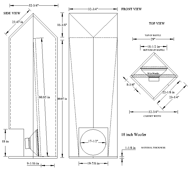

carpenter said:Just though I'd post a pic of my 18" tapped horn:
Not your basic rectangle, cool! Details?
GM

Here's the dimensions:
GM
I did an interesting test: I tapped on the cone of my 18" driver loaded in a bass reflex cabinet. The tone is deep, muted. I tapped on the cone of a copy of the 18" driver loaded in my tapped horn. The driver in the horn sounded like a drum skin on a large drum with twice the SPL.
