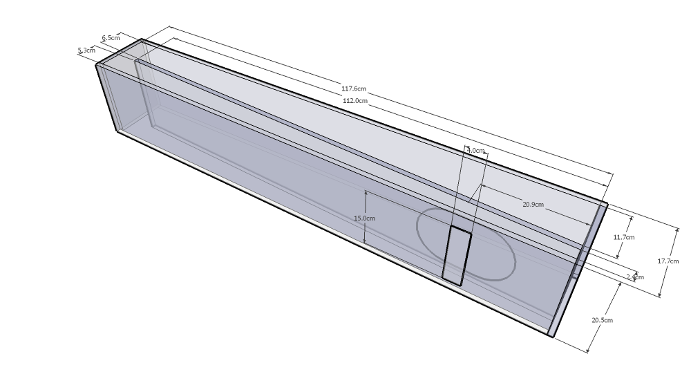

Hmm, maybe I'm missing something, but your dims neither matches up to your proposed design or to using 0.5" thick material. Also, there's currently no way to sim the reflection from the driver to a second closed end and back to the terminus. My SWAG is it will cause some peaking on the low side (FLp), in theory requiring more stuffing, though the vent area is > S4, so it may balance out.

Well, I upsized / tweaked it slightly when I drew up the sketch (in part for slightly better efficiency and in part to allow me to add some bracing). I'll post the updated hornresp data when I get home (computer is currently sick with a virus, need to deal with that first)

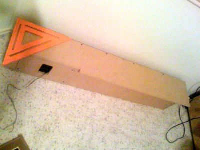

Regardless, I haven't sealed it up yet or finalized the amount of bracing but from first impressions, I think this one is headed to the dumpster, sooner or later, unless something improves (read on)
Preliminary testing involved placing the cabinet open end down on the carpet ( and having someone sit on it ) to provide a temporary seal. I seemed to be hitting or nearing the limits of the drivers excursion somewhere around 30 Hz, as GM predicted . Stuffing seemed to even out the bass a little bit . I was maxing out the gain on a 100 W / 4 ohm sub amplifier at that point, so I'd estimate somewhere around 50 W input or so. Bass is useable to about 30 Hz in room, and I can sense output down to the high 20 Hz region.
My other main gripe is that this particular design is too quiet (8 ohm impedance is probably to blame a good deal),.. but even otherwise, with the gain on the preamp and sub amp maxed out , it couldn't keep up at all with my OB line arrays, even at below normal levels. I finally had to substitute in a dinky little satellite speaker to even get any subjective impressions. This is compared to a Table Tuba loaded with an 8" MCM which doesn't even begin to sweat at that point. However, different animals so , .....
I'm hoping that sealing up this box will eliminate any leakage and allow me to truly evaluate the potential of this one, esp. with regards to excursion. If the excursion issue is solved, I can use one of solid state grunt amplifiers to generate more output
That apart, the bass seems to be non-resonant and smooth ,. both good things

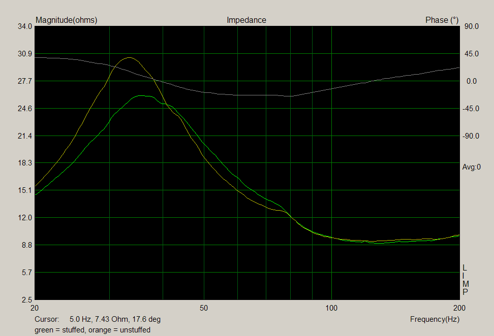

Stuffed vs unstuffed impedance.
The curves look too smooth to be true. I verified the results with both ARTA and WT3 with similar results. I've measured a few horns before and they don't look anything this smooth.
I'm guessing sealing the box against the carpet is creating a highly leaky situation so I'm measuring something more akin to a lossy / aperiodic enclosure. Time to add a few braces and seal her up before reevaluate / remeasure .

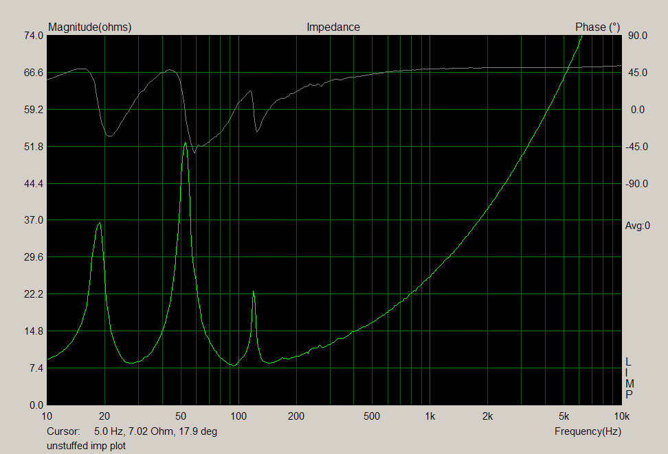

sealed it up. MUCH better. I still don't think it's going to displace my other horn (yet) but not bad at all this time. Bass is solid to 30 - 35 Hz and seems to taper off below that. Excursion is better controlled than before I sealed up the top of the "coffin" 🙂
I haven't had the time to play with stuffing (I'm curious and will try that soon as time permits) but here's an impedance plot. As soon as I get the chance to recover the orig. hornresp. data, I'll post the predicted hornresp impedance plot too.
