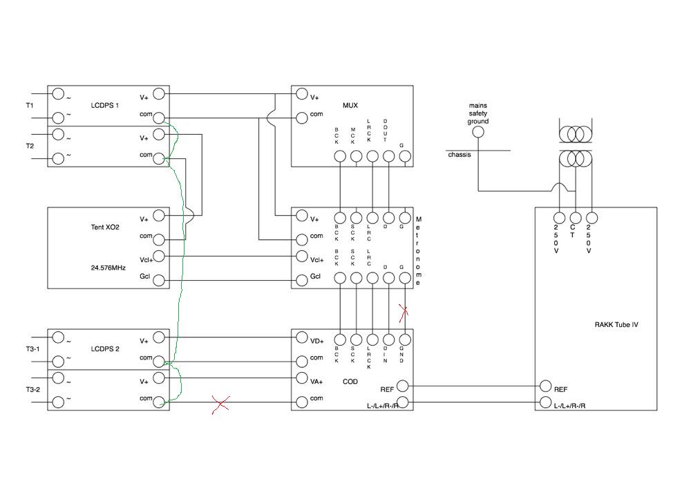

JeroenR said:Can someone please take a look at my wiring schema? I'm not too certain I got it right....
Are the modules connected ok and is the grounding ok?
Thanks!!!
Jeroen
Anyone? Please?
Before I do the wrong thing with my iron today... 😀
Thanks,
Jeroen
BrianDonegan said:I would join the two LCDPS GNDs at the supplies, then run a single ground to COD (they are both joined on the COD board). Also eliminate the I2S GND from Metronome.
Hi Brian,
Thank you for taking a look at it.
Why is joining the grounds at the PS better than joining at the boards? Is it preventing from current flowing between the boards? I sort of concluded that was not possible as the boards do not share a common. Is there current flowing through the I2S lines?
Thanks,
Jeroen
Just ground loop prevention. You would likely have no problems the way you had it. If you use the terminal blocks, you can pretty easily try it both ways.

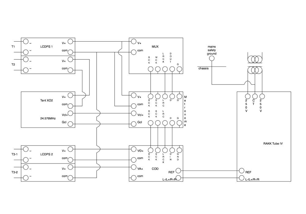

I soldered the boards, tomorrow I'll test with just some passive IV before I install the RAKK IV. Below is the adjusted schema, I did not add the clock to the common so it is isolated from the rest.
Jeroen
I think you will want to link the grounds so the voltages will be relative.
The ground from the Tent clock-out is connected to the Metronome clock ground pad...
That is fine, they will be linked there.

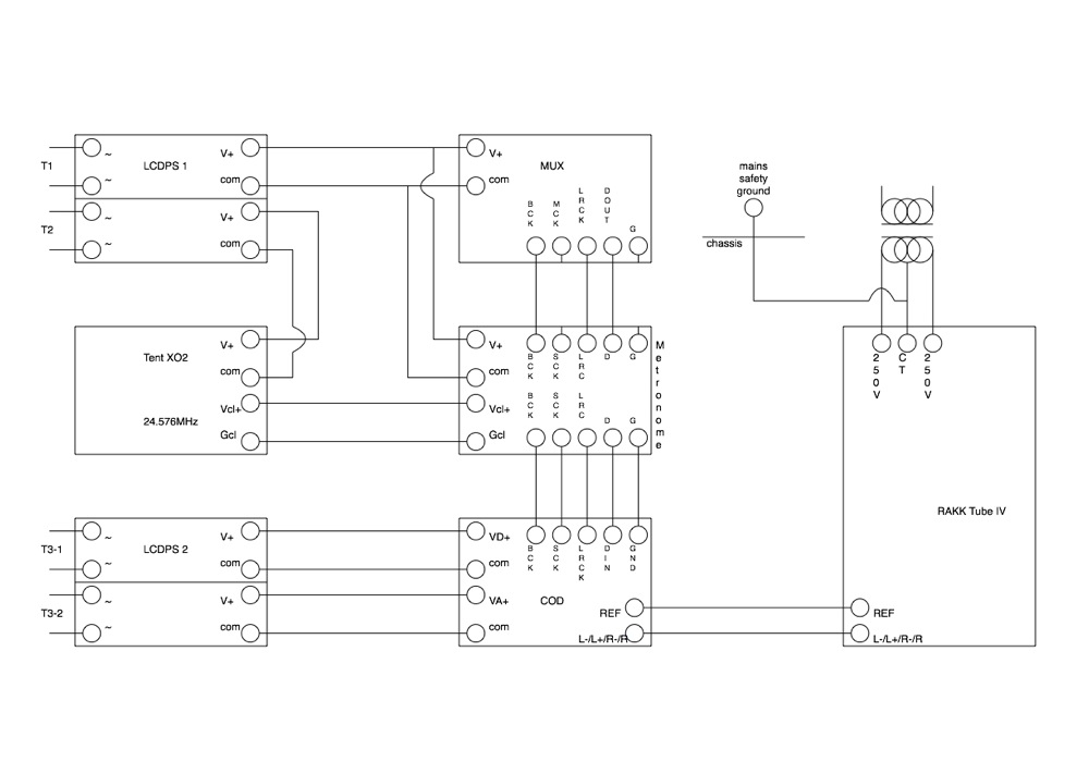

Jeroen
It works. 🙂

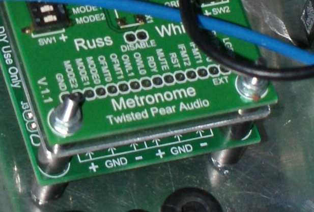

One weird thing though... The COD and Metronome are stacked. I thought it would be wise to add some shielding in between so I added a 1.5mm alu plate (see photo). This proved a bad idea: every time I touched the chassis the sound disappeared...
Anyone knows what happened? The alu shielding/plate and chassis were in contact through the screws but there was no ground/common from the circuit connected to the chassis???
