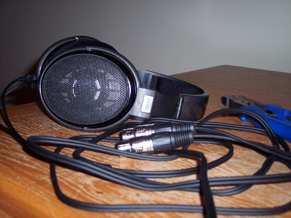

driving balanced heaphones 🙂
So I took a HD650 cable and modded it for balanced XLR.
I am driving it directly from the ballsie. It does not seem o have any issues driving the 300ohm load. Though, ultimately it will be a new balanced head amp driving the cans. 🙂
Cheers!
Russ

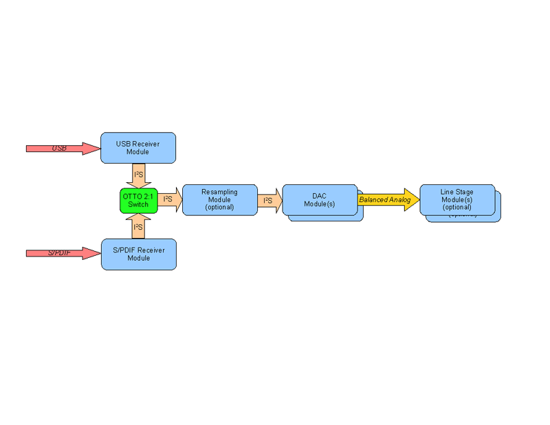

Sure. 🙂 This is the setup:
WM8804 -(I2S)-> Metronome-(I2S)->COD-(balanced I-OUT)->TXD/IVx2-(balanced V-OUT)->JTx2-(attenuated balanced V out 750R output impedance)-->Ballsie-(LPF single ended and balanced OUT 10R output impedance)--> jacks.
I have been using the metronome at 96khz/24-bit I2S out. The reason is that it just seems to sound better to me than at 192khz. I think its because the chips (both Opus and COD) do better filtering at 96khz than at 192. Also I think the better SNR at that sample rate may play a part.
There is one LCBPS that supplies the ballsie and the pair of TXDs.
There is one LCDPS that supplies the rest. One regulated voltage for the DAC, the other for the metronome and the receiver.
I am using just the basic JT controller which has it own power supply.
I use two dual secondary toroidal trafos. One powers the analog LCBPS on its own. The other powers the JT and the LCDPS. One secondary powers both the JT and one side of the LCDPS. I use this secondary on the same side of the LCDPS that powers the receiver and the metronome. The other secondary is for the other side of the LCDPS, the DAC side.
At some point I will add an OTTO and a USB receiver.
Cheers!
Russ
