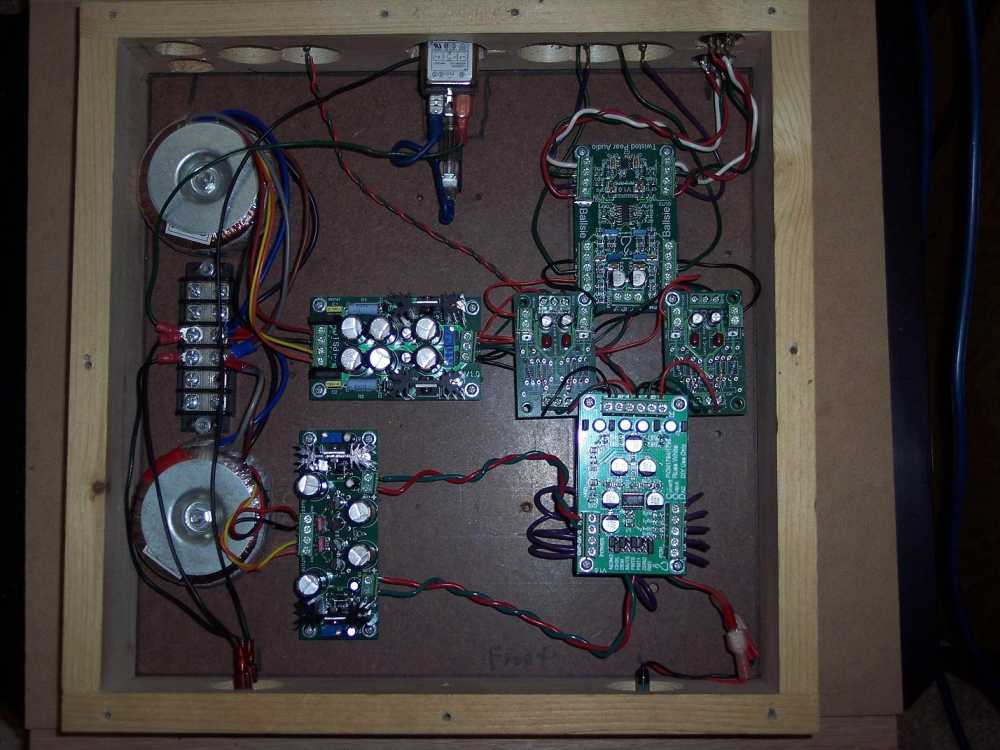

I have been listening to the COD now for a few weeks. Mostly with the passive I/V (270R resistor) into the ballsie. This sounds very good. But not really as good as the Opus.
Well I put back in the active I/V stage by putting the cap jumpers in (shorting them) and removing the resistors to GND, so that the DAC is now DC coupled to two TXDs with only THS4141s in them. This is MUCH better. Not just a little. The best way to describe the difference is just simply to say there is an apparent change in resolution. Dynamics just seem more realistic and alive.
Anyway here is how it looks in my test rig with the TXDs as I/V converters right before the ballsie.
Cheers!
Russ

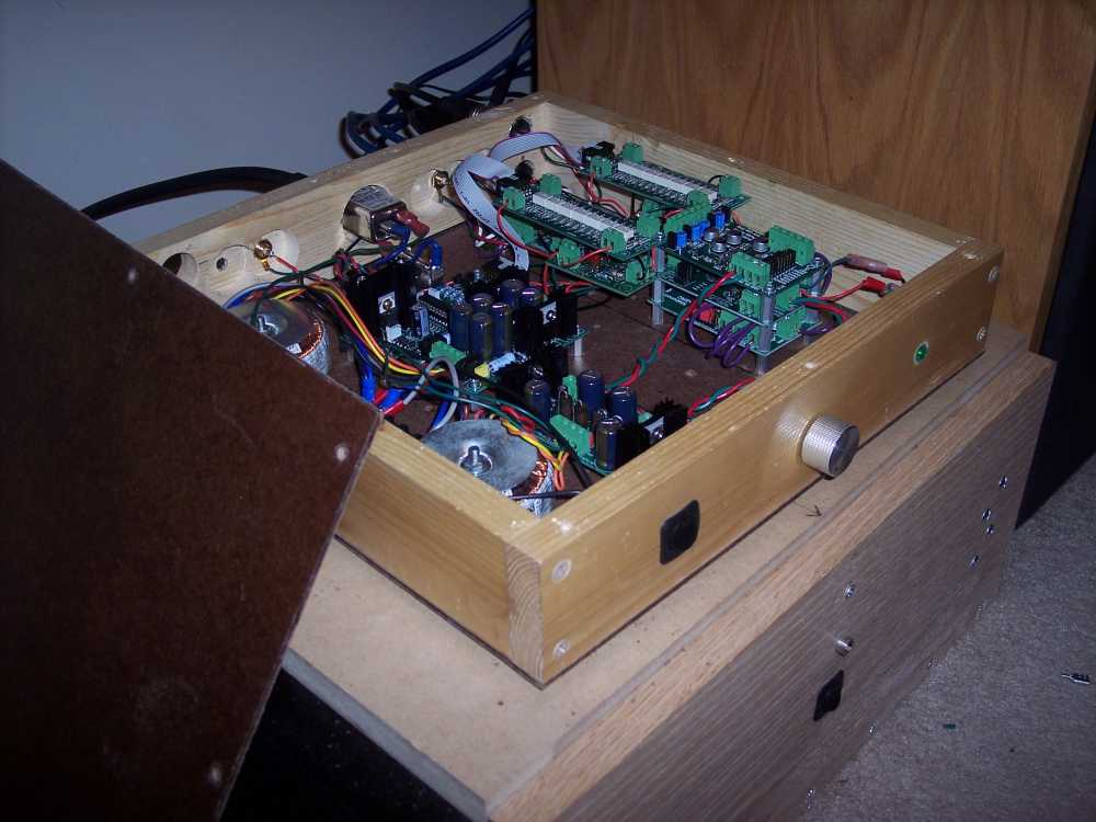

I decided to show the COD with TXD I/V and a Joshua Tree attenuator after each I/V, the output of the attenuator goes to the ballsie where the output is filtered and buffered. 🙂 From there SE outputs go to my head amp and balanced out to the power amp.
Oh yes, there is a metronome in there too. 🙂
Cheers!
Russ

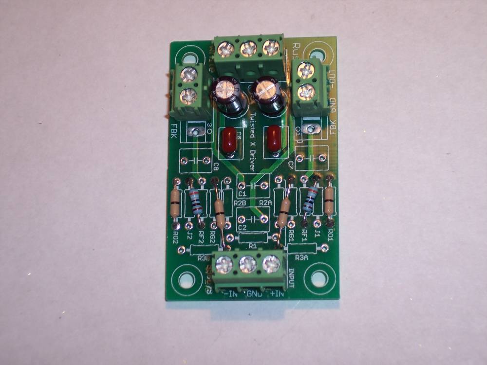

Hi Russ
How exactly do you configure the TXD as an I/V? I'm interested in trying this.
I'm also considering taking the output of the TXD (as I/V) and putting it through the Ballsie to get both differential and single ended outputs.

HeadSh0T said:
Hi Russ
Do you see any problems with this setup?
I will be building a fresh one tomorrow, so I will take some pics and describe the process. Its very easy.
You basically just use the THS chip (I have used THS4131,4141,and 4151), 2 feedback Rs (221-390R seems to work well for me). and 4 jumpers. Its cake.
I would not interject the BOSOZ, its redundant.
I would instead just give the I/V as much gain you you think you will need, and use something like a joshua tree between the I/V and the ballsie.
I am very happy with my setup, it is absolutely silent (no hiss or noise) and the sound is superb with both headphones and through the poweramp.
Cheers!
Russ

TXD for I/V
Here is a TXD configured for IV.
This one is using 390R resistors.
On the backsides are just THS4131,THS4141, or THS4151, any of those will work fine. In this case I happen to be trying THS4151.
Calculate the resistor for the swing (Vpp) you want by dividing Vpp by the peak to peak current swing of the DAC, in the case of the COD that is 7.8ma so I wanted roughly 3vpp so I chose 390R (.0078 * 390 = 3.042).
I hope this helps.
Cheers!
Russ
