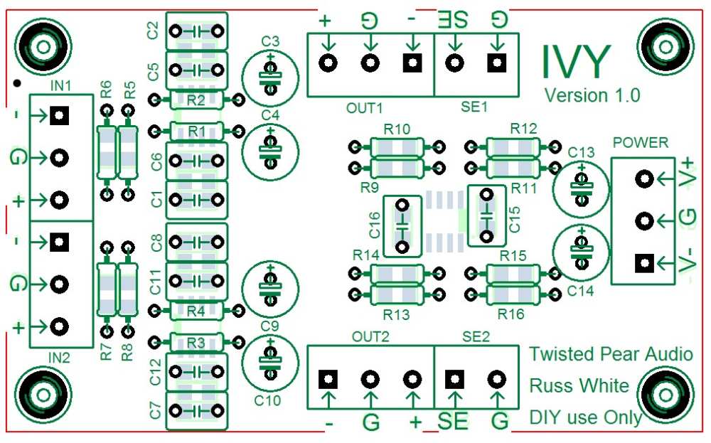

One note when using the IVY with mono PCM1794. You may need to recalculate the feedback resistors to get the desired output level. The resistors in the kit are for 2VRM from the 7.8mapp swing. In mono mode the output will be double, so if you still want 2VRMS from 2 mono DACs into the IVY you will want to halve the value of the feedback Rs (R1-R4).
There is no harm leaving the Rs as supplied, it just the output will be 4VRMs.
If you will just be using the SE output you could get that output to 2VRMS just by changing R9,R10,R13,R14 to double their supplied value, and leave R1-R4 alone. this will actually lower THD slightly. 🙂
You could also use one IVY per channel (much like the datasheet application) in mono mode, and take the SE outputs as balanced outputs. This would yield the absolute best THD.

Interestingly enough the PCM1798 has half the output current of the 1794 so I should be able to use the original resistor values, but as I bought the bare board version this won't in any case be a problem.
kevinkr said:Interestingly enough the PCM1798 has half the output current of the 1794 so I should be able to use the original resistor values, but as I bought the bare board version this won't in any case be a problem.
I would very definitely suggest using one IVY per mono chanel, that will yield MONO balanced outputs at the outputs labeled SE on the IVY.
If you still need single ended output you could then use a third IVY PCB and just populate the BAL/SE opamp and its resistors and caps, not the THS section. You would then wire the balanced signal into the terminal blocks market for balanced output.
This will get you the best DNR and THD.
I will draw up a document soon on these different options.
Cheers!
Russ
