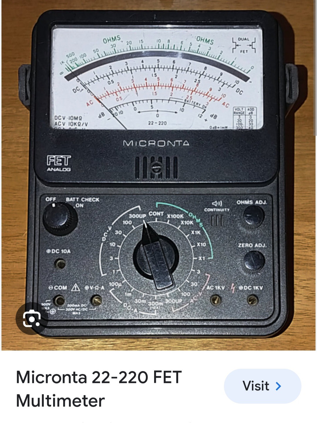

On the topic of DMMs and analog meters, I prefer to use my tried and true fet input meter. The fet input stage provides a very high input impedance and gives a wider frequency range at lower voltages, so the rectifier doesn't dictate your low voltage cutoff limits as much. I've used this meter for just about everything not requiring a scope. It was used for everything from calibrating tape machines to measuring TS parameters of speakers before there were dedicated computer setups. Its very accurate up to 30 kHz AC signals, so it can deal with any audio task you throw at it.

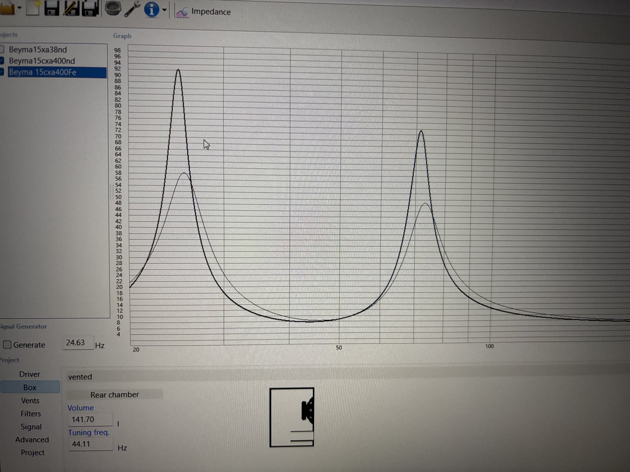

The one impedance peak is below where the drivers will operate. Amp will not see naked impedance, it will be blocked off by the passive crossover. I believe you were saying 40 hz for the box tuning? Woofer impedance peak is 26 hz. Additional impedance peak at 70 hz. Infinite baflle frequency response is - 4db to 60 hz, only 2 db down at 80 hz. despite the impedance peaks so balancing mechanical & electrical damping is what designers do to make that happen.

Thanks jo. Yeah it was the 72Hz peak I was worried about, not as much now.
You are right about the lower damping with the high Qm, but after exhaustively reading up on how much it matters, I didn't give this as much weight. In the end the difference in total Q is .06, very small.

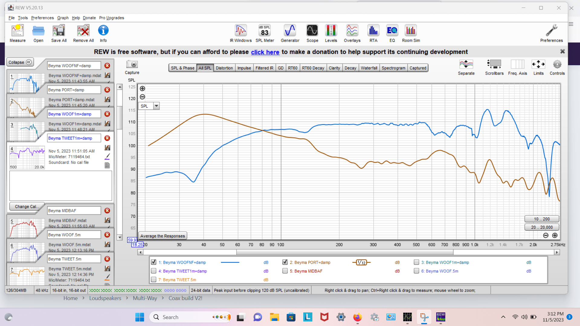

Alrighty, finally got the Beyma 15CXA400Fe drivers in this Thursday, and mounted them in the 145L (net) boxes, and ran sweeps in REW and took the free air parameters with my DATS. Not horrible but I'm going to have to do some fancy footwork with the crossover. I had hoped to be able to cross these 2 drivers at 1000 if possible, but it's looking like I'll either have to go to 1500 to get past the huge dip (coinciding with an impedance spike at 1250), or brute force that imp. spike with a filter. So I'll post a couple of shots, and I'd like any input or feedback anyone has.
The first pic will be nearfield woofer and port. Nearfield on this woofer is difficult because there's a giant horn blossoming out from the concentric CD.

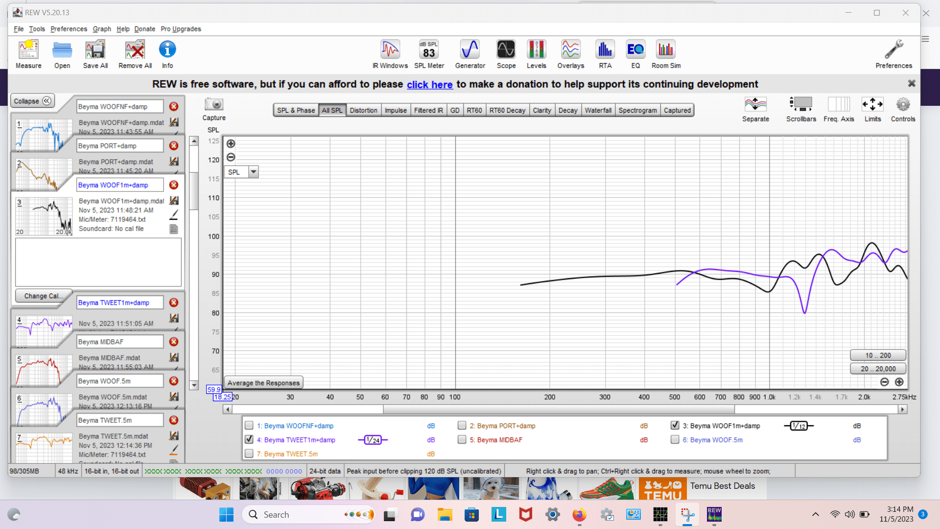

The second pic is the CD and woofer both at 1m, and gated at 6.2ms. That little blip at 130hz is from a box resonance, I know this because I cut it way down with some extra damping on the top and sides around the woofer.
I'd wanted to try to keep the xover to simple 2nd order but I don't know if I'll be able to do it unless I cross on the higher side?

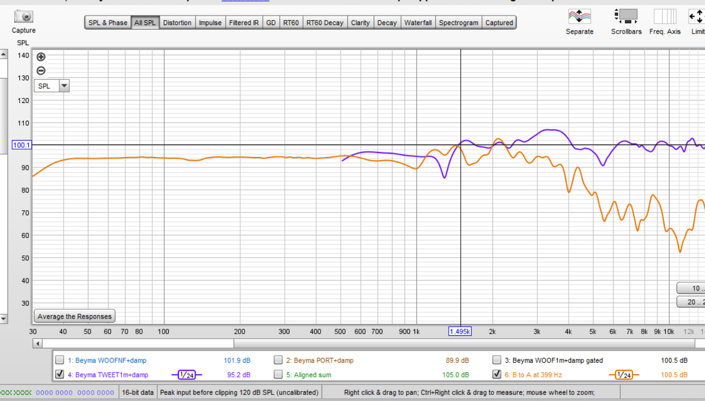

Okay, now I have finally figured out how to sum and splice the gated 1meter, nearfield, and port responses. I've also included the gated 1M CD response.
The Y axis indicator is at 1.5k, which is how Beyma crosses these. I think that dropout at 1.3k is just a feature of the horn, diffraction/cancellation? But does anyone have any thoughts, ie could it work to cross lower than 1.5k? And does anyone have any good starting points as far as order, etc? This is my first from scratch build so any pointers are welcome. I was going to use Vituix but it's pretty intense, I think I'm going to use WinPCD, partly because I'm an admirer of Jeff Bagby, and also because it looks less intimidating.
