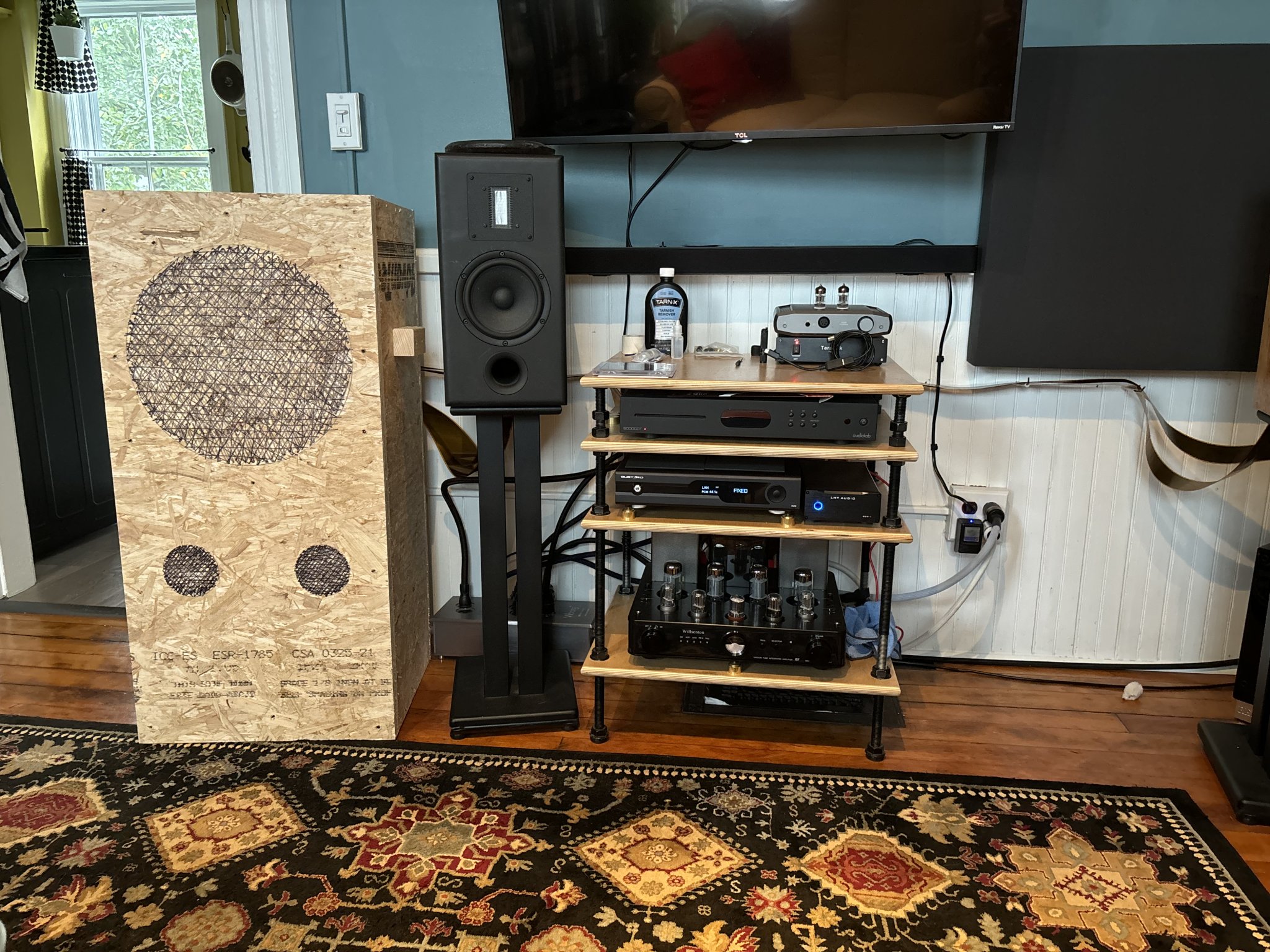

In the meantime, I'm going ahead ordering the drivers and building a test cab from some 3/4" Advantech suubfloor, picked it up on a lumber run the other day. I'm just going to take my chances and measure as I go and see how things line up, and how they sound.
As far as using a 15" in a small room, there's enough people who love this crazy setup I just have to go for it. The thing I haven't mentioned is within a year my setup will be in a much bigger space, so I'm looking ahead too.

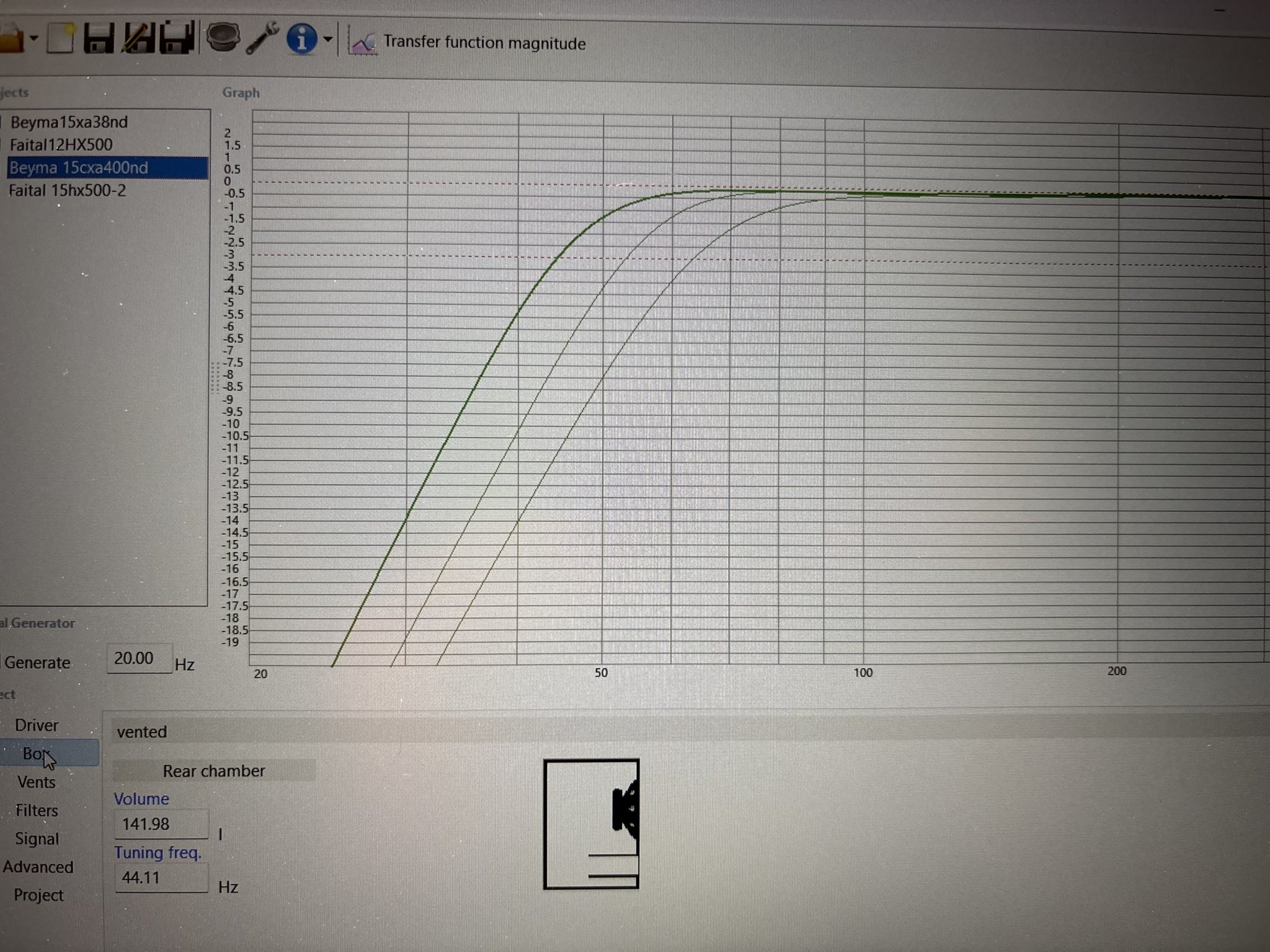

I'm going to use the Beyma 15CXA400ND, a super nice looking driver that meets the criteria, with 98db sensitivity and an 87g Mms, pretty light.
I'm tuning just barely above Fs (40hz) to 44hz, in a 142L enclosure, with 2-4" vents at 96mm if I remember correctly. I can model this driver in an even bigger box (Vas is 196L) and still stay pretty darned flat to the rolloff but I'm being a bit conservative and not pushing it too far. I also like the size, beefy but just about as big as I can deal with in this room. Test enclosure will be 18" x 41.5" x 15.5" with a 36mm baffle. The baffle width is a primary concern.
I'll test it on both amps, and if I just can't make it work with the 45, I may just move on from fleawatts, although I'd probably build or buy a bigger SET. I know trying to make a speaker work with a <2wpc amp is a real challenge, and it usually involves large enclosures and bigger rooms. IF the 45 fails, these speakers will work great with other amps, even if I need to do some xover adjustments.
Group delay looks great, and so does excursion down to 22hz. I know this won't be perfect, but it migh be darned good, and I just have to make some choices and get moving. Here's a shot of the alignment, thanks to everyone for all the responses so far, I've been listening and if there's something off here it's not from obstinance but ignorance:

Hmm, the pioneer's 136.11 L/40 Hz Fb, T/S max flat's 134.61 L/44.8 Hz Fb makes yours about spot on if you didn't account for the driver, vents, bracing losses 😉; regardless, within the ~ +/- 10% rule of thumb (ROT) when factory specs are used for typical high DF amps.
Factoring in amp damping though may make them a bit too under-damped, yet many like them anyway as it provides a boosted (mid) bass that offsets baffle step loss in many apps, though again, it will be interesting to 'hear' how well ya'll like its low end response with other than actual Fs tuning.

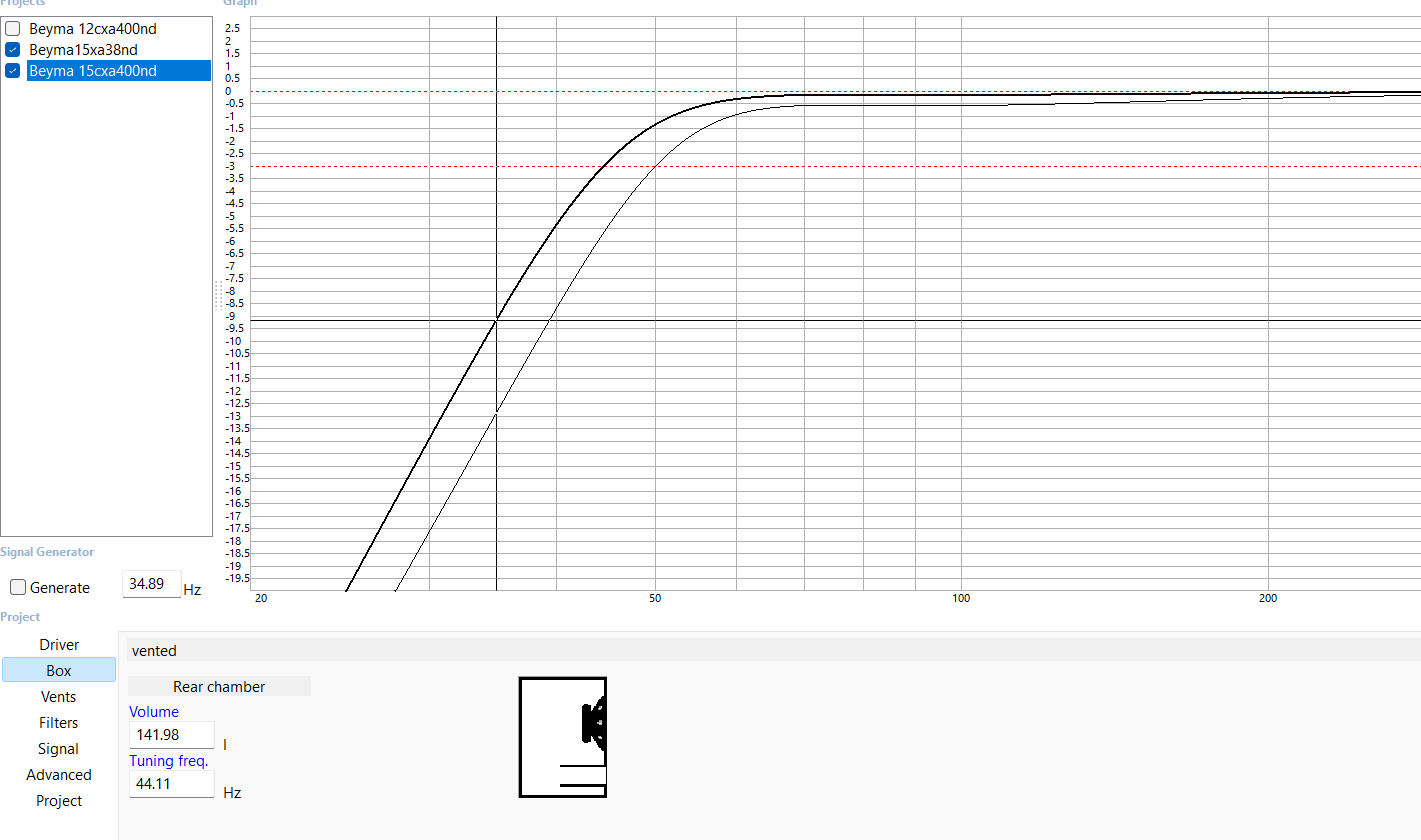

Thanks GM, I was hoping you'd chime in here. Do you think it would be better to tune to FS (40hz)? Easy enough to do as I'm not too far off. I'm not completely clear on the principle of why tuning to Fs is advantageous, not doubting you at all, just don't quite understand except it seems like it would cause a bit less impedance issues?
Here's how that models in a slightly bigger box, I really can't go much larger then this, though the driver seems like it could very comfortably approach its Vas of 196L

Well, history shows that the lower the DF, the greater the need as it increasingly tracks the impedance, which of course can be quite a different response compared to a typical sim and even one with using a resistor in the sim; regardless, with all but low DF SETs, which I did traditional reflex vent/tuning of actual Fs, i.e. when the impedance peaks were at equal amplitude on a scope, so you can get a more accurate sim matching them up, otherwise used pipe vents I mostly tuned in room at the desired locations by using cardboard tubes of differing lengths to slide in most of the way with a thick rubber band to act as a temp seal and FWIW, virtually all 'stereo' pairs not hard in corners were tuned differently, sometimes pretty far off due to room acoustics.

Thanks GM once again. I'm confused by your wording in this sentence: "with all but low DF SETs, which I did traditional reflex vent/tuning of actual Fs"
I'm very literal so excuse me, but that reads as "all except low DF SETs", and I'm pretty confident I'm dealing with DF of <2 here, which is pretty low, so would you tune this to Fs, 40hz?
I'm starting to understand why the response tracks impedance, it's kinda like the amp has a weak immune system haha!
If I need to tune to Fs, it's going to be a big box! But I'm working on how to make it work, maybe by increasing the height a bit and the depth a bit.

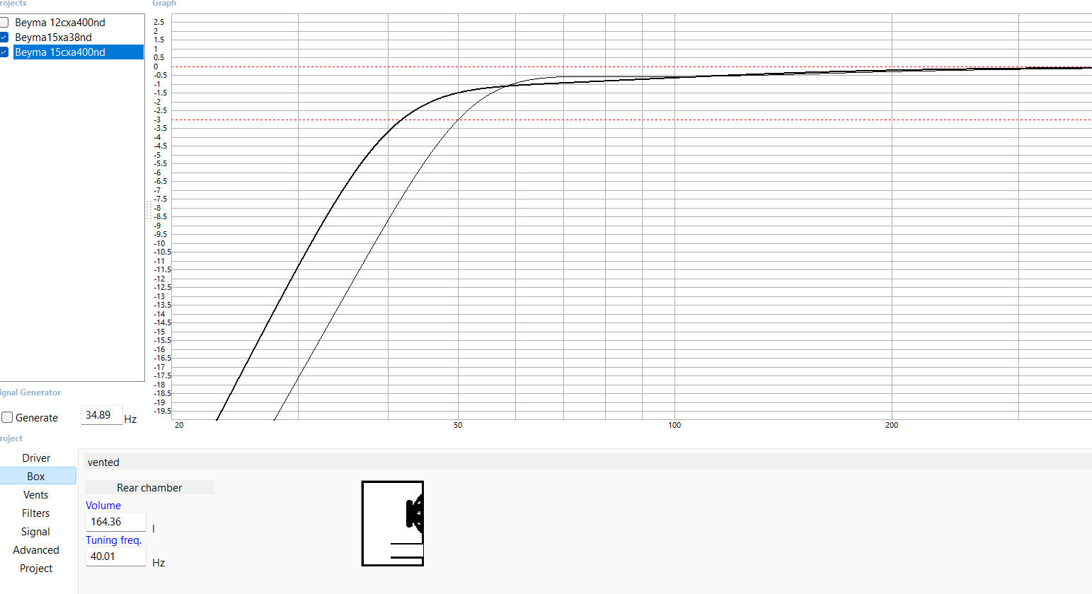

Wow GM thanks for taking the time to pot those links, I'm going to read the entire book, it's well written and things are very well explained. The click test is awesome! The only thing I wonder is how to create the resistance of the added cloth over the port in another way.
I see the old school alignment is Fs + Vas for enclosure volume, but I'm not going to be able to get very close to the 196L Vas of this driver, but it sims really well from 140-164L, so I'm keeping it smaller but as large as I can.

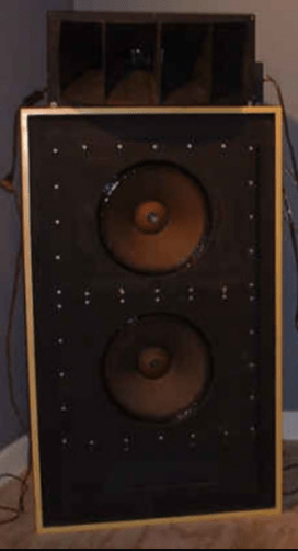

The British came up with the ARU, a piece together vent, so of course you can use screen door or pet screen to 'sandwich' whatever material you choose or just layers of the screen not quite lined up as I did. Stapled in place, then make a (cosmetic) ring/frame if you can't find something suitable pre made. Personally made a sub baffle for the vent, tuning it wrong side out and flipping it over once done.
If you look carefully you can just barely see the rectangular slot in the bottom baffle with the screen behind.

Forgot to note that you can do this with pipe vents also if OK with small fractions of a tuning error due to the normally slight box Vb being a little larger, though of course with large and/or long pipes, shelf vents it's a bit more time consuming if not temporarily adding some scrap/whatever to offset it, just don't forget to remove it! :cuss::headbash:

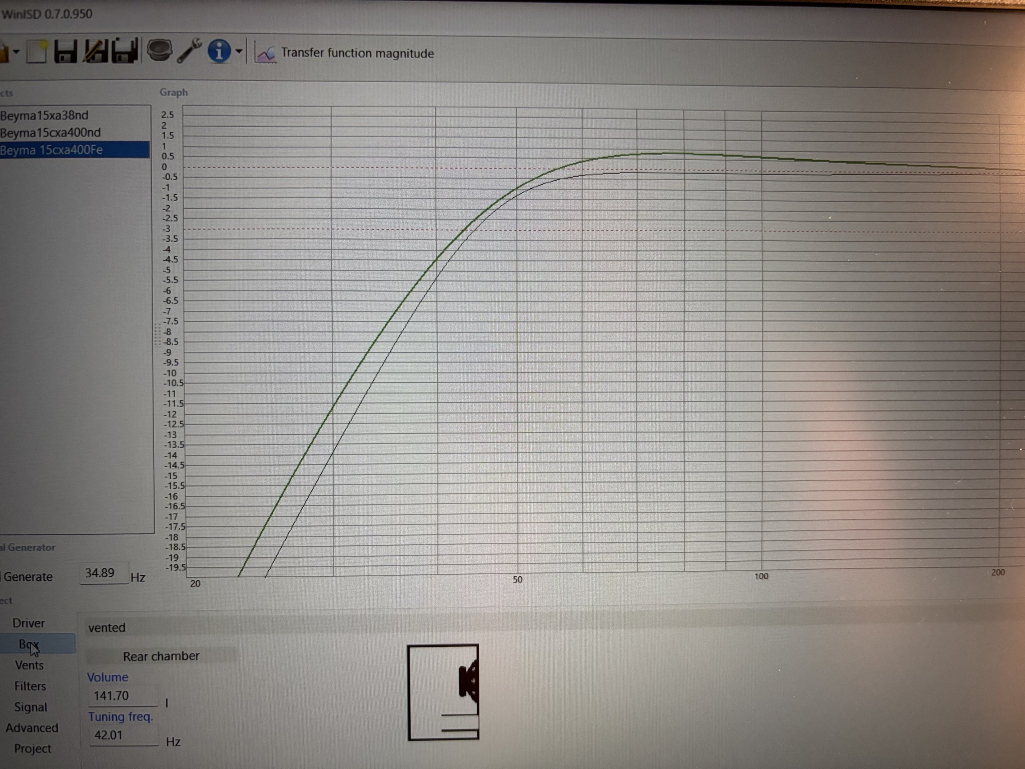

What IS and issue though is that the Beyma 15CX400Nd are still on the bench in Spain, and won't be here until December sometime. So I'm faced with the choice of waiting, or trying the 15CXA400Fe, its ferrite sibling. It models like a beast, and according to WinISD can go all the way to Vas at 190L tuned to Fs, 40hz or even a bit below Fs, which I'm afraid of. I know this is the old school kind of alignment, but unfortunately I can't build a box that big for my space, so I'm limited to 142L net, about 155L finished. Has a mild hump but still looks OK to me. I just don't know how different the sound is going to be from the ferrite as opposed to the neo magnets, which are supposed to have a better grip and acceleration I guess. Anybody have a 2 cents on this?
