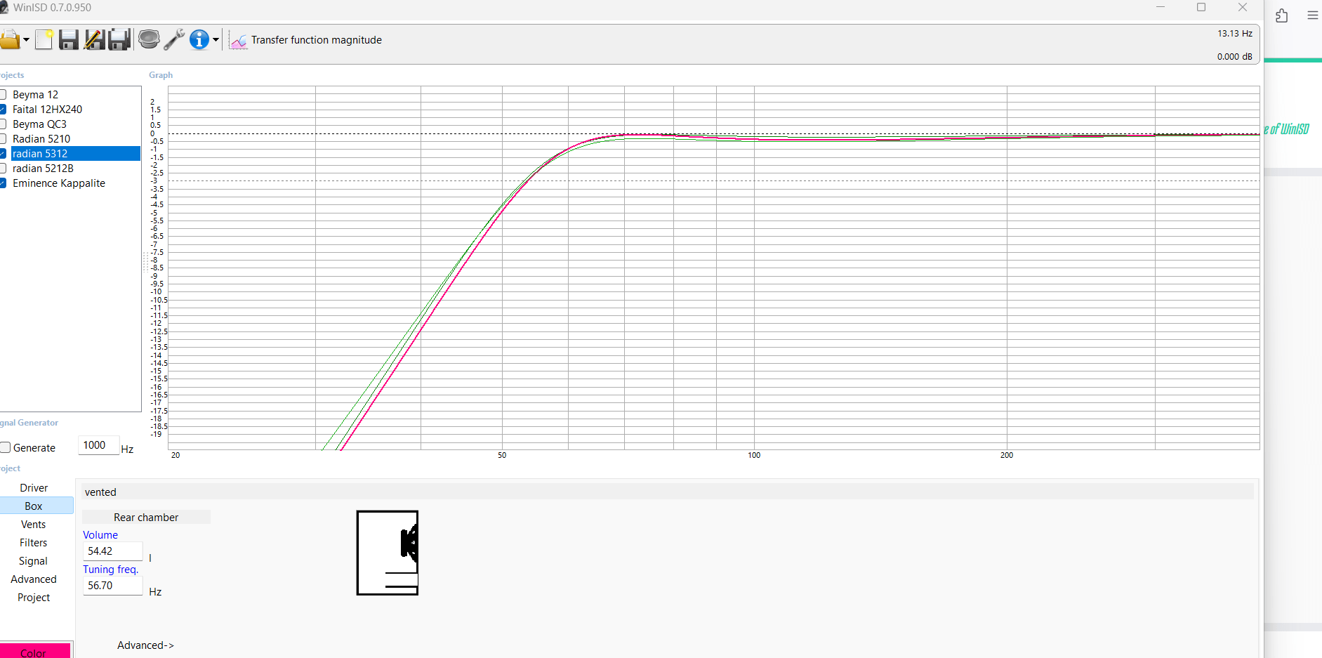

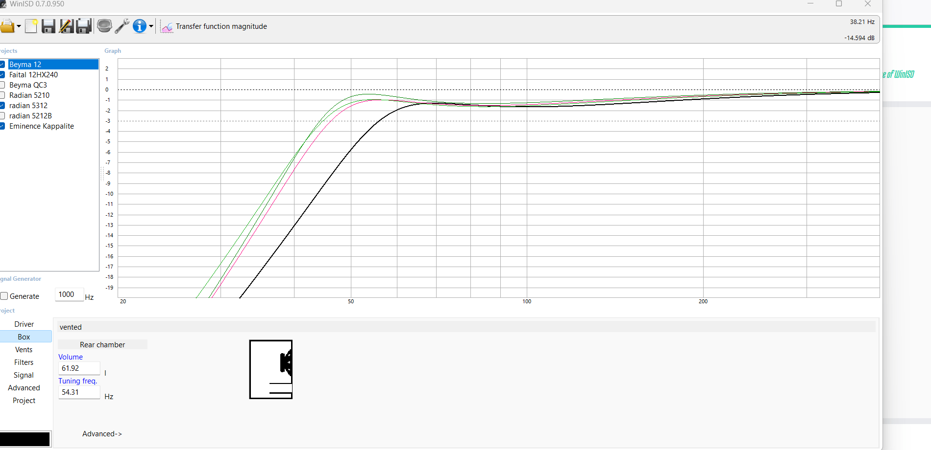

OK, as threatened, er promised, I threw a few more drivers into WinLSD tonight and played around with the alignments to a similar pattern, one that balanced the compromises most to my liking. The boxes fall in the range between 75-100L, and almost all of them are at -1db before they start to roll off. To achieve a flat response, the compromise is a much higher rolloff point, usually around 70-90 hz. But all but one are within -2db of flat at their lowest points, and the best at -1.5, and approximately -1db at the rolloff point, which hovers around 50Hz for all but the Beyma, which shows the least pleasing curve of all of them, but is also 2-4db more sensitive. If ever there was a lesson in 'no free lunch' I'm looking at it.
Right now the three I'm focusing on are:
1. Radian 5312 tuned 77L/46Hz
2. Faital 12HX240, tuned 98L/46Hz
3. Eminence KappaLite KL3012CX-8
The reasons for these three is they all go the deepest and are all in the 95.5-97db sensitivity range. the Faital being 97. These three are shown in the second photo, and the whole bunch in the first, including my original interest, the Beyma12XA30ND, which really sags below all the rest by 1.5db for a long period and just looks like the runt of the litter in comparison, but I'm bearing in mind this is a very granular scale and the perceived differences may not be that noticeable. I do like the 98db sensitivity of this driver, and it comes very strongly recommended by Al at US Speaker, but the best I can get from it is shown in the third photo, 15-20Hz higher rolloff and 10-13Hz higher rolloff point.
At this point the next step for me is to hear feedback about these drivers if anyone has any experience with them. And I have one question about the tunings I've done - Is it OK to have that bit of raised knee at rolloff, or should I flatten it out with a smaller box/lower tuning?

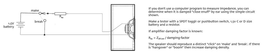

Historically one 'critically' damped the vent.
Math for flattest response:
Vented net volume (Vb) (L) = 20*Vas*Qts'^3.3 (Ft^3 = (Vb)/~28.31685)
Vented box tuning (Fb) (Hz) = 0.42*Fs*Qts'^-0.96
F3 (Hz) = Fs*0.28*Qts'^-1.4
(Qts'): (Qts) + any added series resistance (Rs)
(Qts'): (Qts) + any added series resistance (Rs): http://www.mh-audio.nl/Calculators/newqts.html

Well thanks for the inputs guys. Mayhem - just want to respond to your insightful info. Right now I'm using the graphs mostly to compare one driver to the next and to begin to internalize "what happens if I do this?", and get a bit more intuitive. My limited experience. combined with in-room measurements, doesn't warn me off following this way of working. I'm also comparing the alignments in WinISD to what I've generally seen and read people have ended up with, and it seems to be in the heighborhood. So lacking the depth of expertise, I just have to keep going and learn from my mistakes. For me it's better to keep moving and keep it playful at this point! I'm going to try again to post some comparison graphs now that I'm on a PC and not my Mac, I hope it works. In the second shot you'll see a cluster of 3 drivers - Faital 12HX240, Radian 5312, and Eminence KappaLiteKL3012CX-08. It surprised me to see how close I could get them all with very similar tunings and box sizes, although the Radian is 75L, the other 2 closer to 100. All tuned 45Hz+/-. The fourth driver in bold black is the Beyma12XA30ND, my original choice.
The first screen shot shows the same drivers with a much flatter alignment, higher tunings and smaller enclosures. I'm curious which way people would go? I love the looks of those flat responses, but it's giving up a LOT of extension. Bear in mind the graph is very granular so in the first everything is within 2db of flat. Is this acceptable? Here goes:
