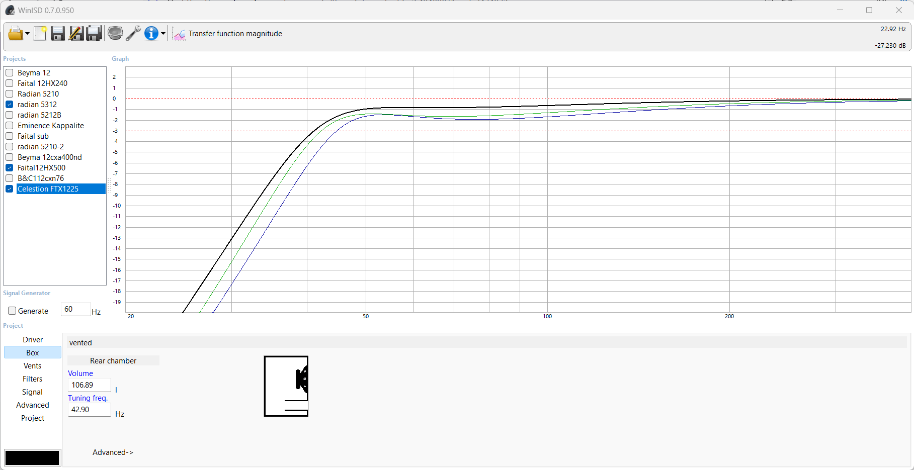

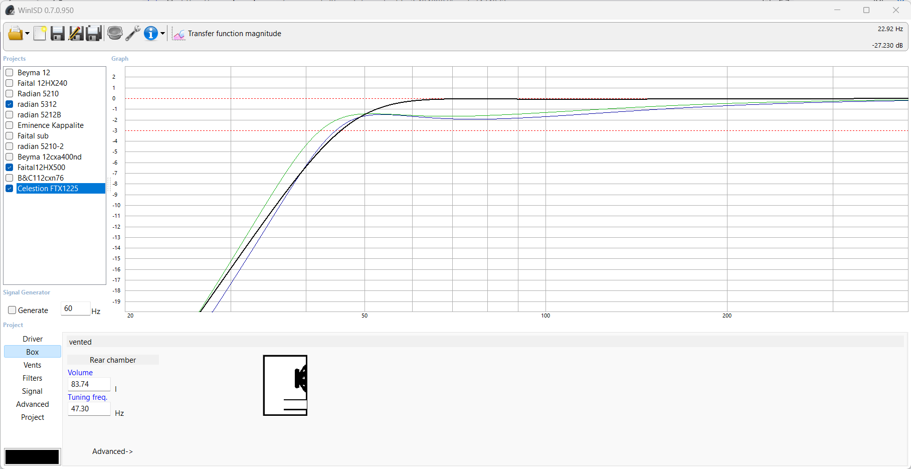

Here you go fabricade, this is a SBB4 alignment, maxed out at 106L/43Hz. I'm impressed by how far this driver can stretch, F3 42hz, you can see it next to my other top choices at the moment, FaitalPro 12HX500 and Radian 5312. I'll post a second screen shot with slightly different tuning, closer to flat.

Thanks alot for teh plot!
