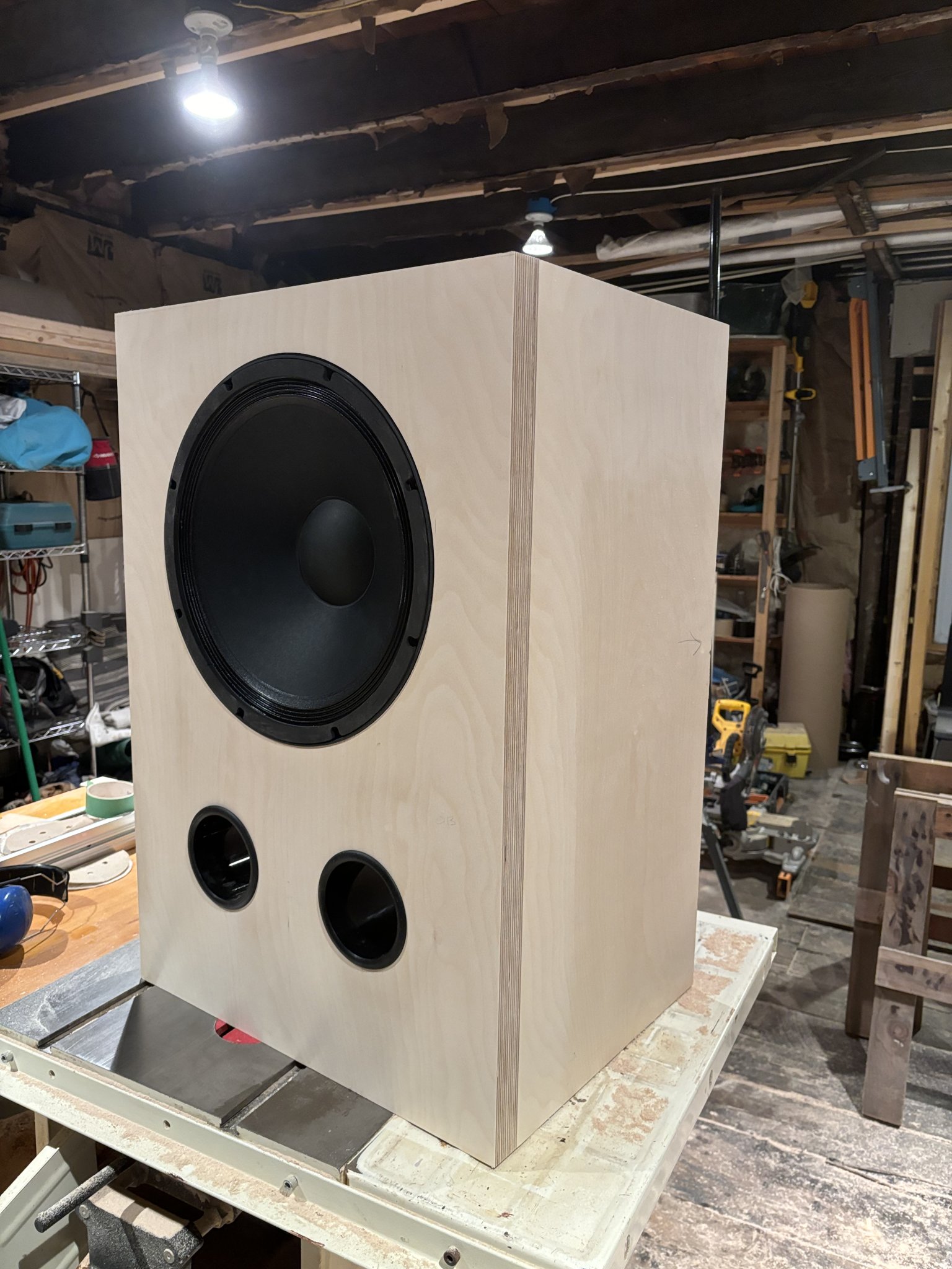

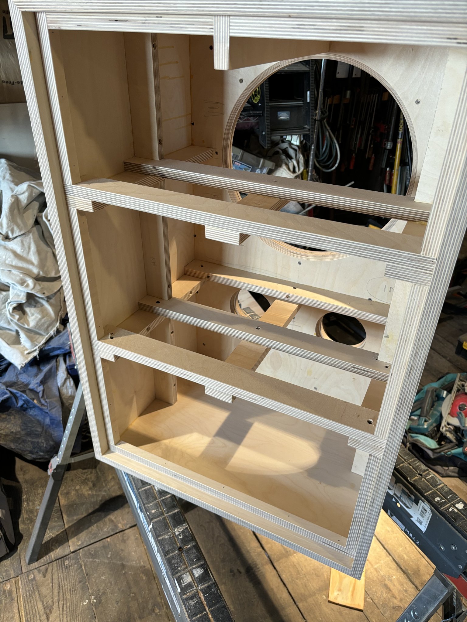

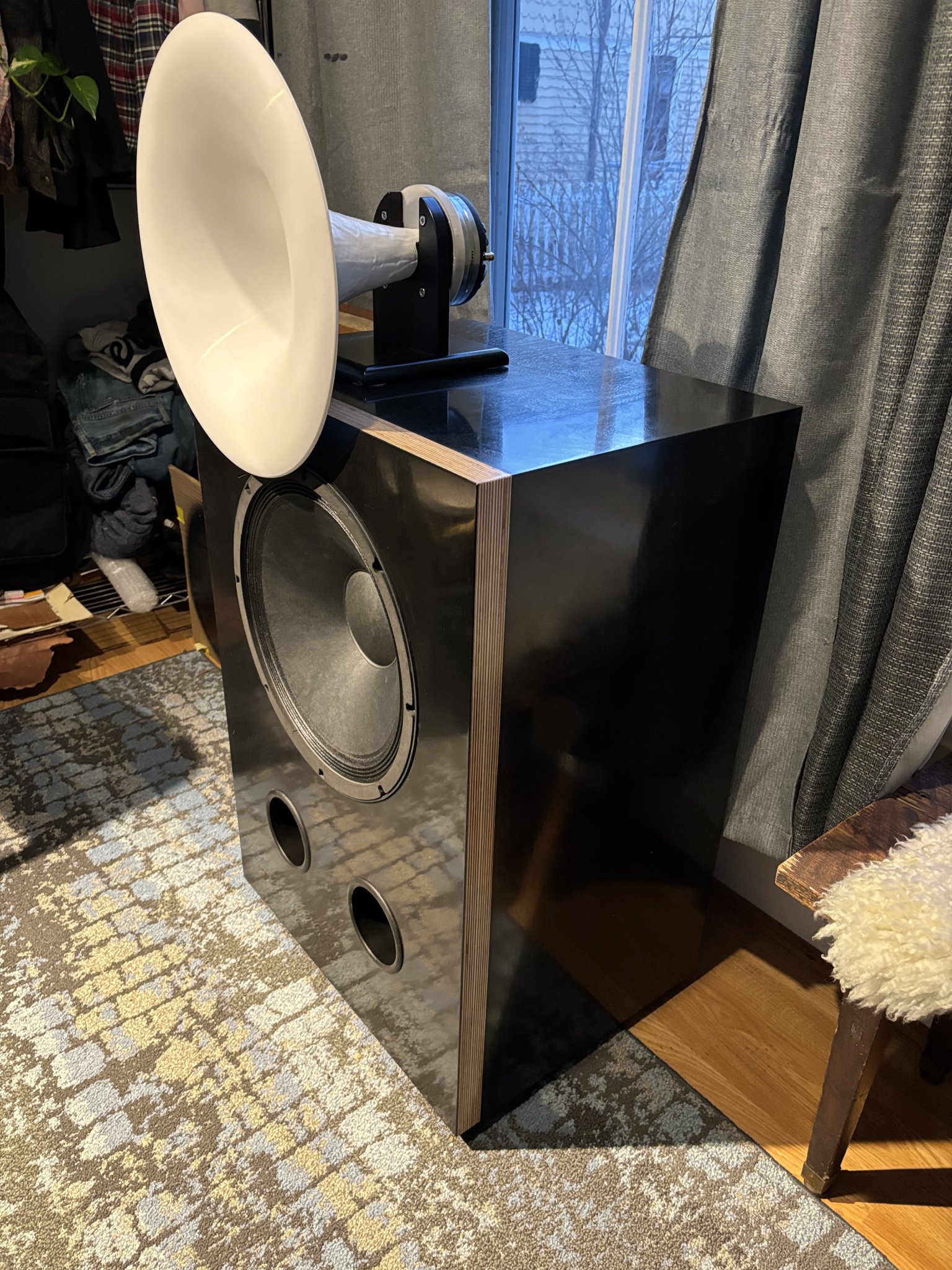

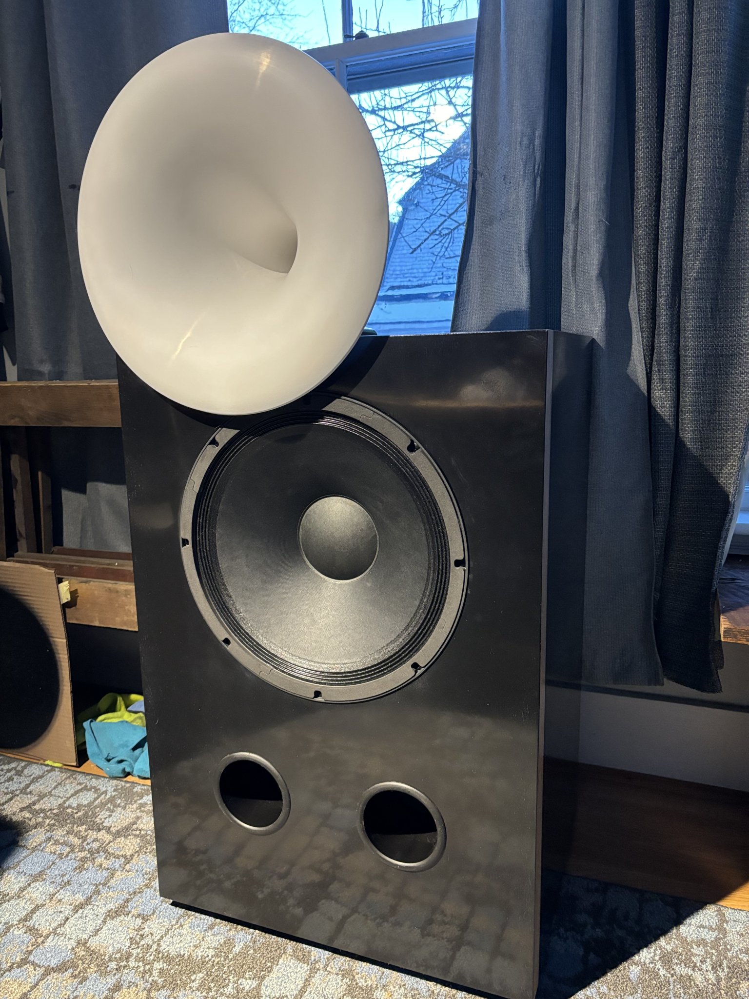

Well it's been a while, haven't had as much time as I'd have liked in the last month, but this project has finally turned the corner and the speakers are built. I'm waiting on a few odds and ends, mostly cable stuff, but also an amp my buddy Cam is building me and a Sublime K231 active xover. Cam has been at me for months and he finally convinced me, so this will be an active speaker setup, biamped with tubes on the SBA compression driver and a killer class D on the Faital. Will try to cross at 500Hz, Troy Crowe is making me extended rear covers for the CD which will drop the Fr and allow a better cross down there. I had a lot of difficulty with the lacquer, used a product that was new to me and it was a sh*t show, but it turned out ok.
So far measurements with REW look pretty good. I had intended to tune them to 44Hz because I liked the way it looked in WinISD, but when I measured today the ports measured at 40Hz (I figured I was going to shorten them) and I'm going to leave them there because I don't see the penalty I saw in WinISD. The cream on top, literally, are Martin Seddon's Azura 425 horns, they are beautiful and really make the whole project work visually for me. I am assuming this will follow sonically, haven't measured the horn/CDs yet, waiting for those rear covers. If there are any Active xover users here I will probably have a few questions very soon, there's not a lot of info on the web really.
Here are some progress shots:
