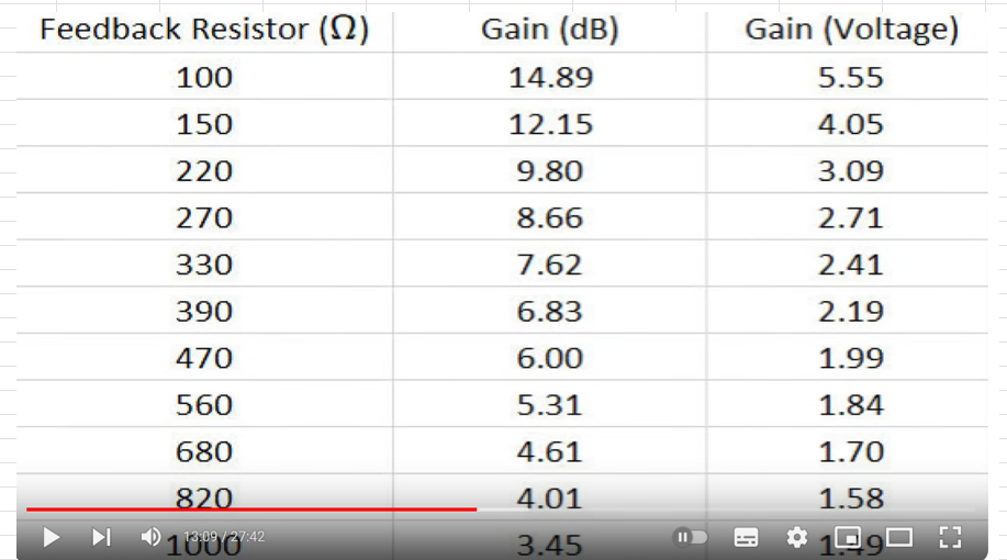

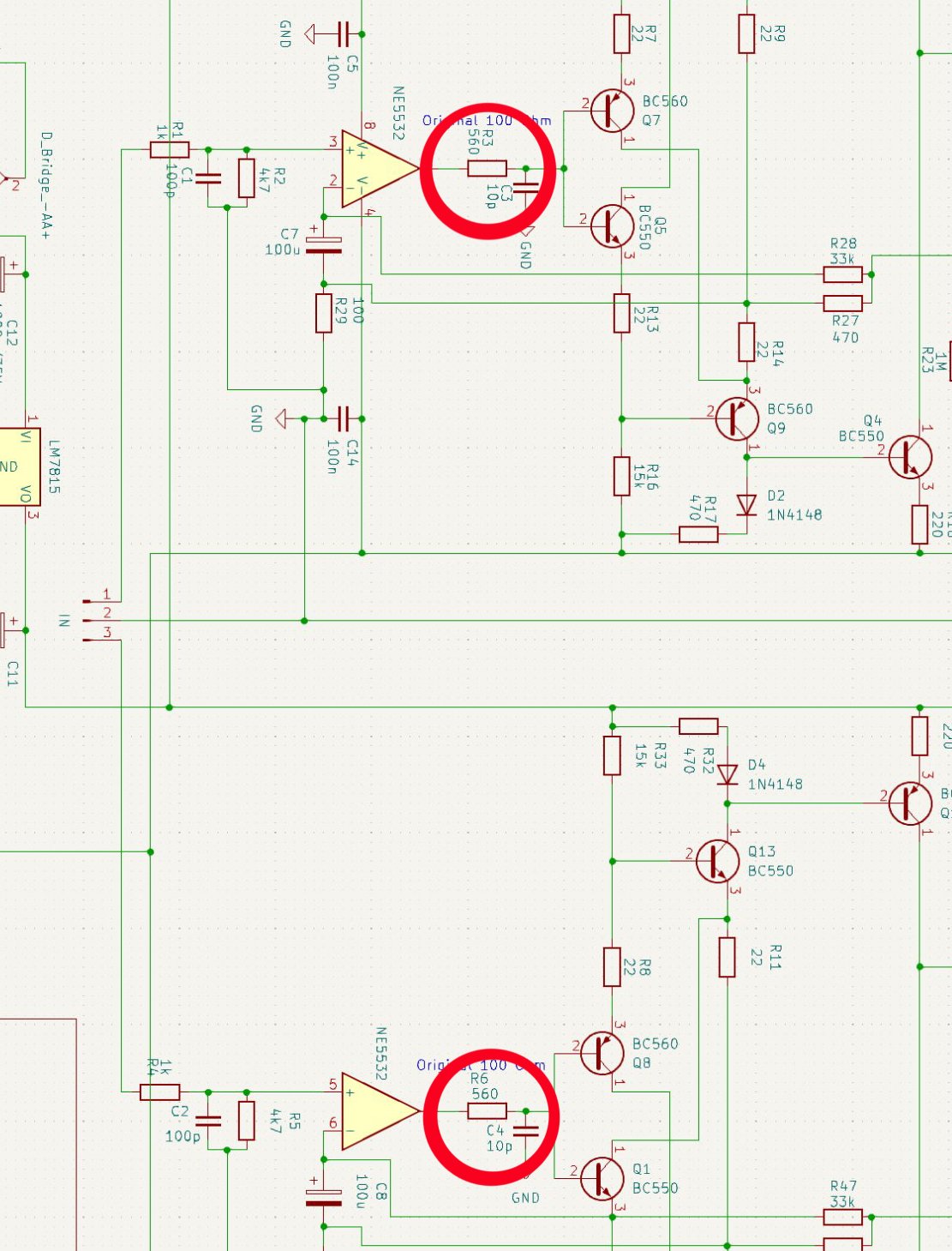

Is it beneficial to increase R3 and R6 as well, to 560 like the schematic shows or other value? And would a better quality resistor make any improvement?
Those 'stopper' resistors should remain low.
The stock circuit seems very stable. I don't see any reason to increase it.

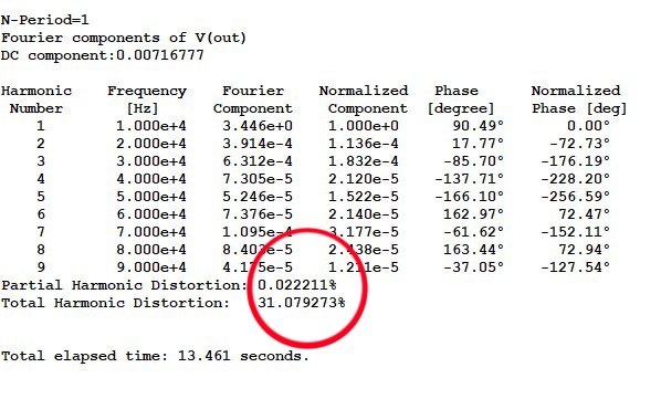

I think 100 ohms is best or even a bit lower. Increasing the value causes big problems in LT SPICE simulations.

Regarding this MOFI preamp and the change of the 100uF caps near the regulators with 0.47uF film for the 7815 and 1uF for the 7915. The sound quality is dramatically improved, with increased clarity and depth of soundstage. That is until the input level gets too high, then there is clear distortion. The lack of power supply regulation creates a blurriness that is probably masking the distortion. This is with an otherwise stock MOFI with 100R feedback resistors. Fixed 100K resistors on the input. A max input voltage of only 0.235Vrms is distorting.
I am waiting for some CRDs to add @chalky mods. Plan a stepwise approach, with the VAS first.
I had my clone on the scope yesterday and I could see no clipping until over 3v rms output from the AWG. So I guess it is not clipping you are seeing.
Are you measuring distortion or just doing listening test?

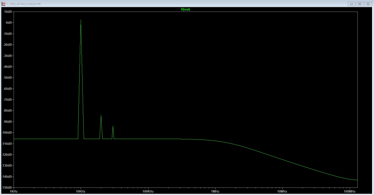

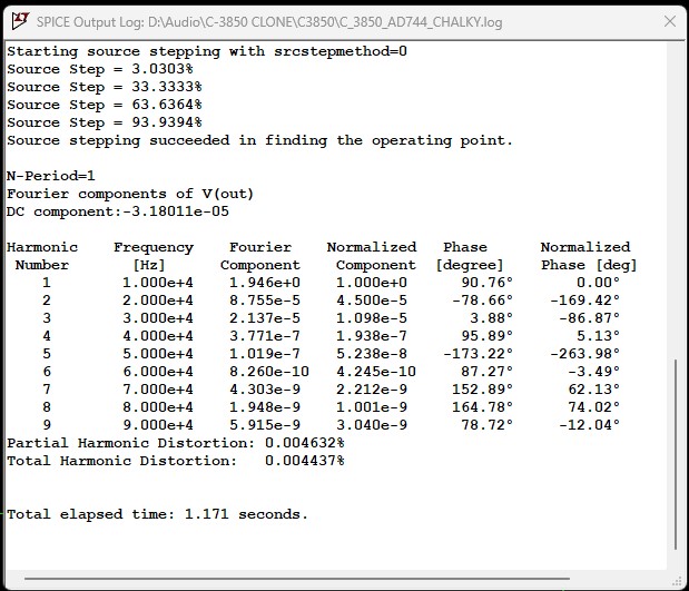

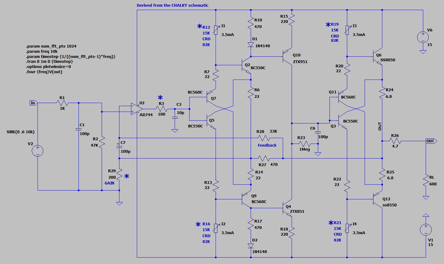

The final 'output' transistors Q6 & Q12 are an excellent upgrade path if you want to drive complex loads 600 ohms and lower...headphones.
The SS8050/SS8550 and or ZTX951/ZTX851 reside in this design well. I have even simulated those transistors closer to the front in the Q10 Q4 locations.
The whole thing starts to behave like a 'real' piece of audio gear when the more powerful transistors get put into the hot spots to do the heavy lifting.
The measurements in spice become closer to what I would expect in reality with these more robust substitutions in place.
E-352 is the part number, 3.50mA.
Also, the final transistor pair may benefit from an even higher bias or larger CRD diode if those transistors have heat sinks and are beefed up to take it.
Pair this with emitter resistor reduction and reduce the final series output resistor to .5 ohms and raise the rail voltage.
Driving this thing into a different arena looks relatively straightforward and possibly highly beneficial if you are willing to walk away from YouTube Beeney's ultra low distortion discovery. Personally. I get nervous around 0.00001% distortion readings. I like real world stuff like 0.05%. But that is just the way my old-man-self is.
