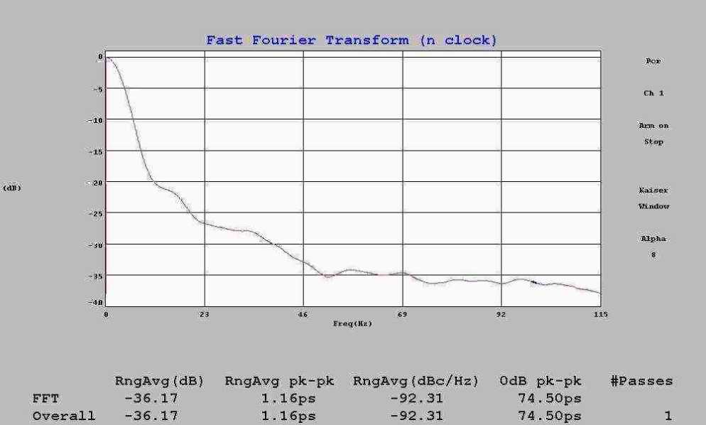

Guido,
forgive my ignorance, but I'm not sure what your graph is telling me. It appears to show rather a lot of noise within 20kHz of the fundamental, so doesn't this get converted into distortion by the DAC? Or does the division by 256 from 11.2896MHz down to 44.1kHz mean that your clock's noise is also divided in frequency? And that sort of musing makes me wonder whether that's the reason why multi-bit convertors without any over-sampling are becoming fashiionable again - they reduce the effect of clock jitter?
Perhaps you could show the spectrum of the typical cheap and cheerful clock in a CD player to allow comparison?

The units are shown in the graph, so it isn't "that" difficult.
It shows the density of the jitter spectrum, from 0Hz to 115Hz. On the vertical axis 0dB equals 74 ps.
NOS DACs are favourable because they are clocked at lower rates which makes the on-chip mess a little less, the absence of analogue filtering, and the abscense of the jitter factory, also known as digital filter.
regards
EC8010 said:Remind me to put my glasses on next time - I thought the horizontal scale was in kHz! Makes much more sense now.
I'd noticed over-sampling filters had a lot of jitter on their outputs, but surely this can be removed by reclocking the data with a slightly delayed clock?
Hi
I had to rescale the picture due to size limits. Jitter cannot be removed, it can only be attenuated (even fifo's have crosstalk, a good example is the Chord DAC).
By the way, we promoted reclocking in DACs over 12 years ago
http://www.tentlabs.com/Products/DIYDAC/DIYDAC.html
cheers
