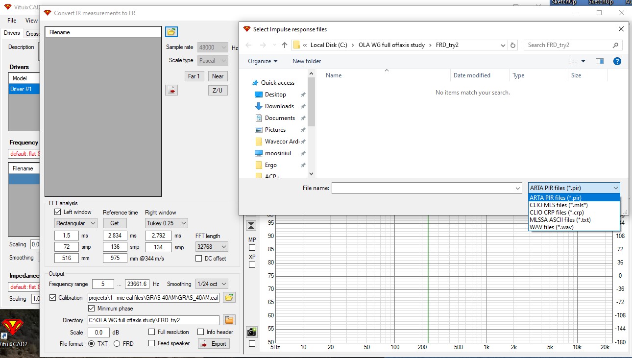

When I was using Praxis it was nice to be able to see that with correction in place my Parts Express EMM6 mic produced very similar results to my Earthworks M30BX. I sold that system a while back and had to start over. I have a new EMM6 mic but it is kind of pointless to use with Clio Pocket since the cal file can't be used. Ergo...I will check out your solution. Thank you for the link. When I can afford it maybe I will go for a new Earthworks M23R. Said to be +/-0.5 dB from 9Hz-23KHz.
