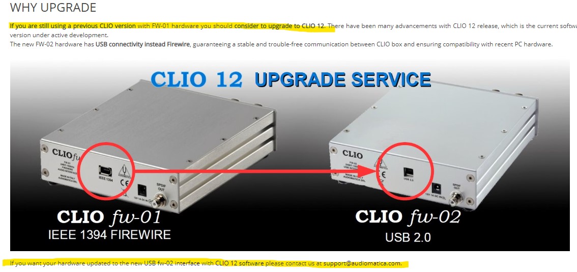

... So please, where do I find that upgrade program?
You can find it here :
CLIO Software Upgrade Service | Audiomatica Srl
Scroll down to the last sentence :
If you want to add new functionality to your measurement system purchasing a more powerful software release (for example passing from CLIO 12 Standard to CLIO 12 QC)
or want your hardware updated to the new USB fw-02 interface with CLIO 12 software please contact us at support@audiomatica.com.
BR Dirk

Thanks, I have just emailed Maurizio; for others interested, I will update here what happens.
Cheers, Joe R.
Audiomatica replied that "the hardware and software upgrade price is €350 for the Standard version. Shipping cost is not included."
End of 2017 I got an offer from Audiomatica for the upgrade of 290 € + shipping cost.
OK, it's now a small increase of total costs, but you will get back an actual System ...
Thanks. Did they send the actual same Clio box or a different one came back? I mean, do they modify/upgrade the unit or was it a trade-in?
You must send your Clio Box to Audiomatica and after Upgrade you will get it back.
They changed the Interface Card ( FW to USB ) and some other parts ...
