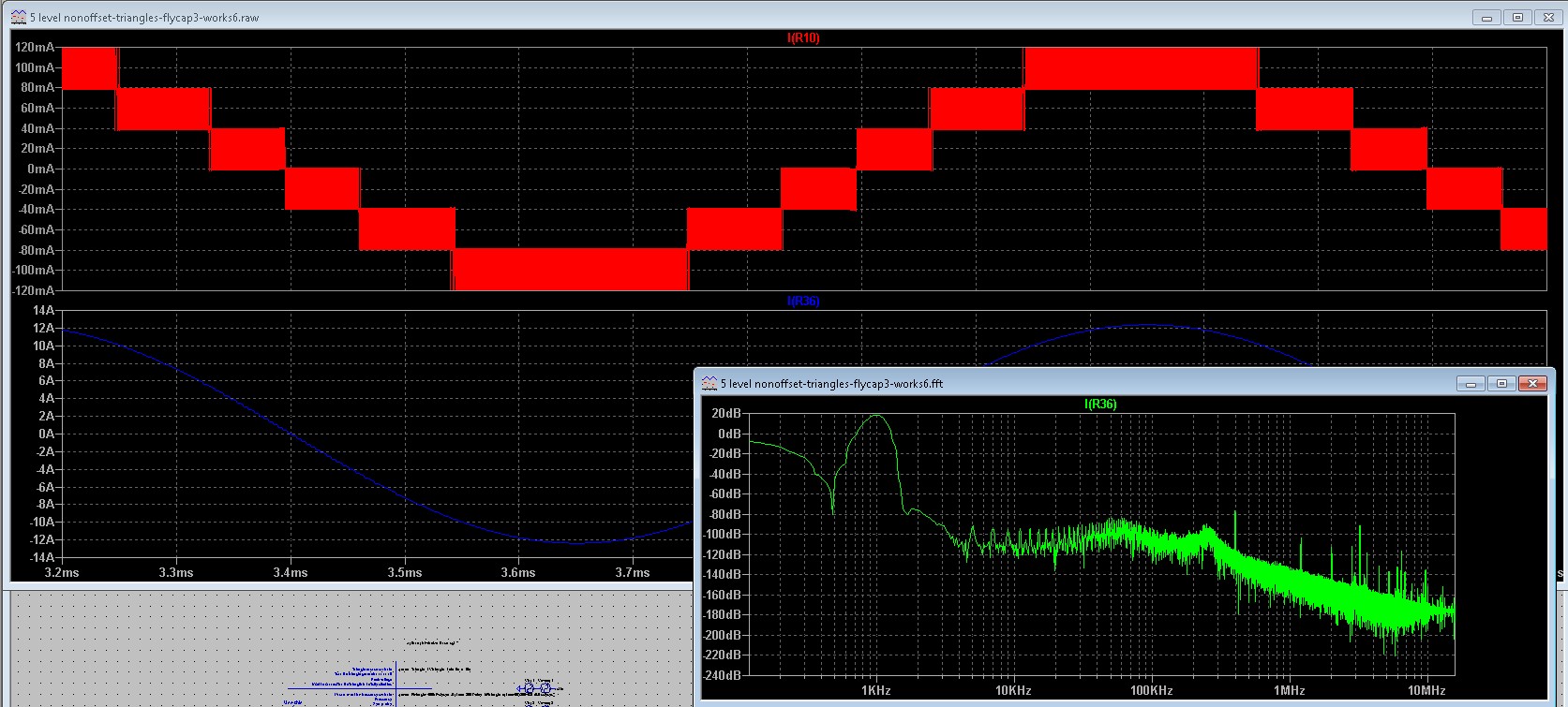

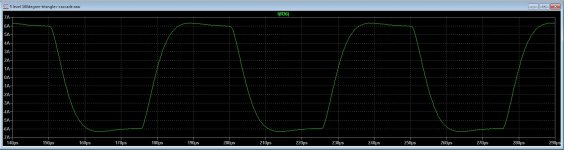

5 level this time fase shifted version, it do quadruple the carrier to 1.6 Mhz without stressing the switches who do work on 400 Khz so I can get quite low making good switch results. Also the voltages on switches are halved, and I just needs two single floating supplies. If this 5 level swither is usable for audio, I do not now, it is used for inverters, quite nice tough, making a sinusoidal output with high efficienty.
the HD is -60dB openloop on 4 ohm with 3600 watts of power. Common mode suppression is quite good, I have low pass setting on 100 Khz. EMI is also much lower then with normal class D technology.
However the parts count is some bigger, the need for 8 switching mosfets and 4 IR2010 chips, also I do not now if the charge pump do work with 5 level for the high side mosfets, then I need a extra supply line 15 volts higher then supply, but if i get a very nice amp, why not, mony is not real issue, high end is.
quite impressive, but yehh it is only simulation, however the working of the system is what counts and learn me some about this.

Hmm, yes in simulation is impressive, but I wonder how it sounds.
There are galvanically isolated mosfet drivers (new technology IC not too expensive). You just use separate power supply instead of bootstrap. (for driving)
How you managed to produce 5 triangles all level shifted exactly ?

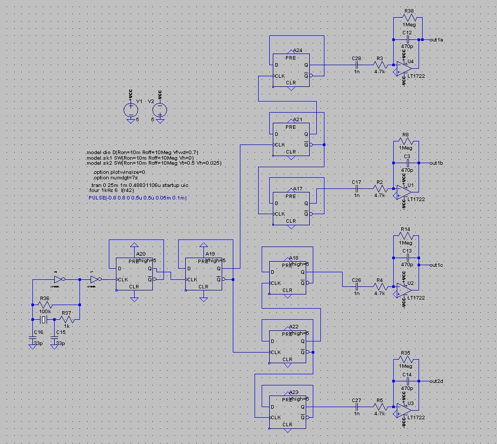

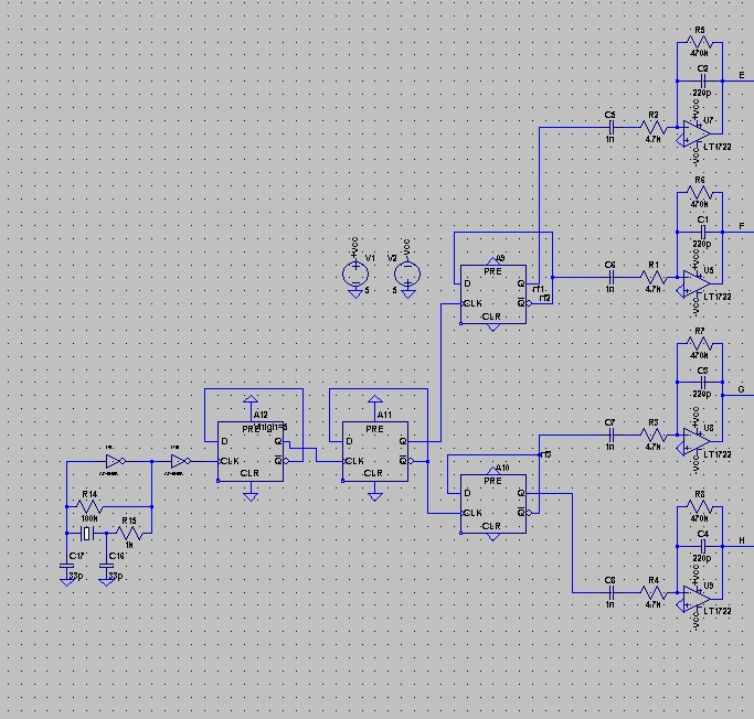

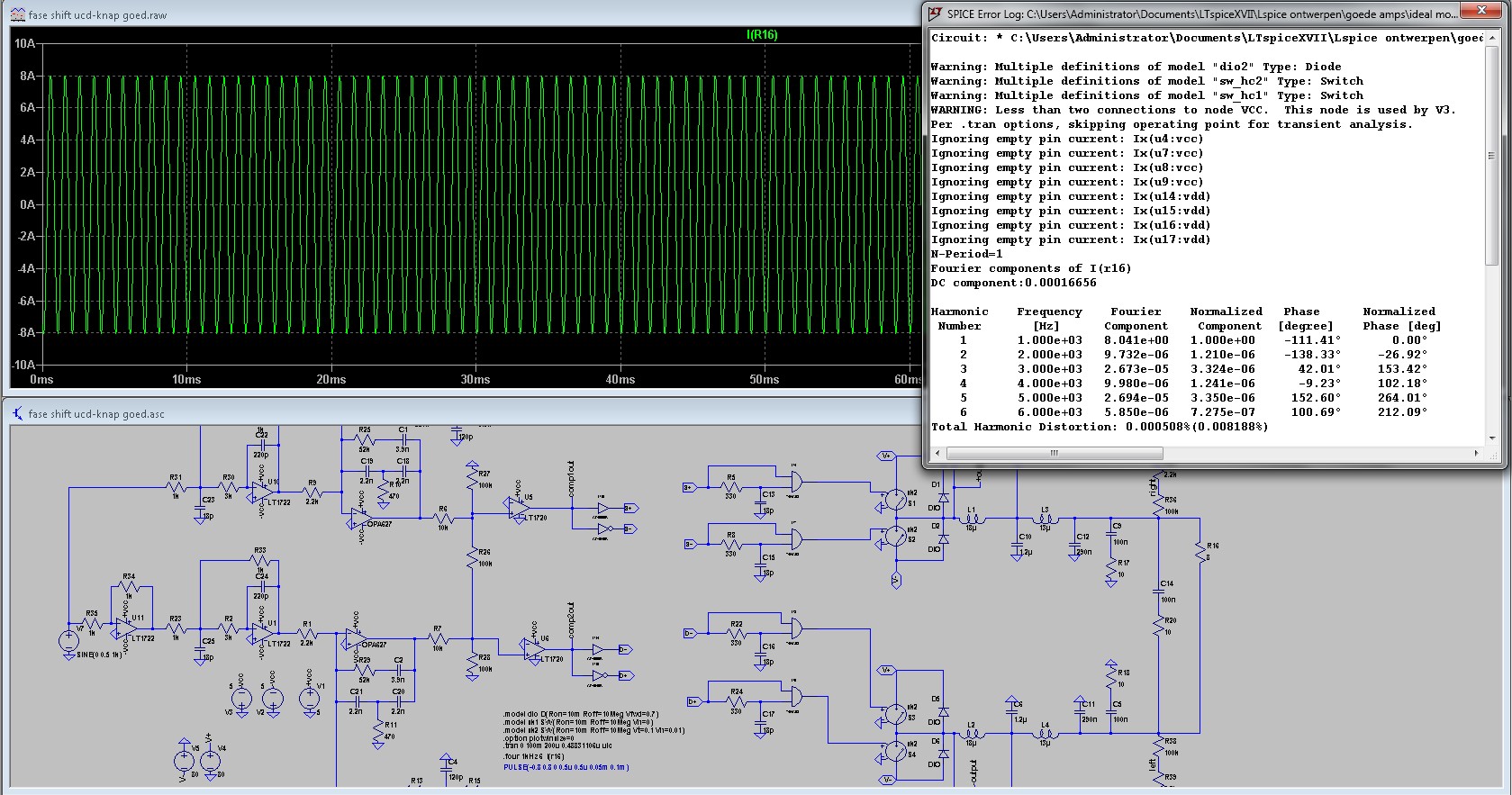

Hi Grizlek
I have two kinds of setups, leveled triangles, four above each other and the fase shifted versions.
The fase shift I did with flip flops and a clock signal.
However only the carrier multiplication is interesting, for normal home use and 500 watts, just a 3 level will do, but then I have only doubling the carrier.
Biggest problem with 3 or 5 level is crossover distortion, for 5 level there are two extra crossover points, for 3 level it is less complicated to cure that with offset into the comparators.

Hi Grizlek

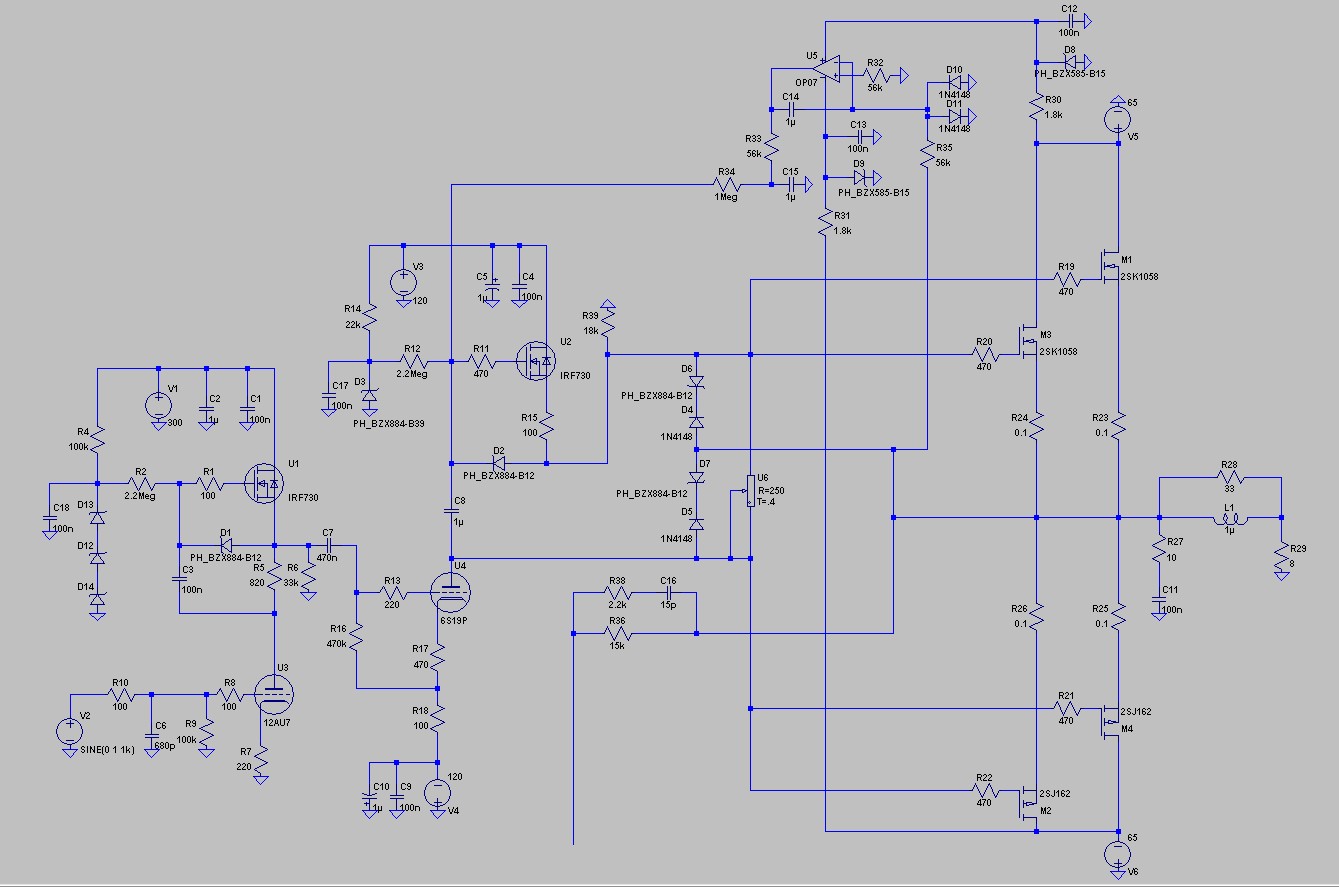

Can you explain more this hybrid, (last picture, why it works and sounds so good). This is your desing ? can you send LT spice file so I can simulate and see how it works (if project is "open source" of course). Whats the purpose of op amp ..What about THD, impulse response and other relevant LTspice results? Also how it behaves regarding clipping and THD, like TUBE amp or like transistor AMP.
Also could vertical mosfets be used for output stages, this lateral audio mosfets is very hard to buy there days (harder then tubes), also maybe SiC mosfets can be used, they have low gate capacity, but ...

Hi
The hybrid is not yet open source, because it go to be a selling amp.
I have designed it, and it do well in real time, already tested, the HD is -60 dB and have nice ear loving harmonics, it is open loop. I have a vertical version who has a beefy driver extra and a runaway correction but need to test it, never did.
The opamp is a dc servo, this is needed because tubes are bad in stability and it drives the mosfet in dc mode, no caps.
Yes I now about the sic, maybe a hybrid circlotron.
regards

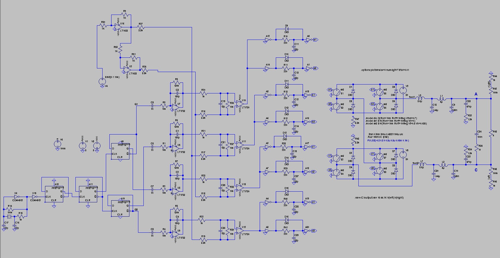

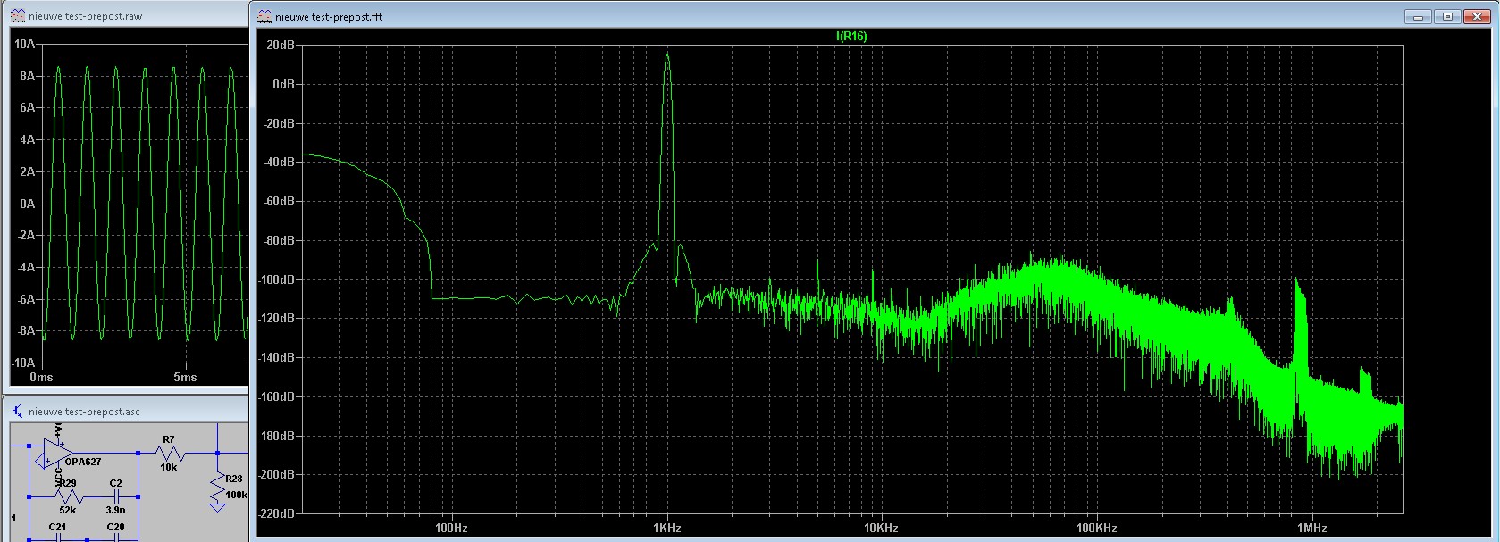

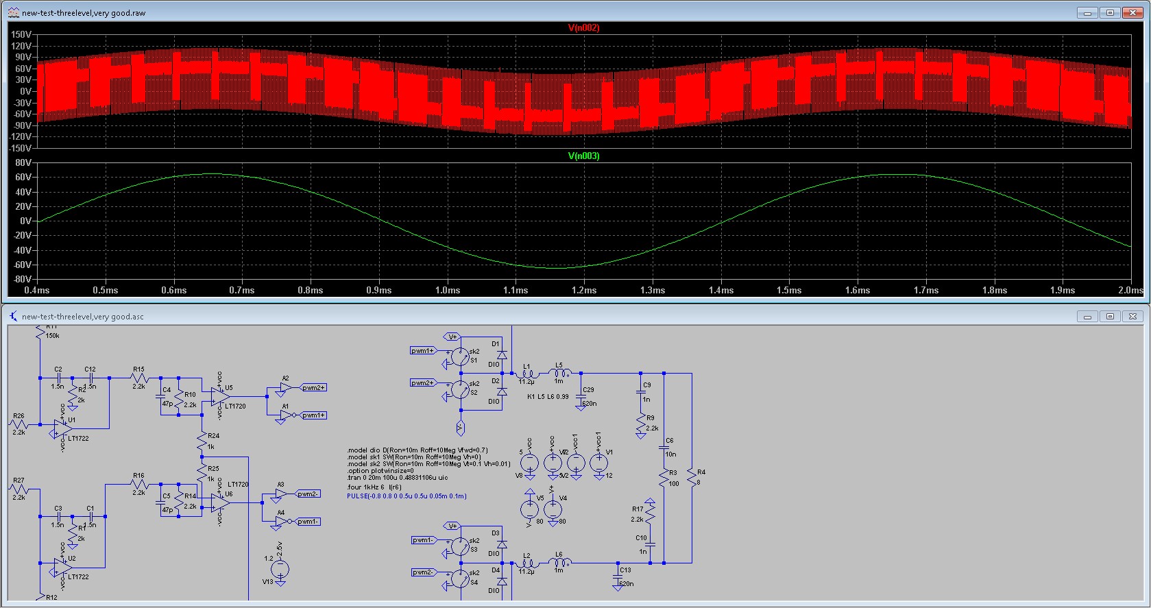

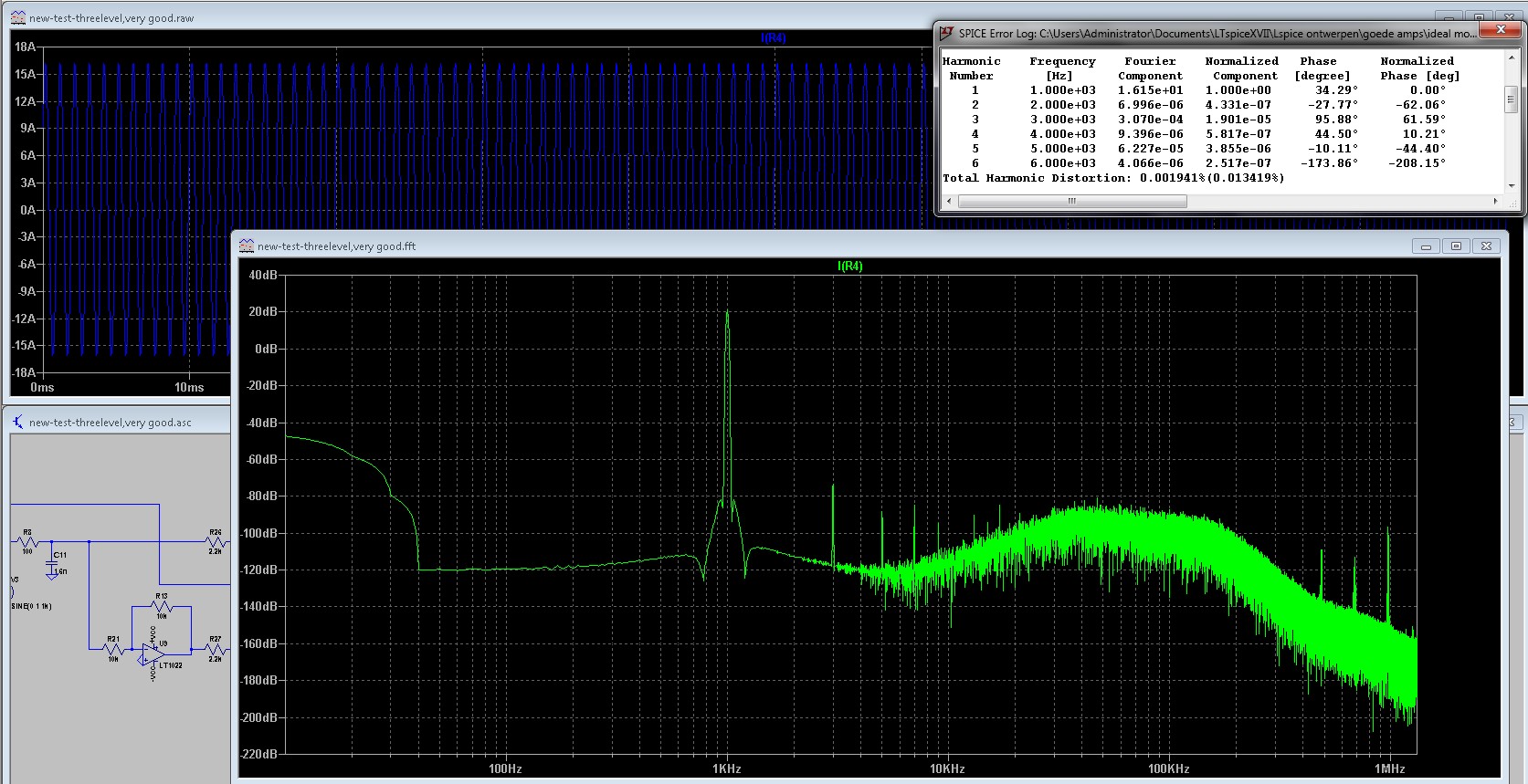

Forget the previous post, I did a UCD with a combination of integrator-PI and get a very low distortion, it seems to do wel in simulation, even with big dead times, I have used pre-post feedback.
It has low pass inputs keeping carrier out and it is a Fase shifted version with sync, doubling the carrier.
Also stable with clipping high bandwidth.

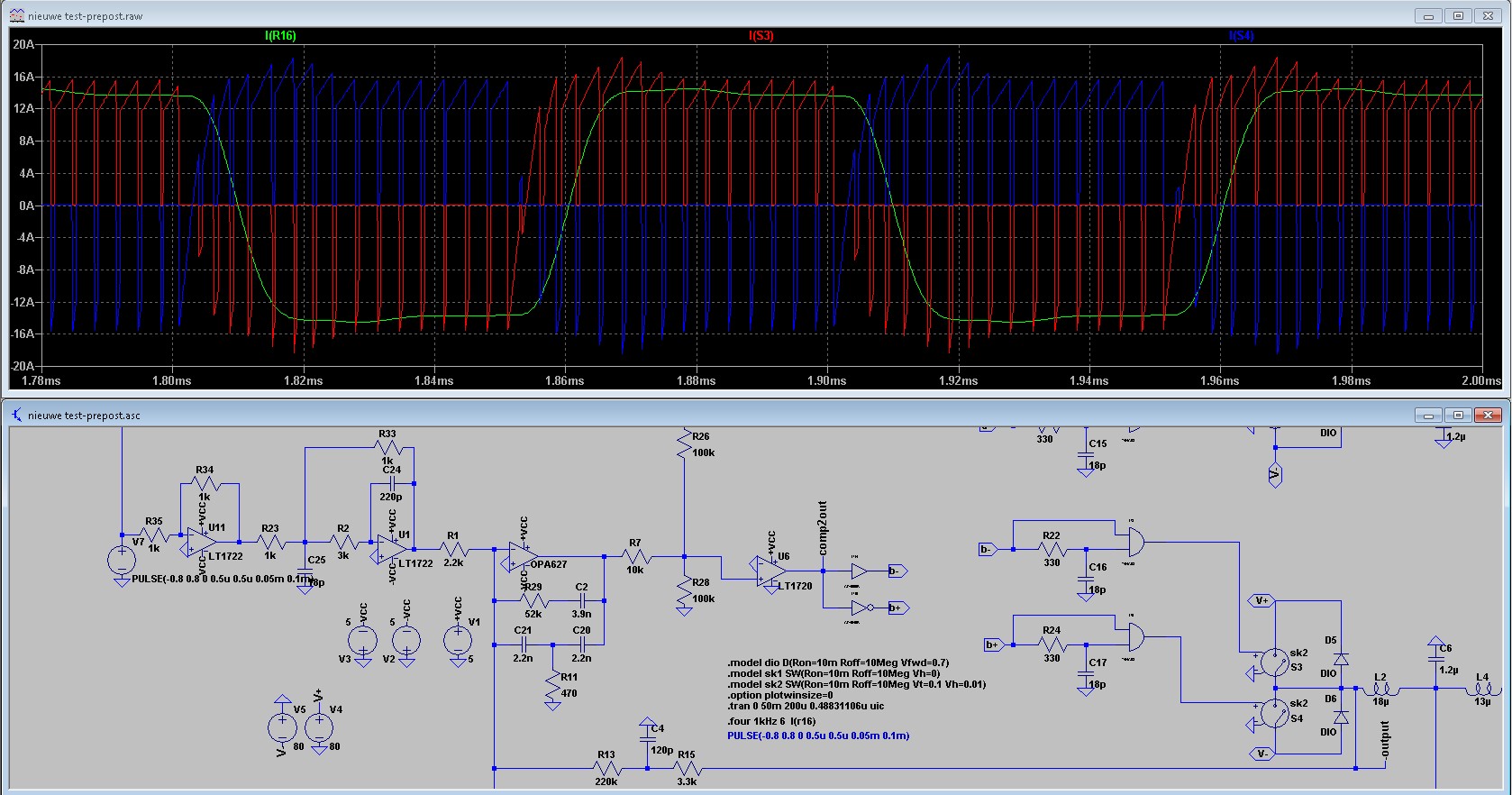

I have now I am waiting for parts, dis some sims with 5 and 8 level switching stuff.
The found stuff about the postfeedback with formulas do quite nice, I have use a 8 level, x 8 carrier is 2 Mhz and 100 Khz -3 low pass, maybe I can even go higher.
I do not now however how the switches go behave, because of the 8 levels, do go this into problems with audio, normally with a inverter for only 50 hz that is quite more relaxed then.
However I get with deadtime (if this is needed there?) quite low distortions, also on 20 Khz.

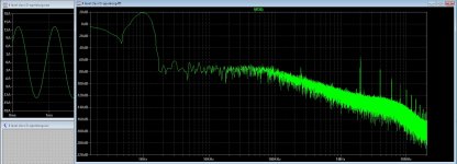

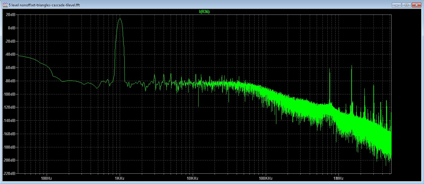

May we see the schematics of this 8 level ? Signals do look very nice

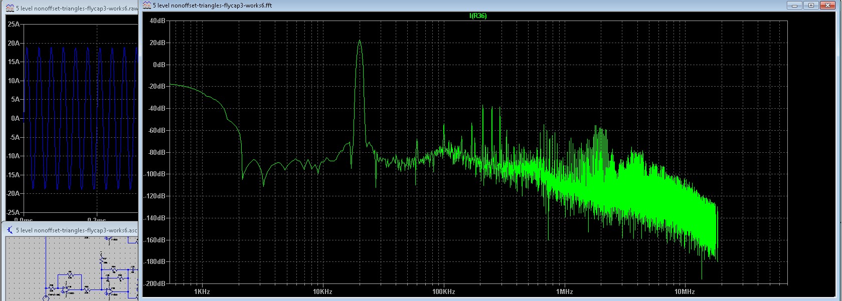

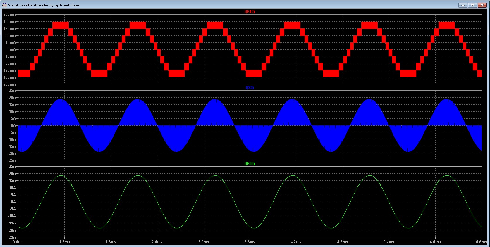

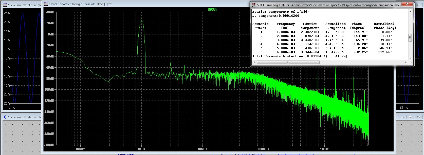

Grizlek here are the 5 level class D and the open loop distortion, it is sim so in real live things get much worse, or I am lucky if not.
have include also a twree level self oscillating version, just build it, I like to see how it works in real live.
The 5 level has postfeedback however making the feedback filter oke, it needs calculation, carrier is x 4, so 250 Khz get 1 Mhz, can use smaller mosfets power gets evenly divided over mosfets..
Lib's are to big for put here, search on internet for them. or go here
For LTspice users. Libraries of models, examples, etc
regarts.
How would you in real life make phase shifted triangles? And THD will be affected if that phase shift is good?
Maybe like this? or use a chip and program it in it, there are a lot of nice cpu's like a FPGA chip.
You can go read over multilevel inverters on google a lot of info there.
I think more then 5 level for audio is because of parts count maybe not such idea, but you can set frequency to 150 khz and get on output 1.2Mhz making even output low pas higher and get 150 Khz bandwidth amp, but it is complicated for postfeedback.

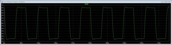

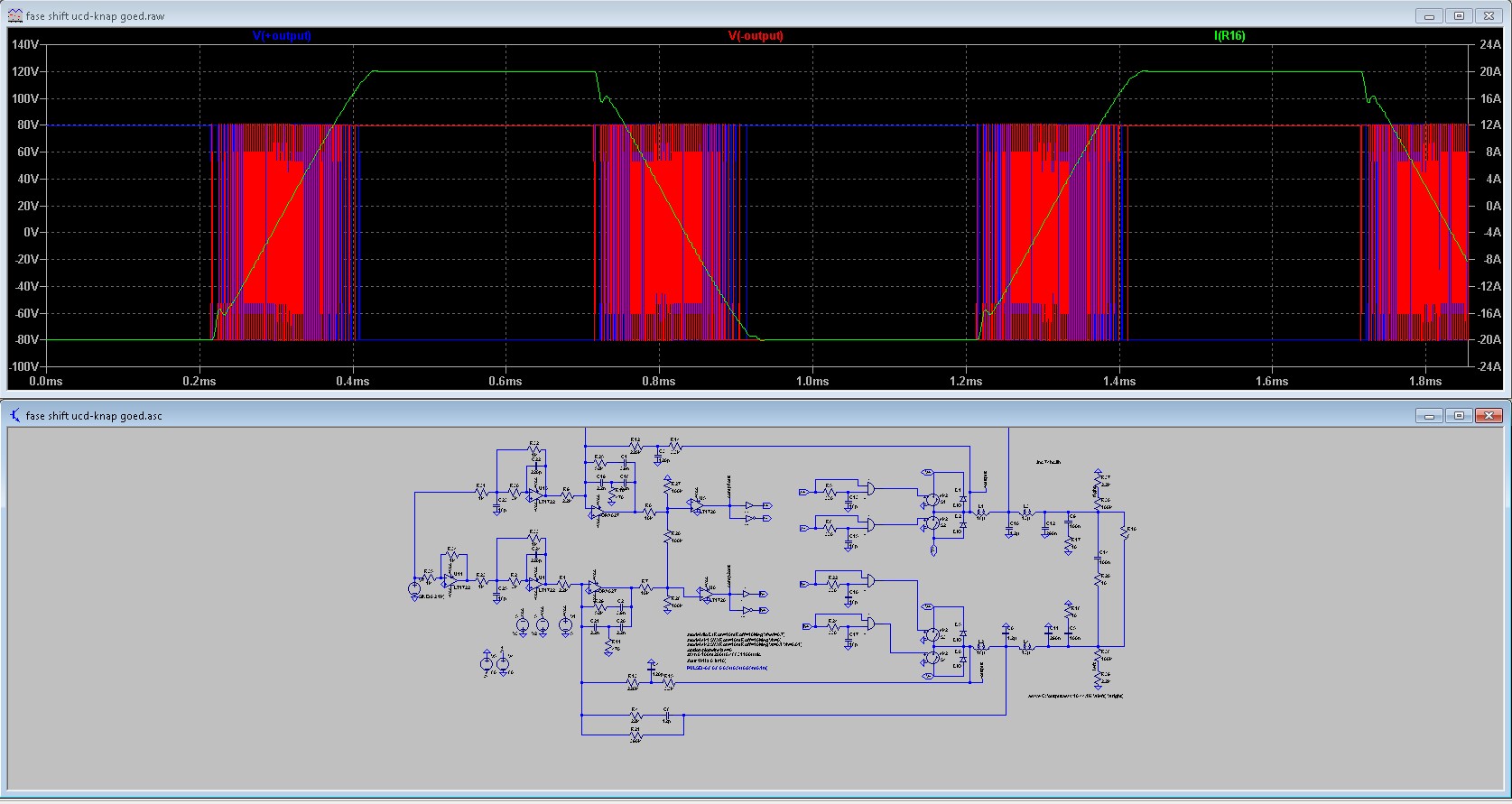

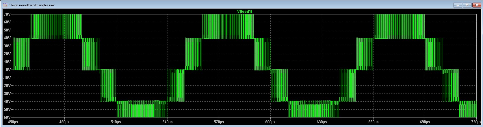

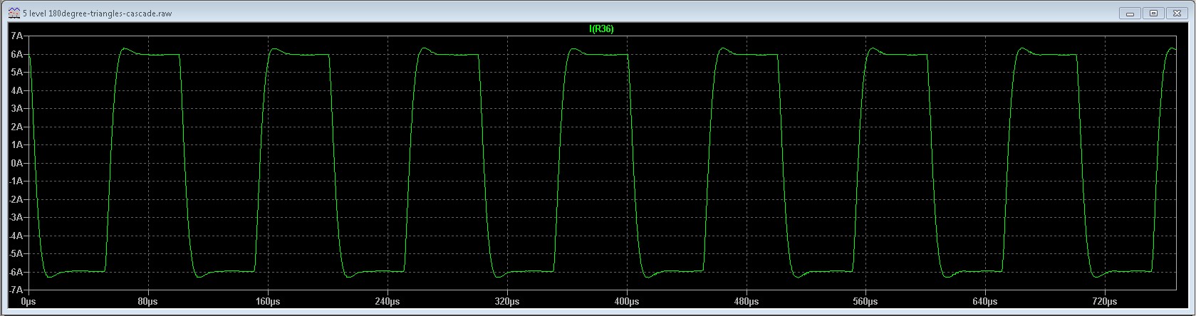

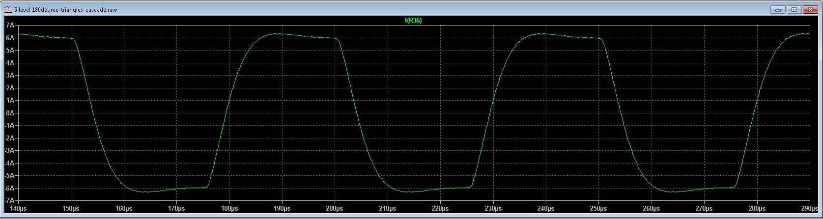

While the paint does dry on the wall I have play some with levels and faseshifts, the way I did now give a very nice open loop respons, I need however a cheap but very fast comparators, do you now what to use, I have the lT1016 here but are single ones, maybe better for test pcb making also.
Square tests are one 10 Khz and one 20 Khz.
regards

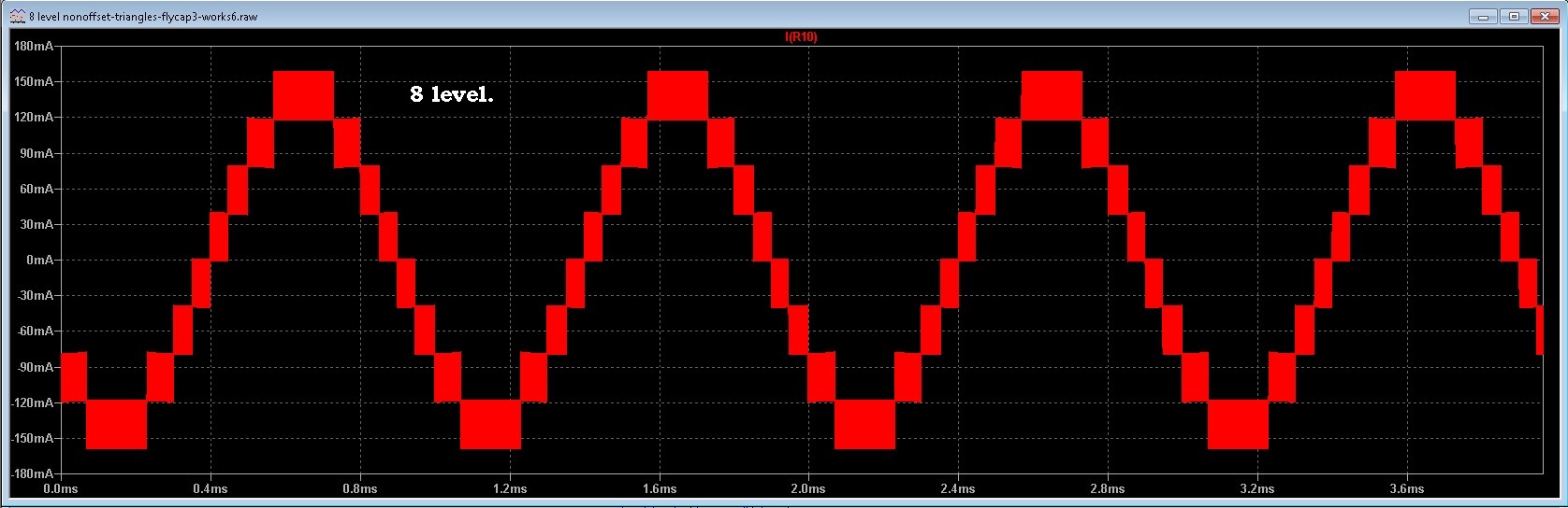

5 level ?
Yes 5 level, looks it suppress uneven harmonics as well, but think that this is not accurate answer of me.
I have also 8 level see pic.
I have ordered LM319 has two comparators in one chip and is 80 nS speed.
with multilevel I can use smaller mosfets, current get divided over all mosfets, and voltage can be much lower, as result, low nC .
regards
