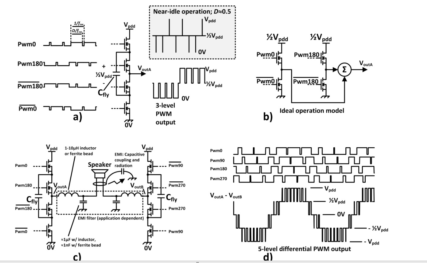

Yes 5 level, looks it suppress uneven harmonics as well, but think that this is not accurate answer of me.
I have also 8 level see pic.
I have ordered LM319 has two comparators in one chip and is 80 nS speed.
with multilevel I can use smaller mosfets, current get divided over all mosfets, and voltage can be much lower, as result, low nC .

Why not using 90 degree ? More level better results
see datasheet, you can set this chip to be 120 degree?!!

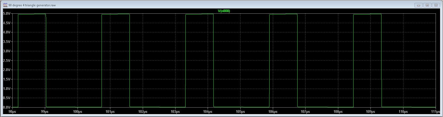

The amount of degree is not free to choose, it has impact on the switching pattern, the amount of levels etc, I use also differential input so it is better for feedback without a differential opamp, al do I doubt if a differential opamp between a dbtl and single input has much impact on distortion, think that we have very good opamps out there with very low distortions.

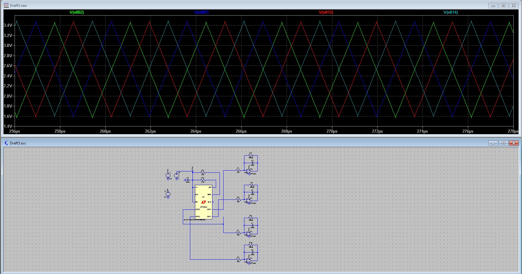

Hmm I have not read well then, the fase shift needs to be very precise, so can this chip do that with enough accuracy.
regards
This chip does 120 degree but the square is not symetrical and as sucvh not possible to generate a triangle.
best is a cristal clock and dflops, also for low jitter because it can be a problem with that chip.
regards

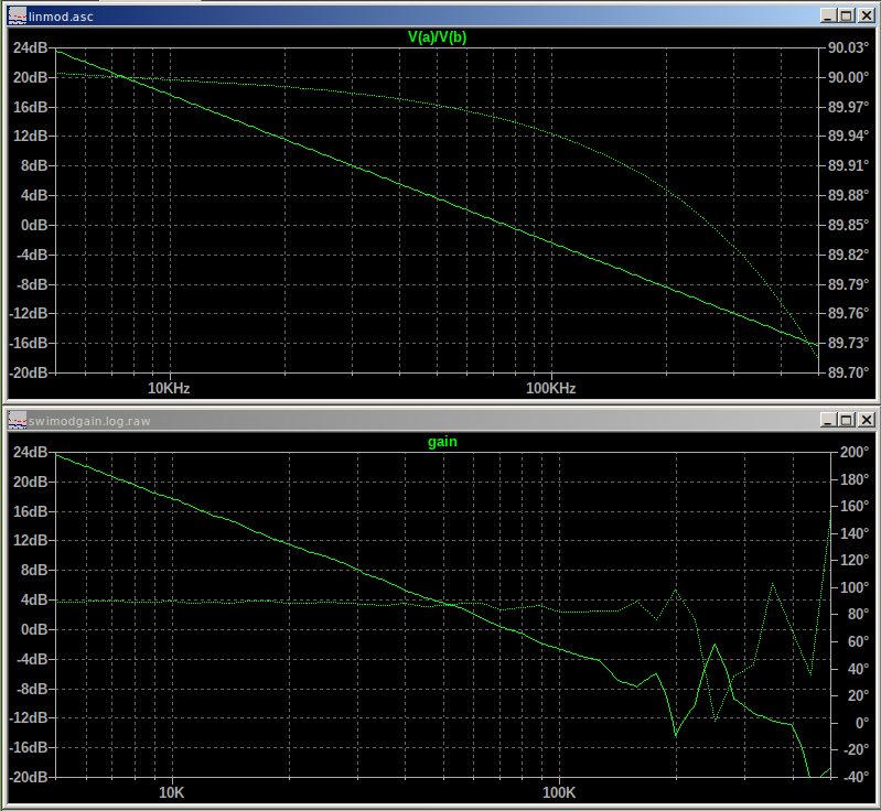

Do somebody who has experience with class d design can tell me how to find the unity gain point for a sampled amplifier like class d, in the papers she talk about nyquist distance, likne D Nyquist:=3.25 for a natural sampled amplifier sampling theorem applies here, unity gain point fT = F switch : DNyquist, somebody knowledge of that? I havd done with ltspice until output singal was unity, but then things get strange, it did work I get with 5 level a unity gain around 250 Khz, switch frequency is 1 Mhz, triangles 90 degree each are 250 khz, multilevel do multiply carrier x 4, do I need the multplyed signal for the Nyquist calculation or the triangle carrier frequency? I think the sampling is also x 4 because the lowpass sees 1 Mhz.
This is needed for further calculations, who I am not good at, with simulation it is not clear what and where the point is, so maybe you guys can give some tips or documents about it.
regards
Sure. Search for slope matching and average current mode control, don't focus on the word current. You should find some Unitrode, gobbled by Texas Instruments, application notes.

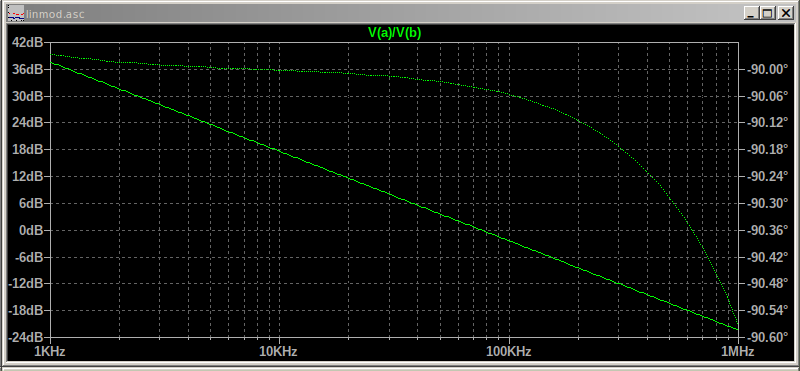

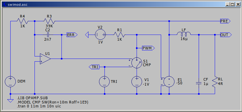

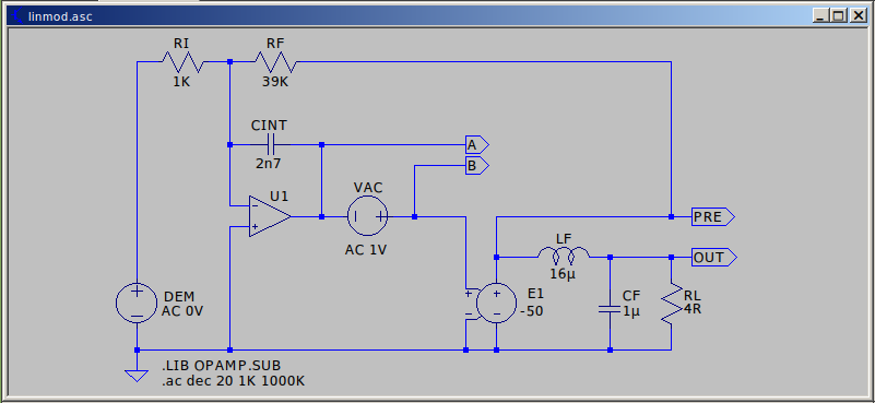

The following is not rigorous. However linear model attached. It assumes a supply voltage of +/-50V with a +/-1V triangle, 2V peak to peak, triangle wave using pre-filter feedback.
Pre-filter the signal is a rail to rail square wave. You have to convert it to a triangle wave for presentation to the PWM comparator. That makes your error amplifier a basic integrator.

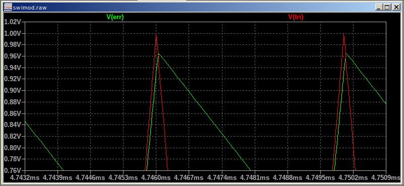

If the slope of the feedback signal exceeds the slope of the triangle wave then, with a latched comparator, you would experience sub-harmonic oscillation. 'Naturally Sampled' the PWM signal would turn into fuzz.
TRI is 2V p-p @250KHz. That gives a dVr/dT of 2V/2u or 1E6V/S. You have to consider the current through RF for twice the supply voltage or 100V. Do something with dV/dT = i/CINT. It works out to be 2.56nF. I've used 2n7 as a standard value.

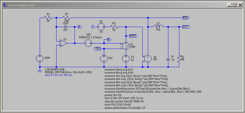

Loop Gain is measured by inserting an AC source in the Loop and plotting V(a)/V(b). Nominally crossover occurs at Fs/PI but the larger value for CINT knocks that down a little bit.
Next up a Switching Model.

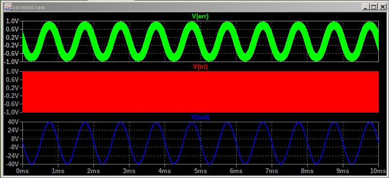

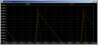

So... Here's the Switching Model. You will have to poke about to see some of the underneath bits. This is driven with a 1KHz 1V sine wave. Output post filter is 39V. Collecting V(tri) with V(err) you can see that the error slope does not exceed the triangle slope. Reduce the value of CINT and things will go Fuzz.

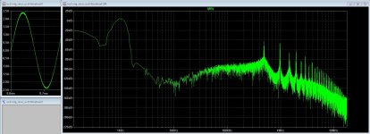

I need the solution for a 5 level pwm apmplifier, and I test a 8 level one, it has 4 triangles 90 degree shift, 8 level has 45 degree shift, as I did read unity gain is where signal is equal the input as that is the case by unity.
for clarity it is a natural sampled version with 5 levels, I have a controller who can give postfeedback. I have to find the unity point in open loop. it can be calculated with nyquist but with a 5 level do I use the carrier frequency or the multiplicated frequency (x4 = 1 Mhz) switching looks more difficult to calculate then analog..

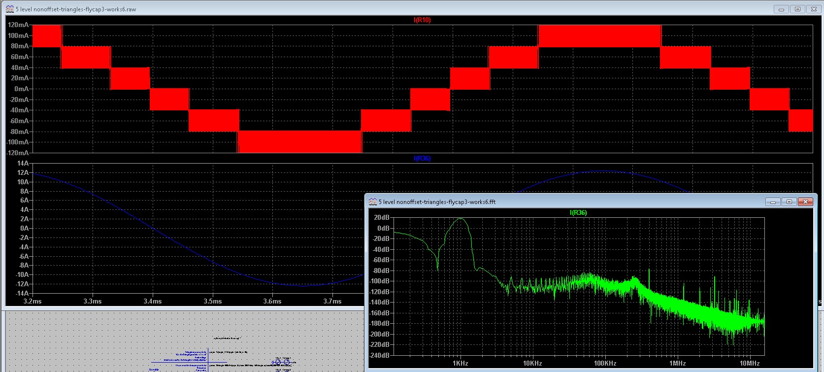

This is a time ago @Eva I have in the meantime did some more stuff, like multilevel systems. What concerns common mode problems who I did tackle with common mode coils who did cancel that, I had no common mode with 5 level versions of Class D, what was of concern, I need triangles, self osc do not work, and also when do post feedback, the fase get ruined and the multilevel action disturbing, so I have no multiplying effect but some extra carriers who do extend radiation to higher levels.
regards

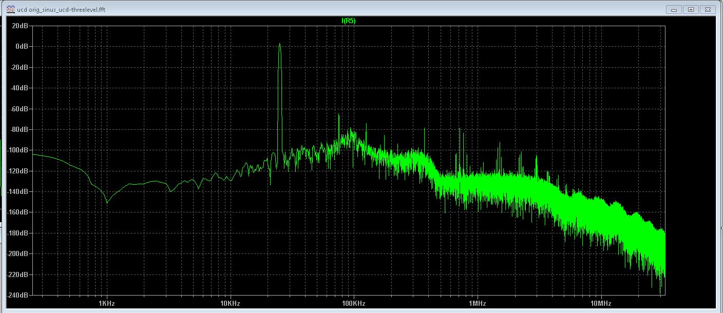

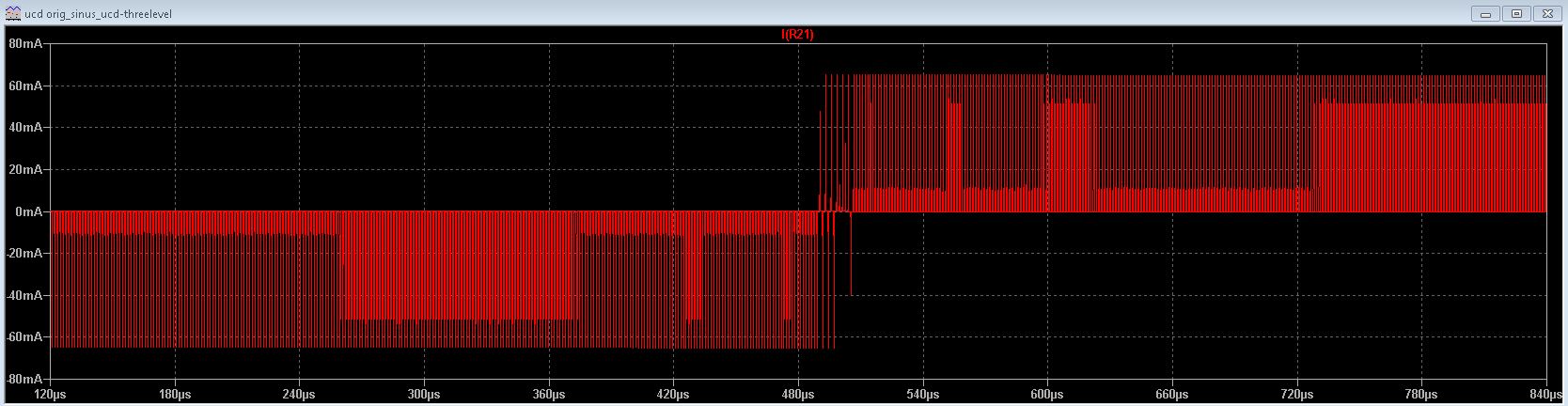

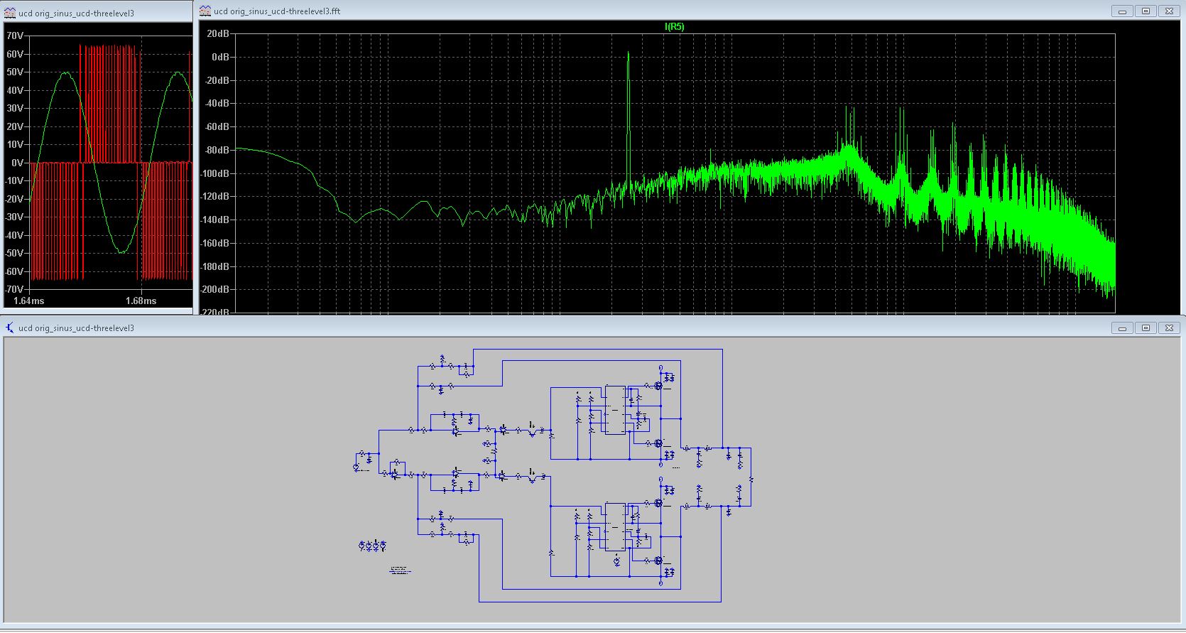

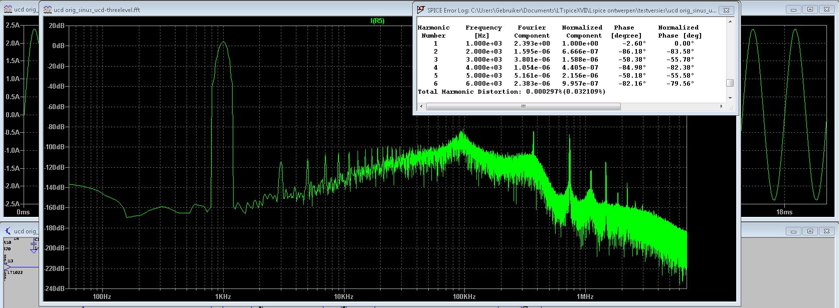

This one a three level I have done so that with a fase shift I get around zero voltage output pulses to prevent crossover, it does work and has very low distortion, not much difference with high or low output power or frequency. This one does very well, UCD with post and prefeedback. with fase shift. Witl lagre deadtimes I get -80 dB distortion figures.
With irs20124 model I get this, the other models did not work well, getting defcon 1 error, and as result I had to duck everytine I did simulate.
Is is a three level ucd version, pre and postfeedback.
