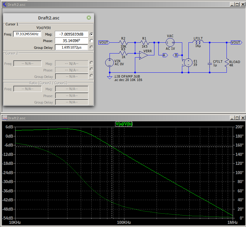

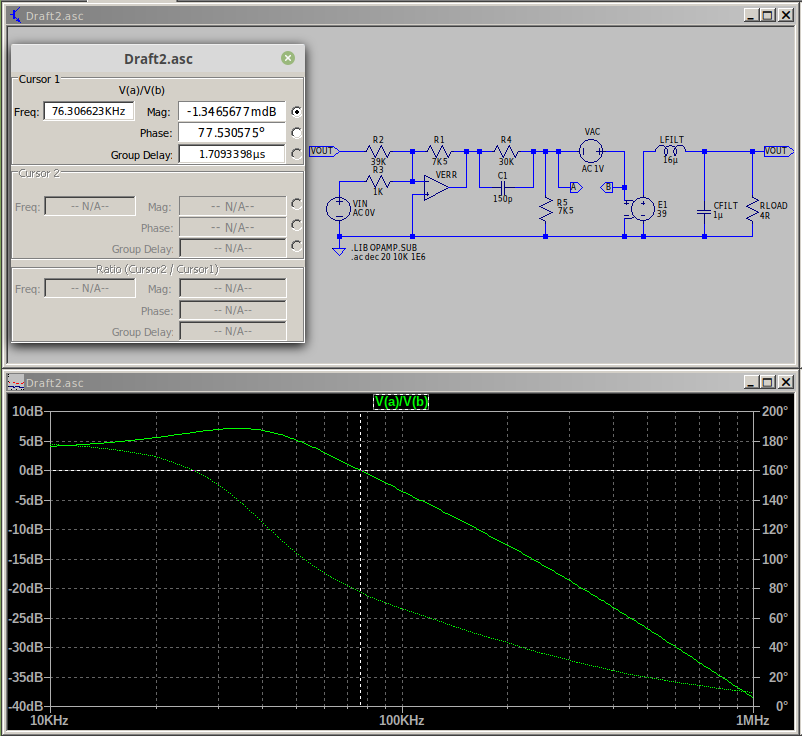

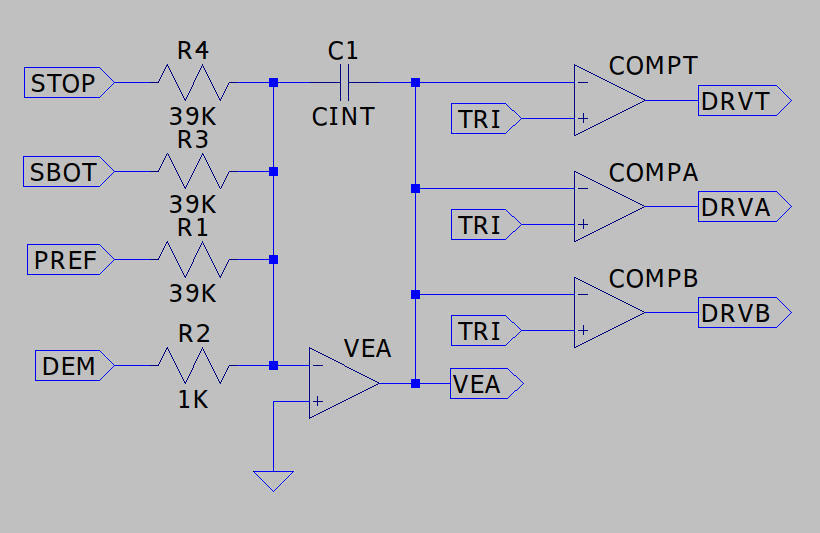

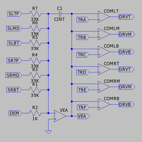

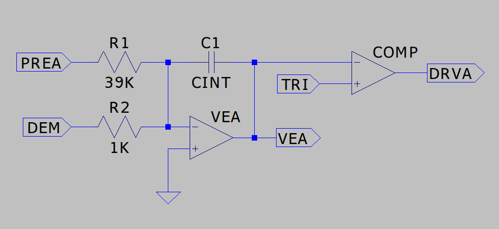

Consider the first picture. This is standard practice for Pre Filter Feedback. Values are nominal and the value for CINT is omitted. You calculate CINT such that the slope of the integrated output square wave matches the slope of the modulator triangle wave. At zero output the triangle at VEA is half the amplitude of the modulator triangle.
Under those conditions the loop crosses over at Fs/Pi. Single section.
In your half bridge, three level[?], instance at first sight things look slightly complicated due to the level shifts involved but it would appear that such shifts, top to bottom, will cancel. It also appears to be the case that the averaged outputs, top and bottom, are half of the main summed output.
Assuming this is the case then you can proceed with the second picture. CINT does not change. You just add in the extra resistors and comparators. You may wish to consider adding a DC servo around this section should you find that the Top/Bottom DC offset match is not precise. I would guess that would be unlikely.
Having become inconsistent. Switch Top, STOP, Switch Mid, SMID, Switch Bottom, SBOT and Drive Top, DRVT, Drive Mid, DRVM, and Drive Bottom, DRVB.
Assuming my suggestion about scaling is correct then the new resistors will have the same values as the original one. In the half bridge case your new crossover frequency becomes 2Fs/PI. Again this is strictly Pre Filter.
This is extended to your full bridge case in the third picture. Again I am slightly losing the plot over labelling but Switch Left Top, Mid, Bottom. Switch Right Top, Mid, Bottom and similar with the comparator outputs. Then whatever with the triangle waves.
Also just in case when I refer to Switch I am really referring to the associated switched nodes.
Again all component values remain the same. You just add some more resistors and comparators. This time your crossover frequency becomes 4Fs/PI or Ft/PI. Once complete then the closed loop response, DEMand to Pre Filter Output for the values chosen is 39 Volts per Volt.

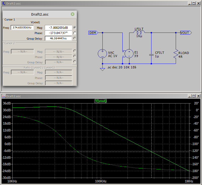

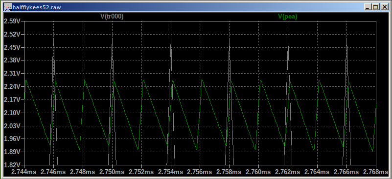

Plotting the control to output response you find out where the -7dB point is. That's because we are going to introduce a phase bump, similar to your paper, of 7dB in the external loop to cancel one of the filter poles. In this case it is at 375KHz. Your section switching frequency is 240KHz so your maximum loop crossover is 240K/PI or 76KHz. That sets the gain in the external loop at this frequency as (76/375)^2 or 0.04, at the moment the response is second order hence the squared term.

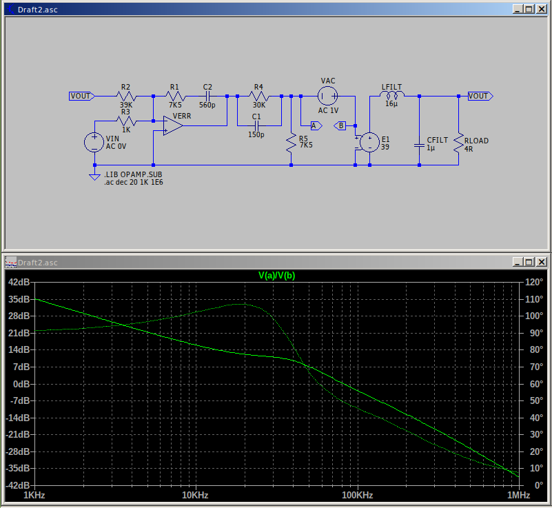

We end up with the fifth picture. Here I have used the trick of breaking the loop with VAC and plotting V(a)/V(b) to get the loop behaviour and -7dB point. R1, standard value, is low and we do not precisely hit 76KHz. Such is life and other things may matter more.

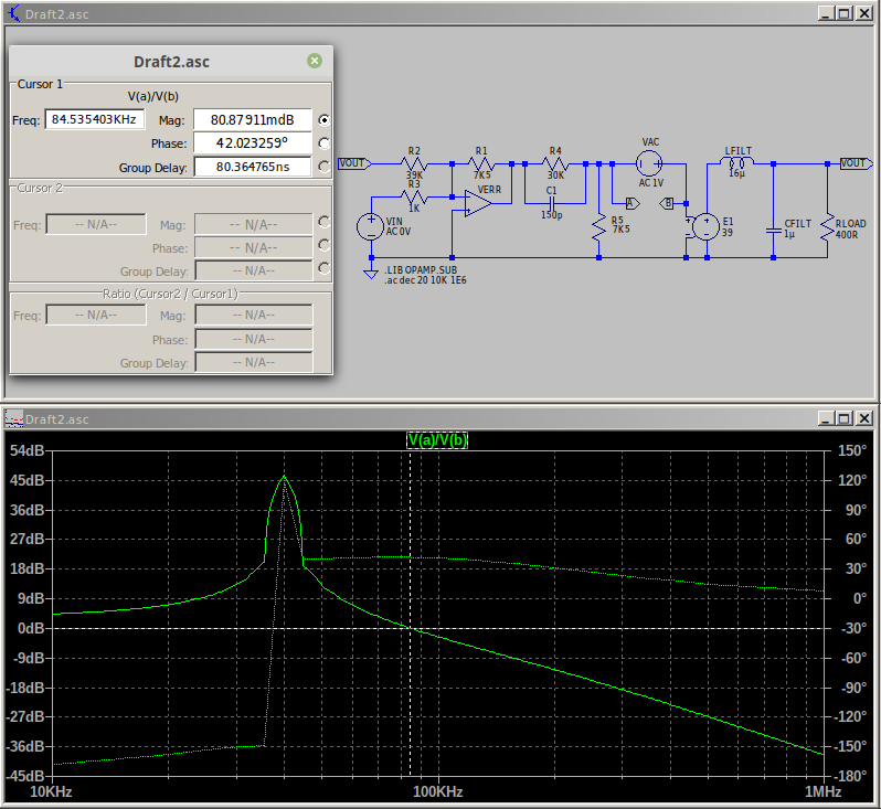

Now we add the phase bump as in the sixth picture. It involves attenuating the low frequency gain by a factor of five so we also have to increase the error amplifier gain by the same factor to bring things back. The capacitor value is chosen to have an impedance of 13K5 at the desired frequency of 76KHz.
The point... If we unload the filter as shown in the seventh picture then crossover is still occurring with 42 degrees phase margin as a result of the added phase bump and therefore we hope that the system is still stable.
We also get to nominally break the DC path, add a pole, around the error amplifier as shown in the eighth picture to improve the low frequency performance. In this case at about 40KHz but caveats here and elsewhere.
The almost don't care in respect of ignoring Ft/PI given you are limited to Fs/PI assumes the closed internal loop will not contribute phase shifts to the external loop. For Ft = 4Fs that assumption might be valid. Ft = 2Fs probably not. Also breaking the external loop as mentioned above robs phase margin.

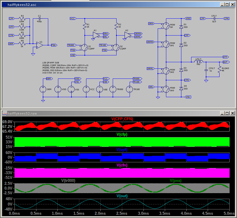

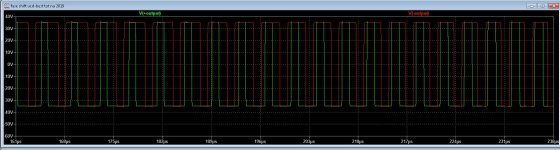

Here's my attempt at your half bridge.
You'll notice that my model is very much simplified and, for the moment just includes the proposed Pre Filter Feedback. I was more than surprised when it worked first time.
My original suggestion as to scaling of resistors was slightly wrong. You have to ratio them 2:1. I hacked the slope matching in Spice as well.
The performance looks a bit dirt. Maybe I got something wrong but...
Have a poke about.

Thanks for the help, Do you now a good mosfet driver ic for use with multilevel? I have some worries about the bootstrap circuit when I get multilevel, is it fast enough to provide the voltages in such a ic, I think it works because more people are use them in inverters.
Thanks for the help, I go simplify also the system, using models in stead of complete ic,s. You have clearly much more experience with LTspice then me, and learn it at mine age 62 takes longer as normal.

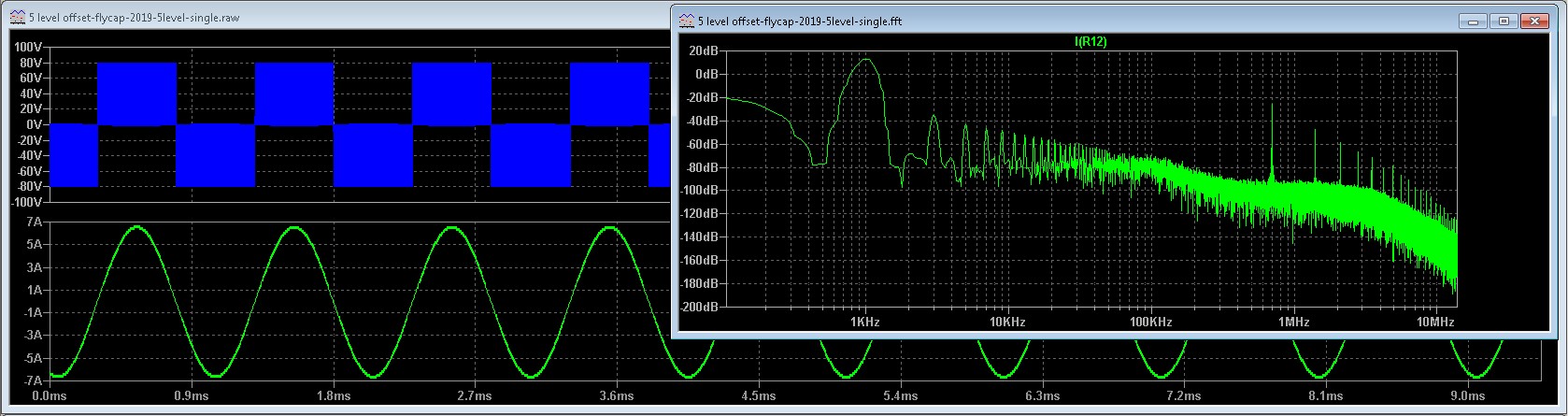

I do now the circlotron who starts again when weather get less hot, sitting behind a soldering iron with 32 degrees is hot, like today, so it is fall project (hybrid amp, autobias).
Your design do the same, the multilevel switching get bad with feedback and a extra faseshift that it cause, only the multilevel btl with slef oscillation do work, the faseshift is because the triangles do not get changed, maybe a faseshifting there can repair the switching, with self oscillating it do that automatically and do multiplying the frequency.
I have included the feedbacked self oscilating type, probe the resistor on the output before the filter to see it.
Stil it is that feedback multilevel is not that easy except self osc types until three level noth higher.

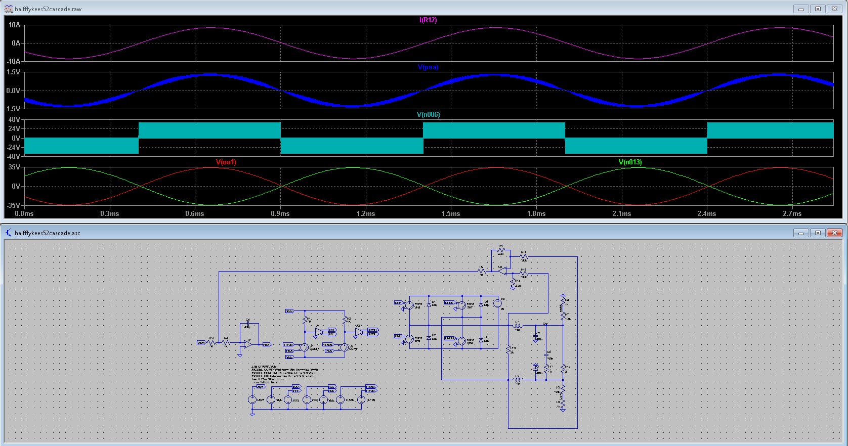

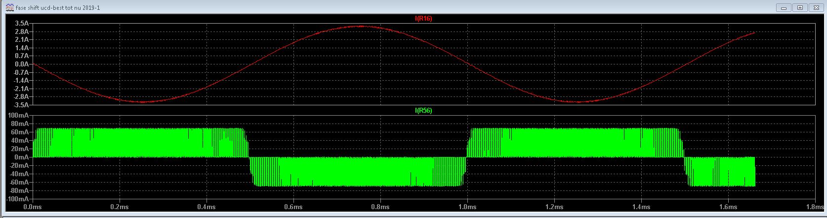

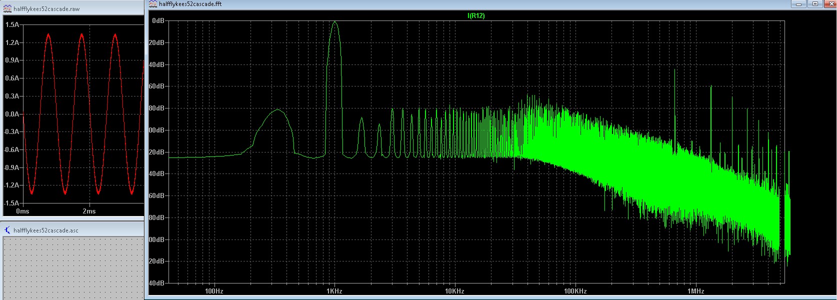

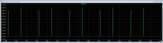

Here I have test with cascade stages, this does better and is open loop already nice.
Do you setup your schematic for deadtime?
When you try it, set the opamps vack because I had use models, and you did universal, need fast opamps. First plot op pic is openloop test, rest is feedback with two integrators.

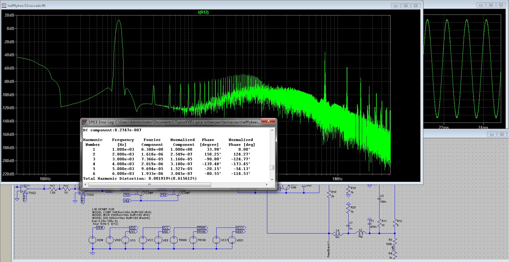

What means the numbers between brackets into the ltspice harmonic distortion plot. And why I have such a lot 3th harmonics? deatime maybe?.

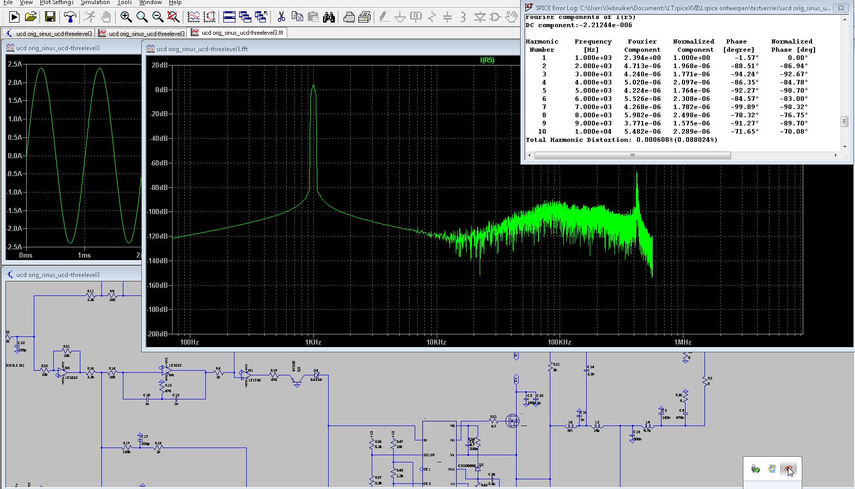

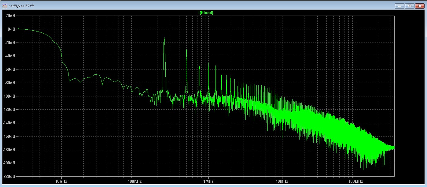

There was a long thread (initiated by myself in September 2014) about the second THD figure in brackets in the Yahoo LTspice users' group: Yahoo! Groups
The consensus seemed to be that the second, bracketed, figure is THD for all harmonics, compared to the first, which is for the specified number of harmonics, or for 9 harmonics if not specified.
For example, I have just run four .four analyses on a circuit:
.four 1k 10 V(out) yields 0.001468%(0.013915%);
.four 1k 100 V(out) yields 0.003776%(0.014504%);
.four 1k 1000 V(out) yields 0.014494%(0.014507%);
.four 1k 10000 V(out) yields 0.014505%(0.014518%).
These figures would tend to confirm the conjecture that the bracketed figure is THD for all harmonics. There are, however, minor inconsistencies to be aware of. For example, in this example, why are the four bracketed figures not identical?
In the case of your circuit, you have only measured THD for six harmonics. The fact that the bracketed figure is so much higher than the first suggests that there is substantial distortion showing with high harmonics, though I wouldn't like to comment on whether distortion at such high frequencies is audible or not.

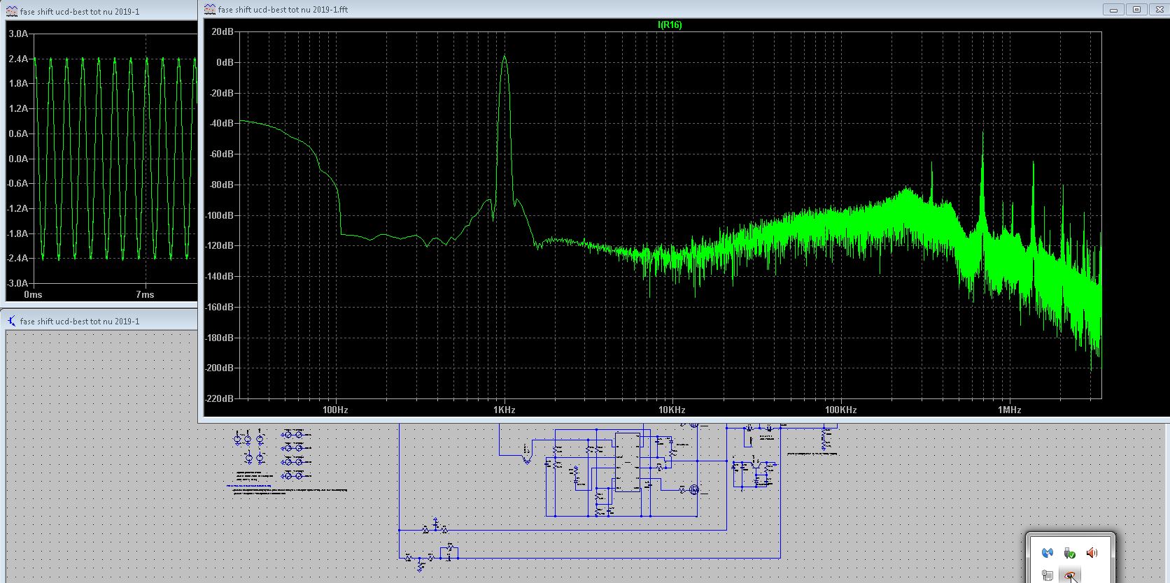

Hi all
I have now get 10 x 20124s ic, but when I do simulate it, I have the model, it looks it goes into protection mode when I have 65 volt rails on mosfets, with 35 volts it works, OC resistors? when I do the 12 volts on the chip through ground and not the -65 reference then it works also. I have also uge shoot through I do something wrong and need a solution before the pcb starts. I have now 3 projects😀 Or the model is just wrong and need real live design.
something to do with the OC inputs? do somebody now to correct this.
thanks.
kees

I have found the error, the bootstrap diode was to slow, I did need a fast recovery type, then it does work.

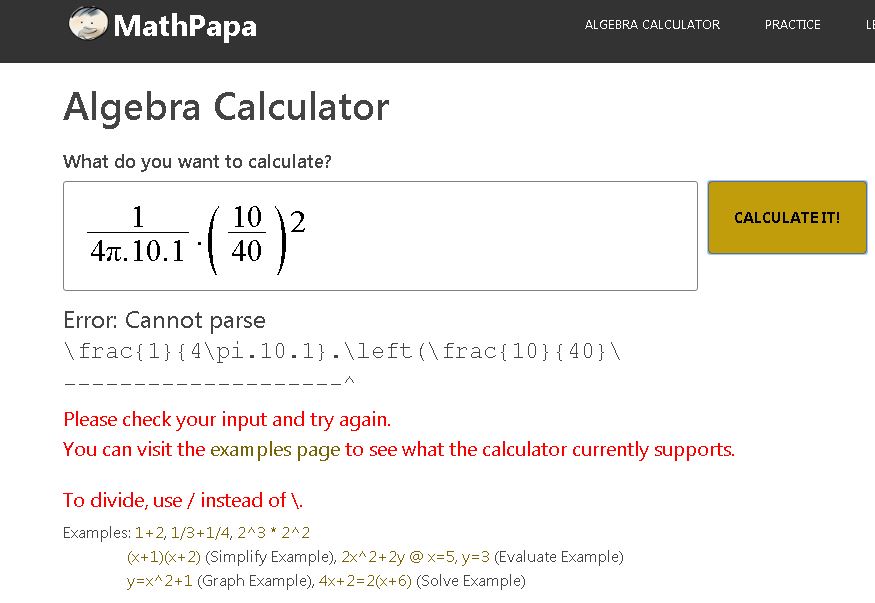

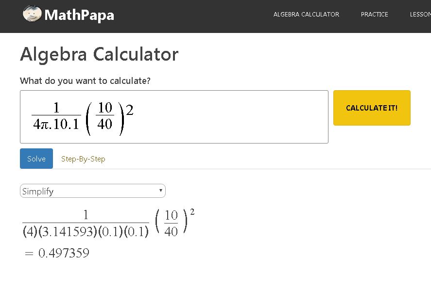

I have now find nice calculation program on internet Mathpapa Mathpapafault.jpg is to let see this site does correct and advice also, nice.
Equation Solver - MathPapa
There I can fill in firmula,s as it is written by most designers and professors, nice stuff helps a lot.
For the class d I have done now with the UC20124s ic,s does very nice in multilevel, have post and prefeedback with faseshift network.
Pic,s are the calculator and the sims.

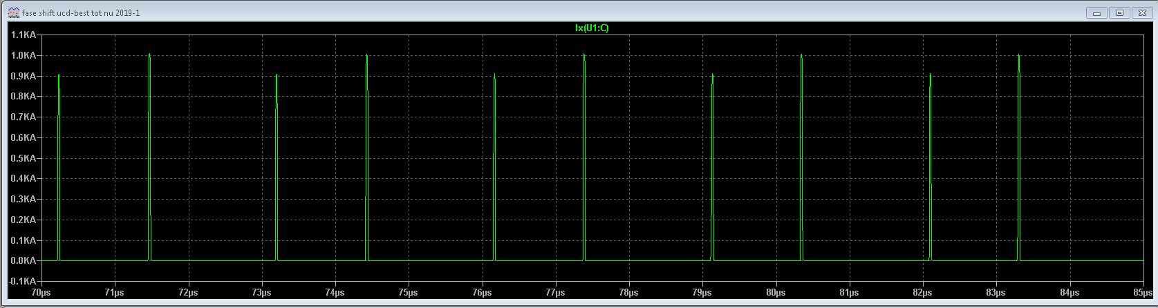

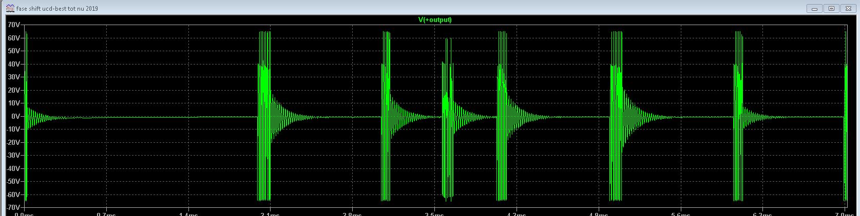

This distortion do not show up in the plot itself?, that is little weird. But maybe I do wrong understanding LTspice.
I ran the .asc file you posted in #147, and it was still running after 56 minutes! Either you have a lot of patience or a very fast computer - my own computer, like myself, is somewhat on the slow side...
Anyway, I added a few commands to your file, which both increase the accuracy and reduce the running time to around 30 seconds. The parameter fft can be adjusted to increase accuracy at the expense of time - if fft=2**20 the sim takes arund 90 seconds but the accuracy is increased - but it only makes a small difference to the .four result. The file is posted below.
Just to avoid any confusion, the figures I quoted are not those of your circuit, but from another circuit of my own. The intention was simply to show that the greater the number of harmonics included in a .four analysis, the closer the two distortion figures are. This was in response to your question about why there are two THD figures given in a .four analysis, with a higher second figure in brackets.
In the case of your circuit, and referring to the third image in post #147, the Error Log shows distortion of c. 0.0019% measuring the first six harmonics only. The fft plot shows that the first six harmonics are indeed at a low level.
There are, however, artefacts of the switching frequency showing at a much higher level at c. 600kHz and above, and these are the reason why the second distortion figure (in brackets) is much higher, c. 0.62%.
What I can see is that the even harmonics are at a very low level, hidden beneath the noise floor, and the odd harmonics are at a higher level than the evens. I can't see that the 3rd harmonic is at a high level compared to the other odd harmonics.
I'm sure you are aware that a harmonic profile like this would typically be associated with a symmetrical circuit.
This I am aware of.
I'm sure you are aware that a harmonic profile like this would typically be associated with a symmetrical circuit. Also the dead time is quite of influence of that 3th harmonic, maiking that tight that thrith get under -110dB.
Your writing was clear, and it was a question why the second between brackets are for, now you have explane that I do not why, it it is from the higher 600 Khz then it is not of concern for me, the design is a three level and it does also double the carrier maybe also here is a reason for that plot.
I do now that is not for mine schematic I had some questions about that second plot I did not find, but have info now thanks.
Thanks for the reaction, and do now, I am not a LTspice professor, I do not know much only the basic stuf.
I can't give a specific example but something I am working on at the moment throws up an indication as to the cause of the nature of your plots not showing the distortion components.
My circuit incorporates a DC servo and if I do not allow time for it to settle prior to commencing logging of data, for example .tran 15m 10m 1n uic, the low frequency result in the FFT shows the same slopes either side of the 1KHz test tone.
Your circuits include a number of large value flying capacitors that are likely to produce such and effect in that it will/may take some time to acquire the correct average, DC, operating voltage.
I have noticed that in your .tran statements you appear to regularly miss of the .uic, Use Initial Conditions, directive. As a result the analyser tries to guess an initial DC operating point which it is likely to get wrong and also spends a lot of time trying to get it wrong.
That also appears to hurt the speed of the subsequent transient analysis.
For switching circuits such as this I always include the uic directive and in the rare cases where it loses the plot I will include IC statements for the suspect components. Generally those will be inductors and capacitors.
For a capacitor CTRL Right click and in one of available lines add IC=200V. If that is the wrong way up rotate the capacitor the other way or use IC=-200V. Make sure that uic is checked in the transient statement.
