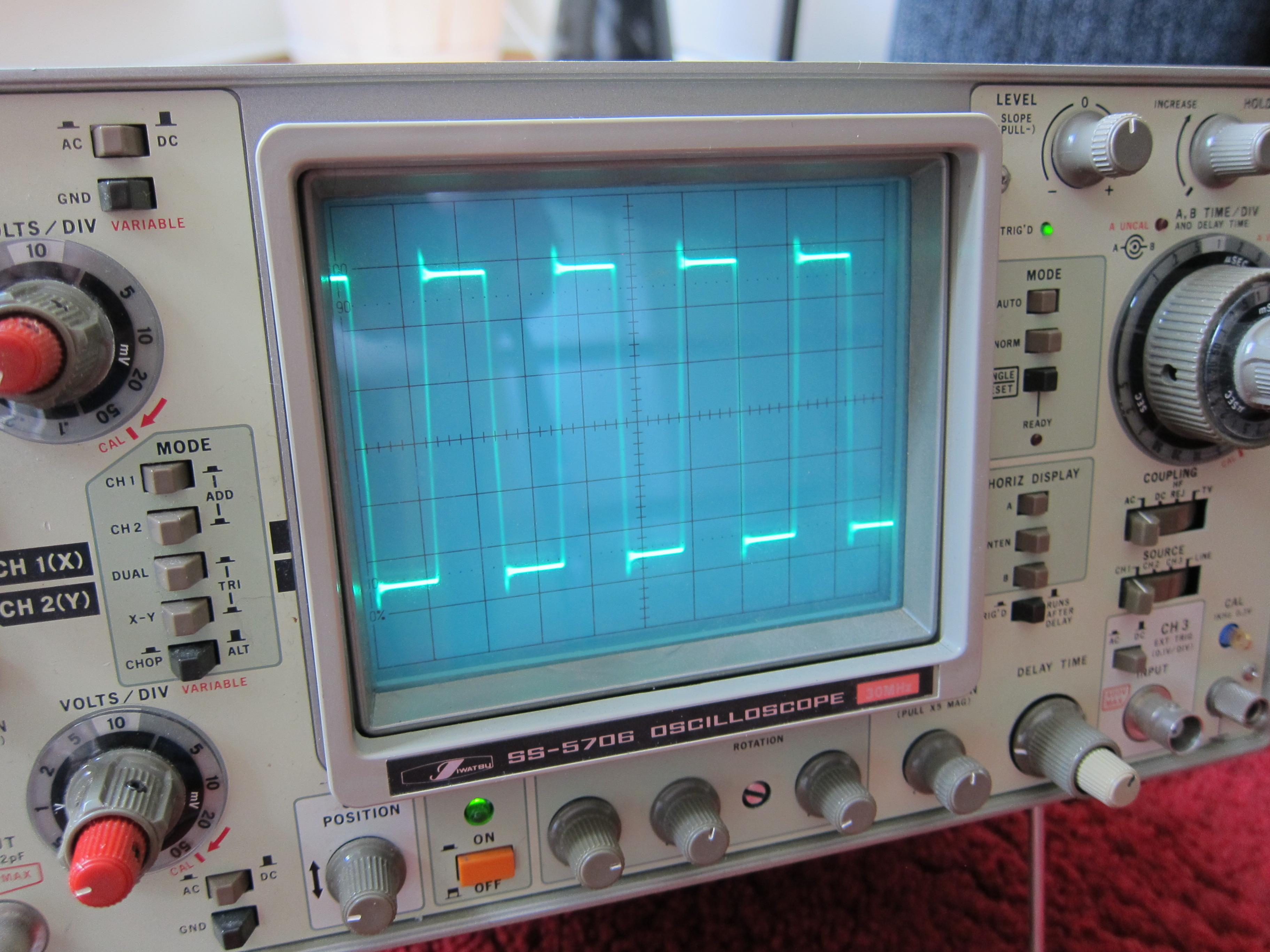

Sorry, I misread the oscilloscopes 1 uS/div scale, 400 KHz is a more correct value!
Still high, apparently. Can be the uncalibrated old scope.

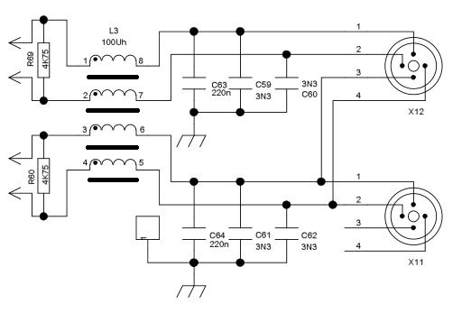

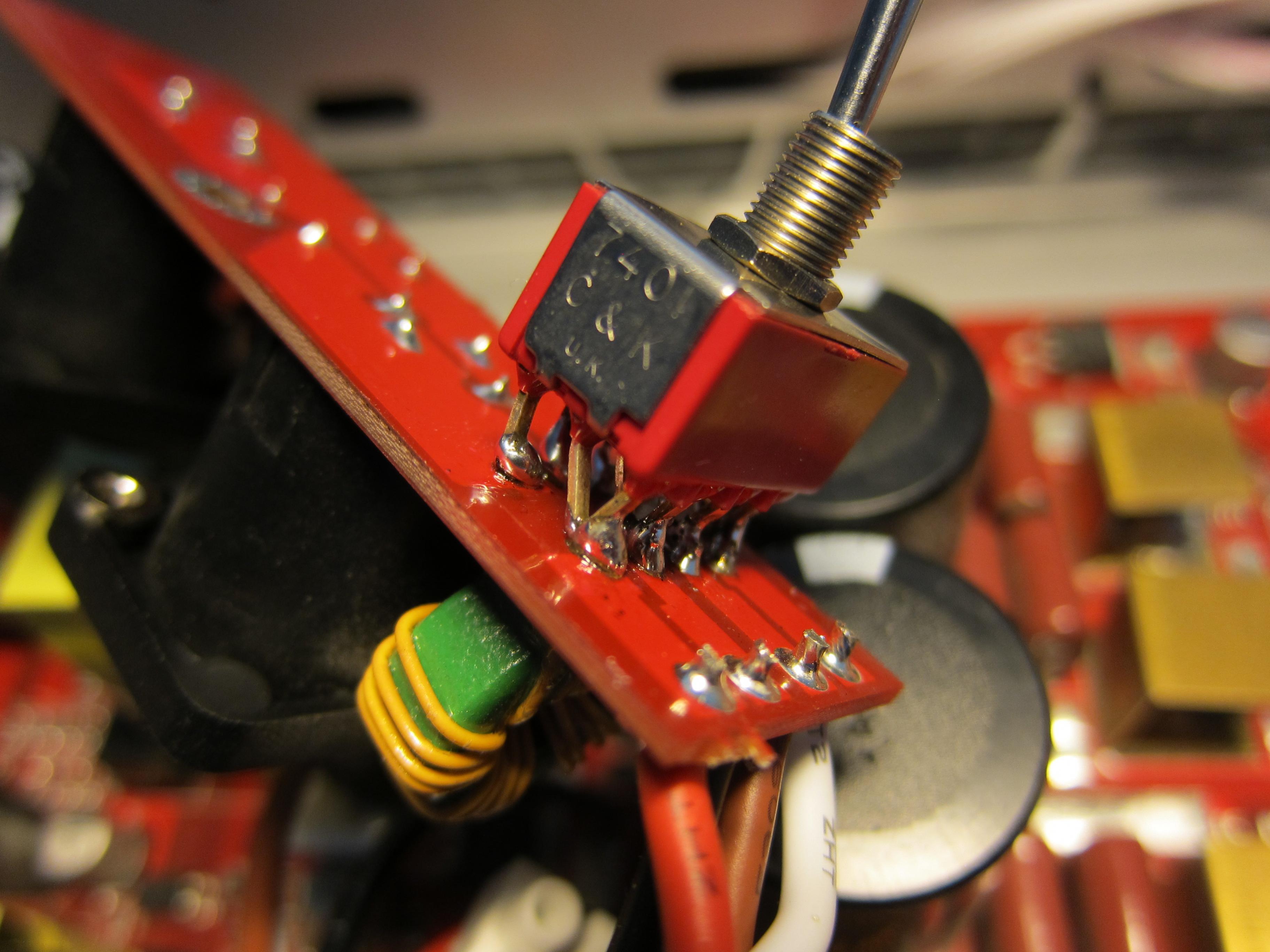

On the output board there's a ferro core with 4 separate windings. See picture and diagram. In my opinion, this will connect left and right channels with each other inductively. I'm familiar with Tina and P-spice, but I think this one will be difficult to analyze/simulate, involving two channels.
I shortened out the inductor with 4 jumpers(see picture), and measured again.
The noise is the exactly the same, but phase went from -180 deg to +180 in the same freq region. The sound now is improved, with more open/airy treble.(but not as good as my beloved Nad M3)

I guess the 100uH 220nF outputfilter does behave overdamped when load is below 32 ohm around 30kHz. Removing the outputfilter inductor: running a 400/800/3000 watt class D amplifier filterless could be considered.......... at least a bad idea.
OK so probably not entire outputfilter in that pic.

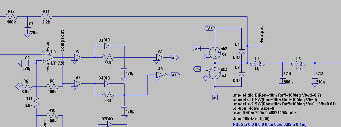

I have try these ones, however despite I have plus and minus 5 volts so ref is 0 volts the swing of the audio is only on negative side, This is what I want to ask why, because I see it is not as simple as it looks this D technology, I manage to get low HD, I do try get low HD without feedback and a full bridge.
It,s output voltage is not well, I did try a ucd feedbacked one who did work, so fellows, is there a teacher here for me😀 Normally we need to put the audio 180 degree for full bridge d amp, but is it also needed to flip the square output of the power mosfets? to prevent cancel them out..
In last pic you see single ended amp, strange it does only swing in negative part, while I have symmetrical supply everywhere.

I'm not sure what is going on there, yet a hunch is there might be duplication of more circuitry than should be done. I would use only one set of analog audio circuitry and then once the signal is level shifted down, use fast switching to produce the inverted and noninverted signals for both totem pole MOSFET drives. Something like CMOS logic chips to derive the inverted signals. I've done a circuit a bit how you are doing it, but with only one set of analog audio components, and it simulated well. It was a long time ago, so my memory is only general.
Something I just noticed is that your UcD version worked. It turns out that is all I have been using, even for years before I became aware of Bruno's patent, 100% post filter feedback, for as long as I can remember. It turned out that I was simulating almost identical circuit to the one in his patent artwork. I attribute it to lucky? chance and perseverance in my obsession for high power bass production almost twenty years ago.

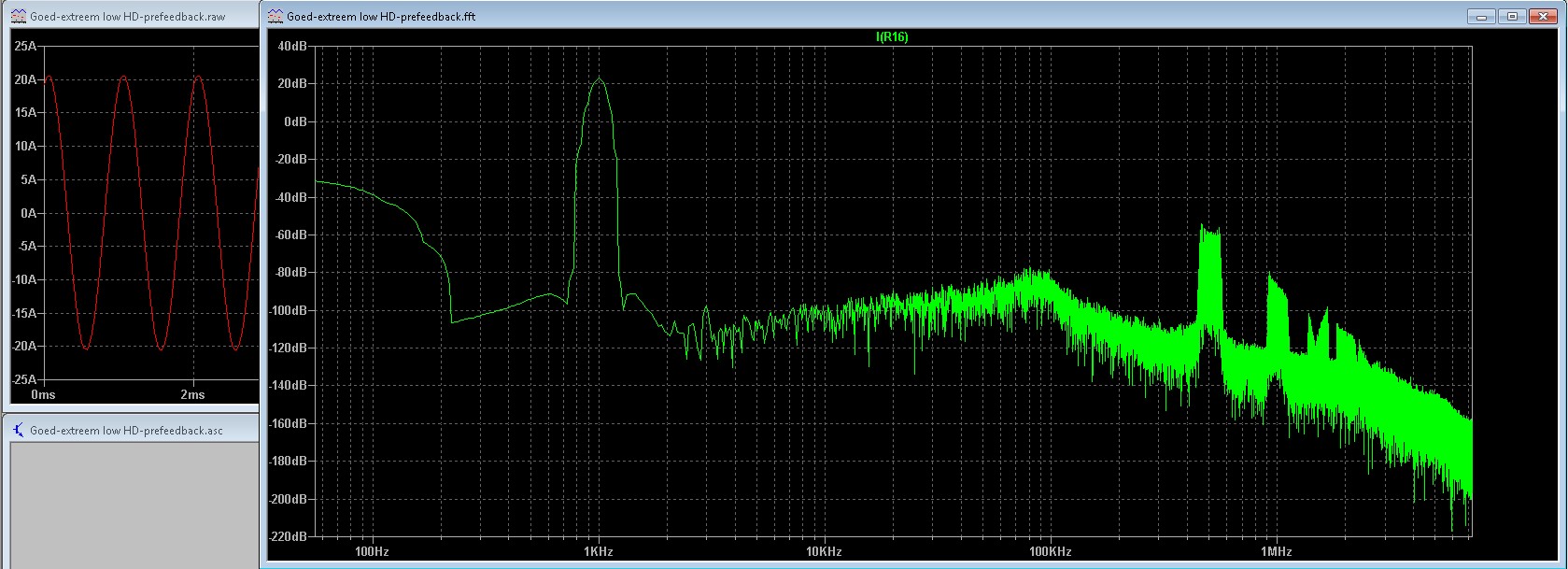

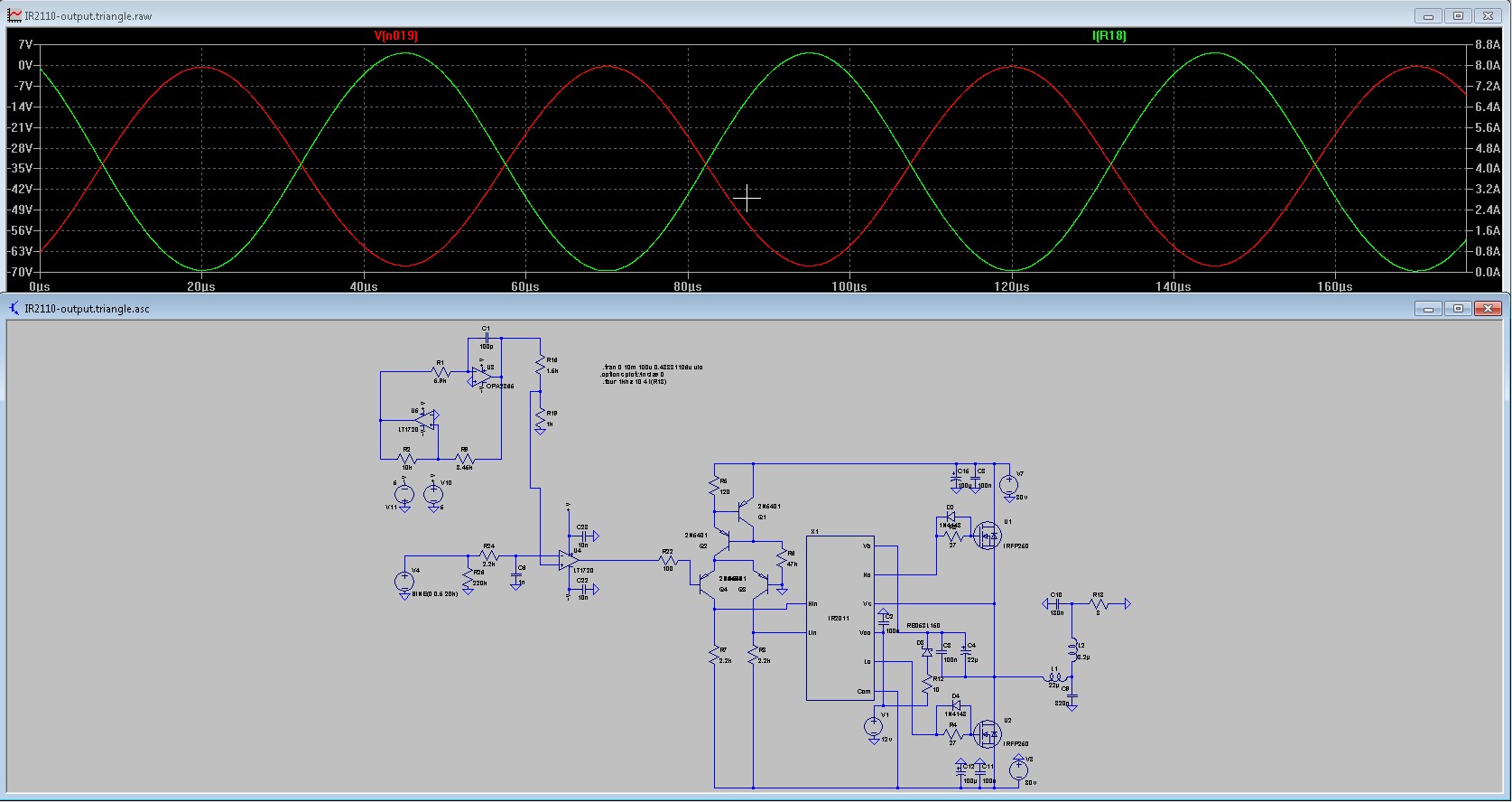

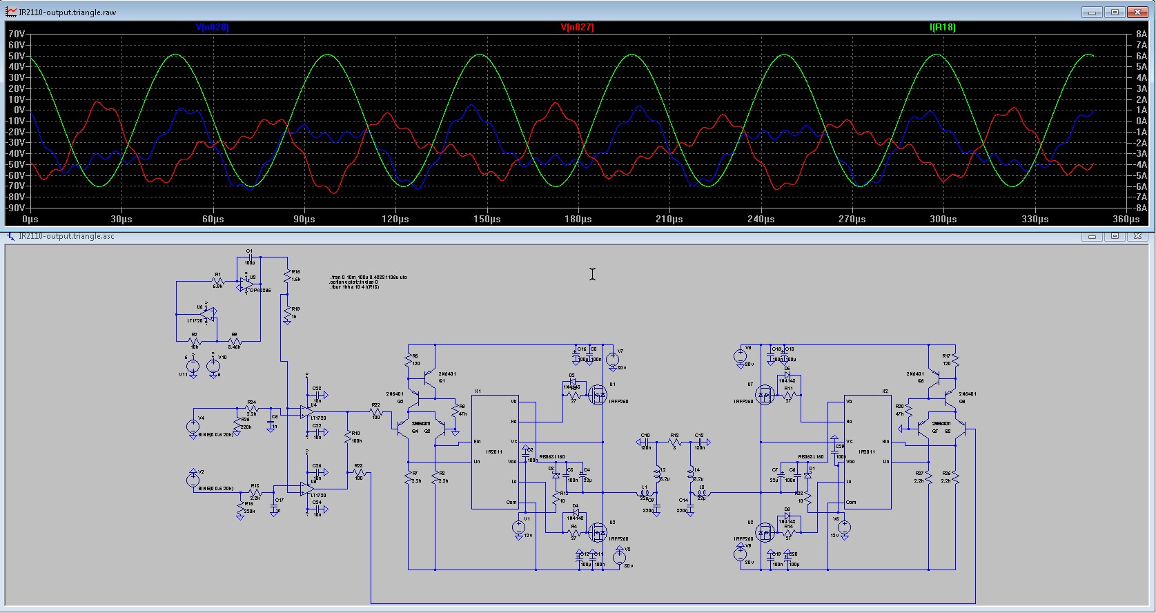

I have done this class d, it has very low distortions, but because it is a fase shifted one, in full bridge, I have the dead times done as in picture, I did see in simulation that the dead time through the mosfets do go cross each other on zero voltage, where afcouse is no shoot through, but di I have it right?, can someone explaine more from schematic, Maybe something is wrong but sim do well..
I have with post-prefeedback very low distortion on 20 amps 4 ohm output signal, the amp stays stable also with open output and full power, afcourse in simulation, not in real yet..
Thanks,
