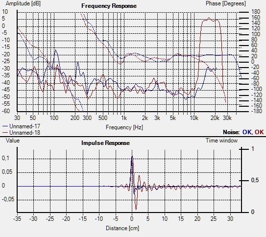

I've always wondered why my Behringer NU3000DSP class D amp sounds so flat in the treble, so I decided to measure it acoustically (noise) connected to my ribbon speakers.
I normally use it as a bass amp, where it's doing a great job.
As you can see, on the red line, there's a whole lot of noise in the treble and very poor phase behaviour. Its the same on both channels, and the amp is setup in
straight mode without the DSP in operation.
For comparison, the blue graph is from a Nad M3.
Can the problem be due to a much to low modulator frequency?
