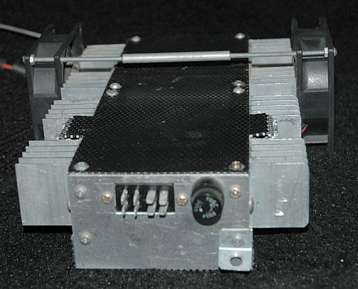

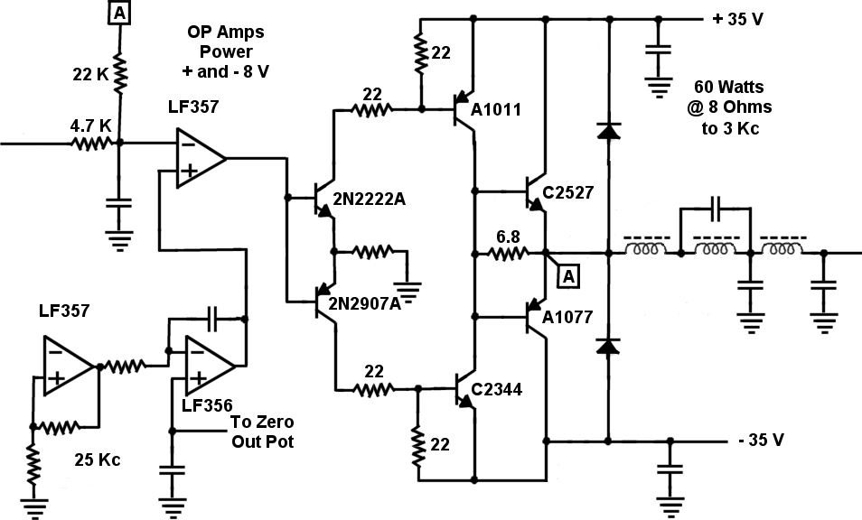

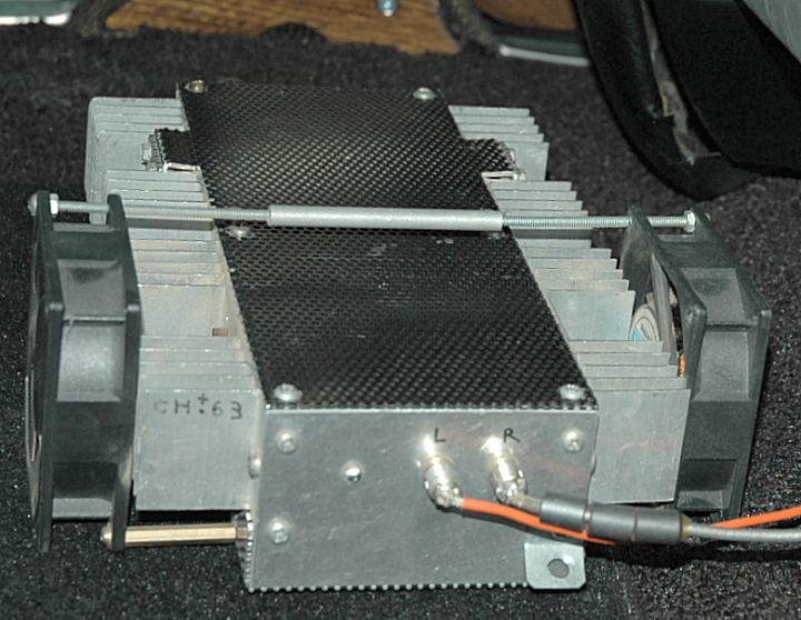

I built this thing around 20 years ago. It still works. I just thought maybe somebody would be interested in an Old School design. FETs at the time I couldn't get to work right, so all is bipolar transistors and J-Fet Op Amps. Power supply does have 2 of those TO-3 BUZ things driven by a transformer. It is for Bass at cutoff of 500 Cy, but is actually good to 3 Kc. 60 watts a channel. It is unstable without a load. I use it to drive a pair of Eminence 18 inch woofers in my 57 Chevy. Also posted this in the photo gallery.
