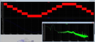

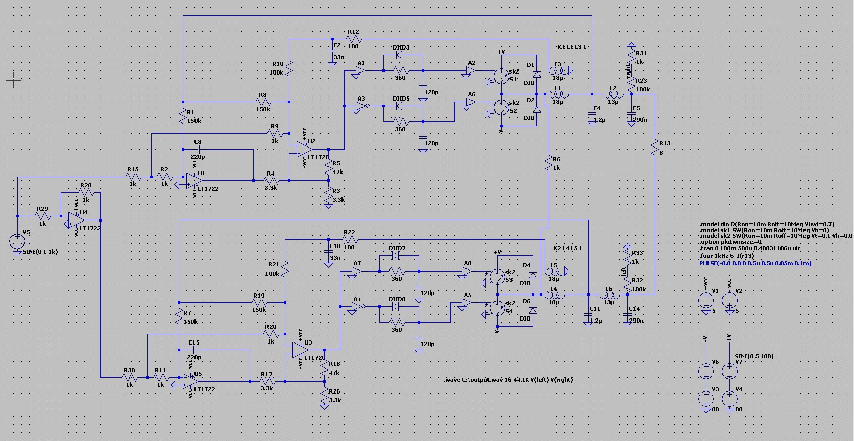

After reading post on Class D or digital amp, my point is that people are building them because of the ease of it... what I don't like about it is that there's always remaining noise. Just like digital picture, the very black or the absence of noise is very hard to obtain. A brief look at Douglas Self's amp notes and his very clear description of stage amp explanation is quite amazing. I builted his load invariant amp and it worked so well that I kept away from Class D amplifier. Self gives nice trials of Class A, B and his Class XD that I might built very soon!
Make a class D is not easy and that is not true class D has noise. The truth all amp has noise even very small. So does class D. Douglas Self precise at that time he wrote. Now a lot of improvement in class D and the most contribution from better mosfets available also chips and discrete parts.
Using multiplevel do help, I did test a three level then the switching frequency is multiplyed x 2, and noise is very low..
Not yet build in real live, I am now to busy with the analog amp.
The example pic is only prepost feedback but have also post feedback with both.
regards

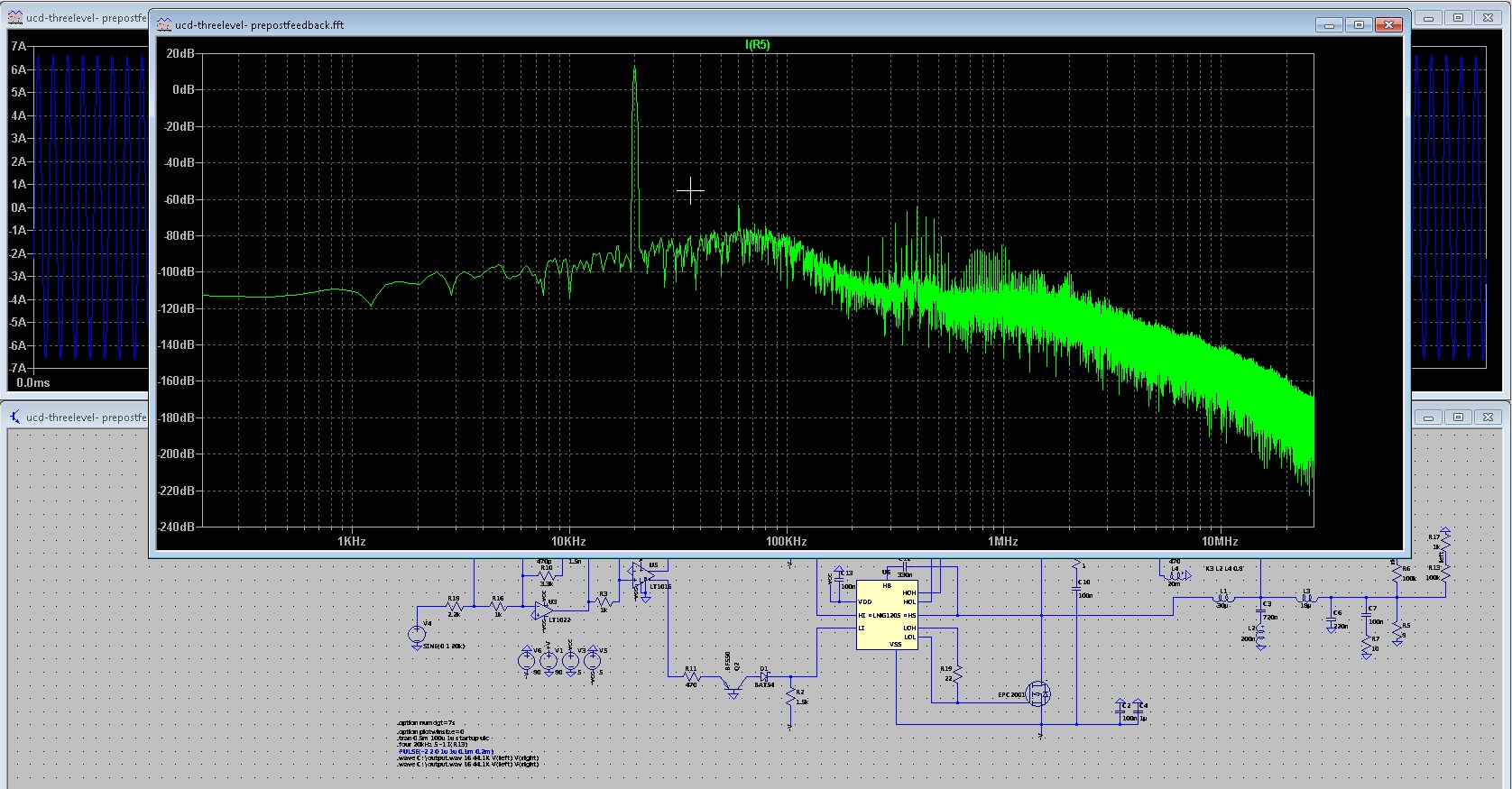

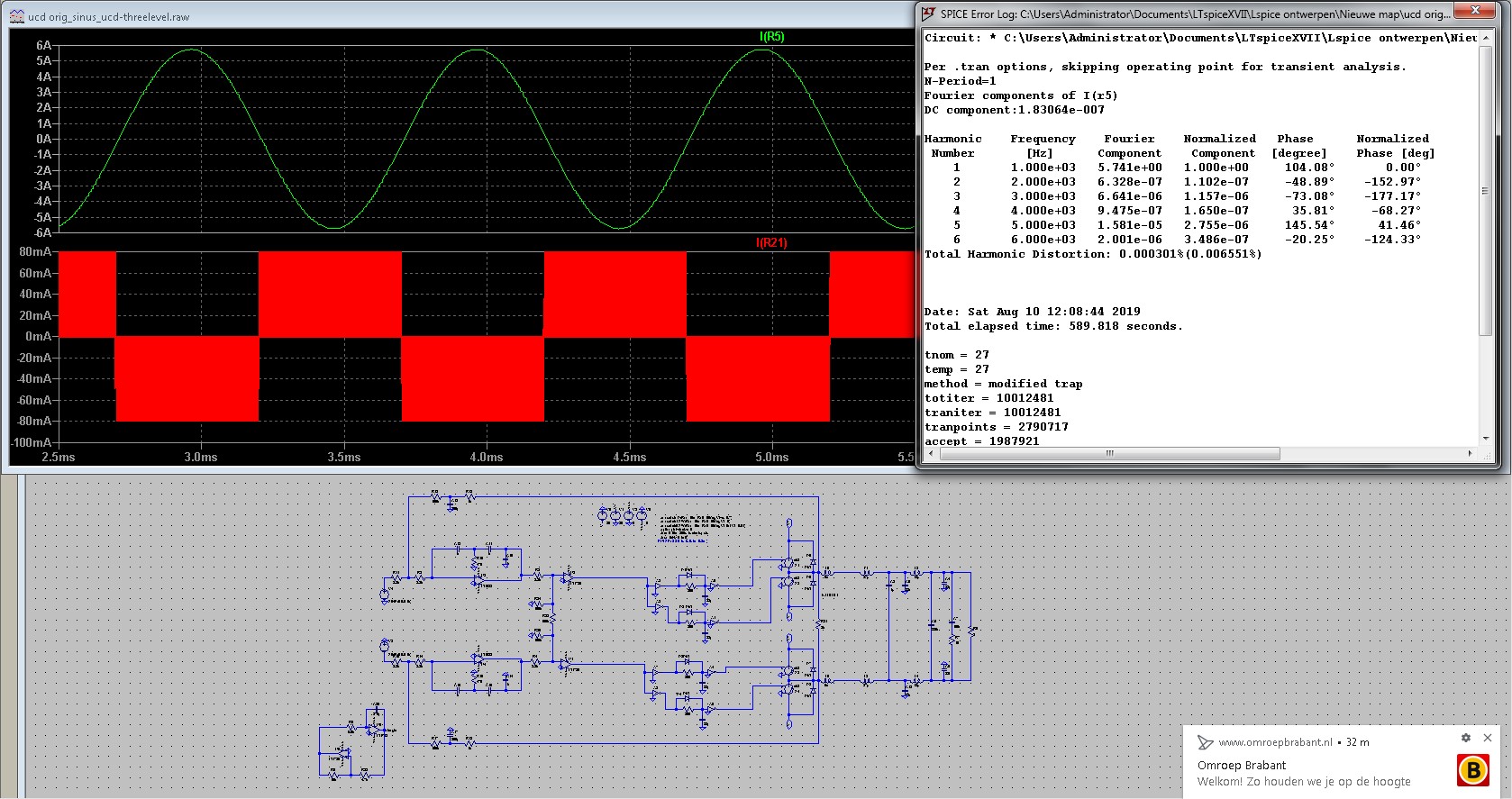

Or use this a multilevel class D. It goes in this case to 1.4 Mhz.
Only small lowpass then or even not, just use the coil speaker or filters.
Or using a aircoil because it is small, never trouble with non lineair behavior
and can use prepost feedback.
